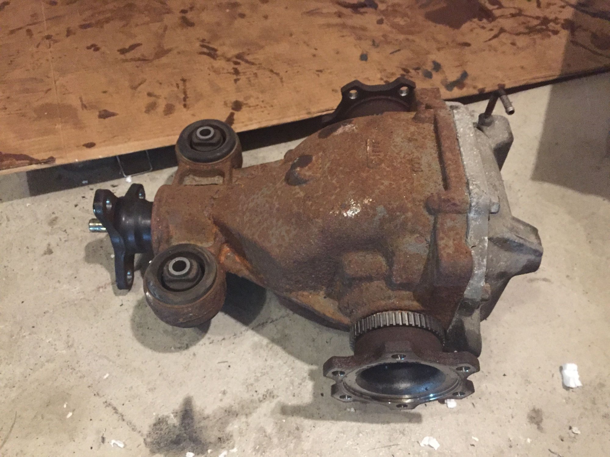

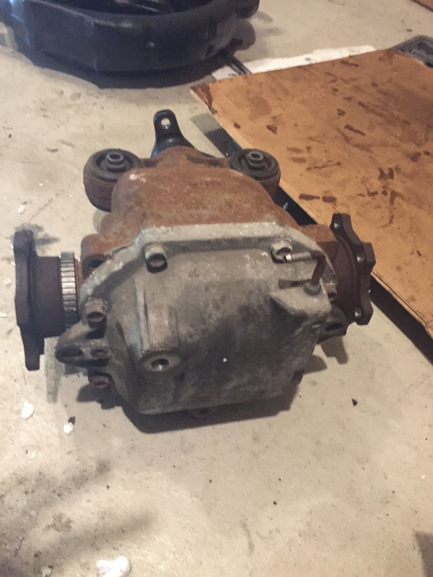

old diff
old diff

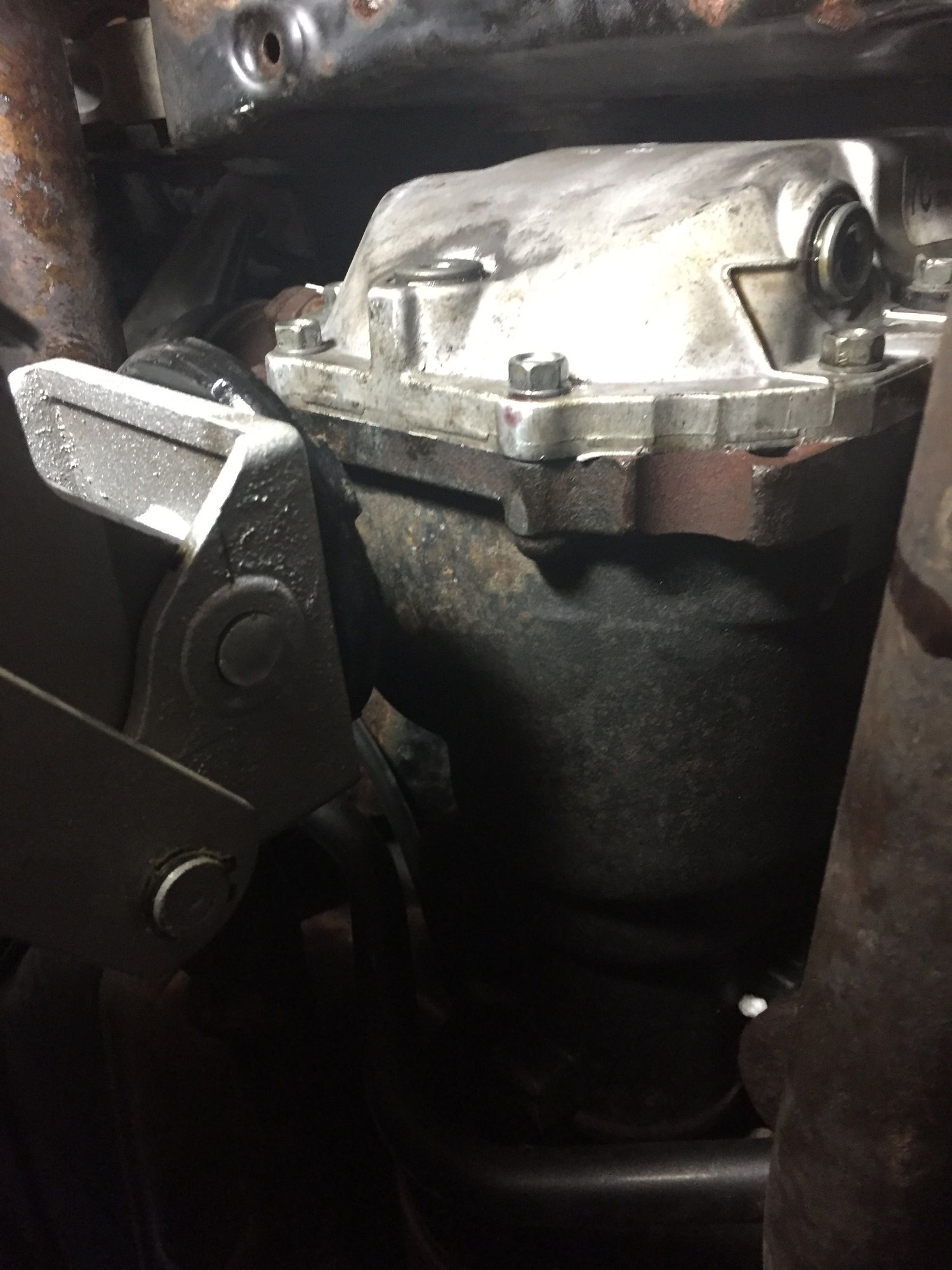

lsd in place
lsd in place
