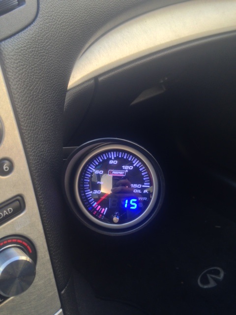

Do you have an oil pressure gauge? It's a smart thing to have. The oil pressure should dip before it goes down completely if the gaskets are failing. I also experienced random shut offs during cold starts, I just chalked it up to dirty throttle bodies. The shut offs disappeared after the gaskets were replaced without cleaning the tb's.
An oil pressure gauge really is a good idea
I do added it over the summer, when some of these where popping up.
Attached Thumbnails P0021 / P0524 Code Course of Action - Suggestions-oil-pressure-guage-jdm.jpg
