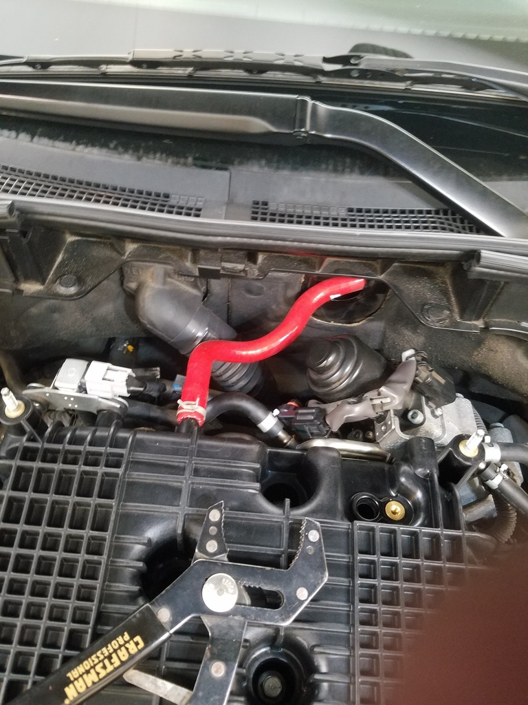

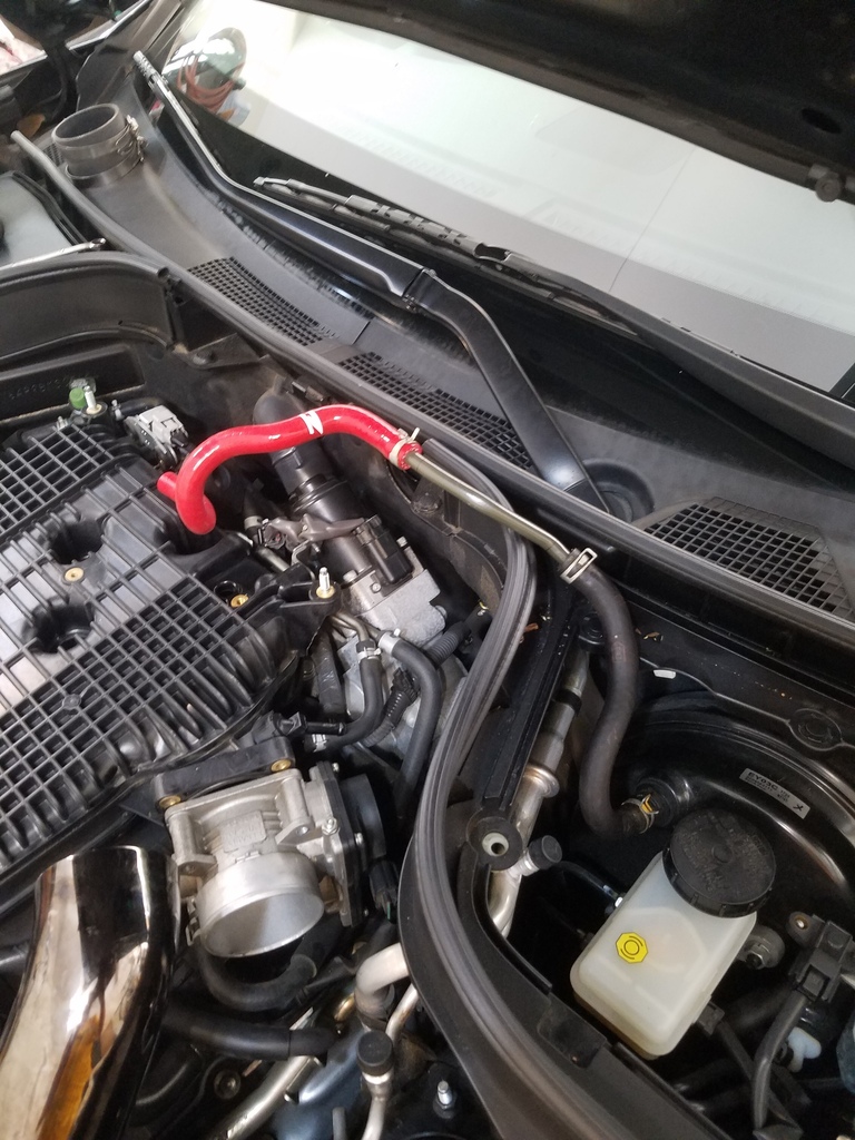

added my purdy red brake booster hose and installed my strut bar during/afterwards...

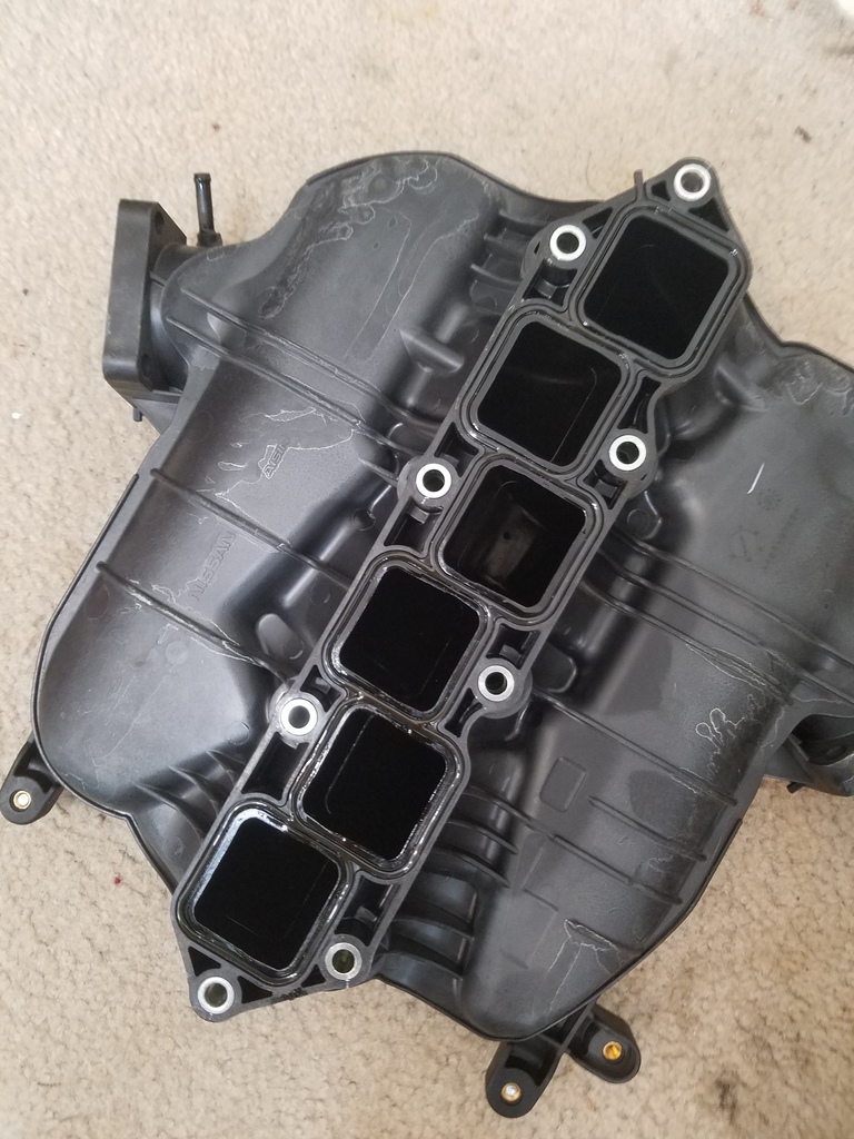

stock

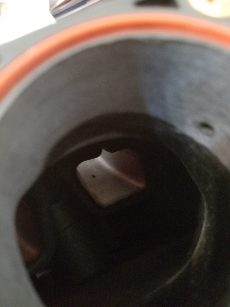

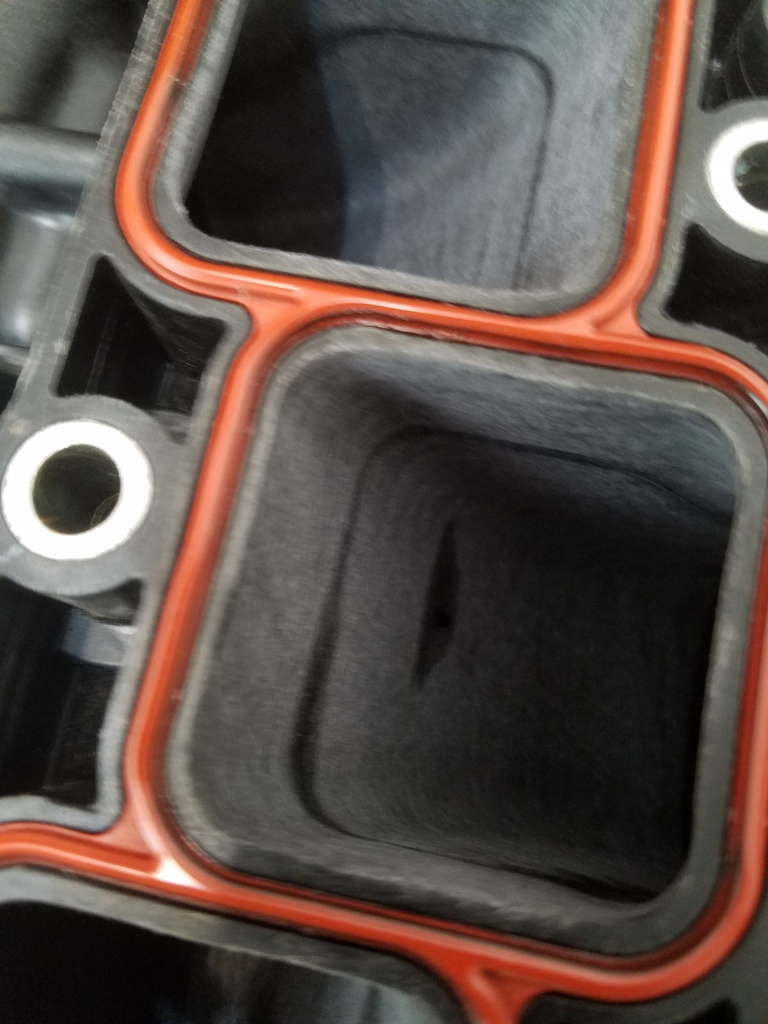

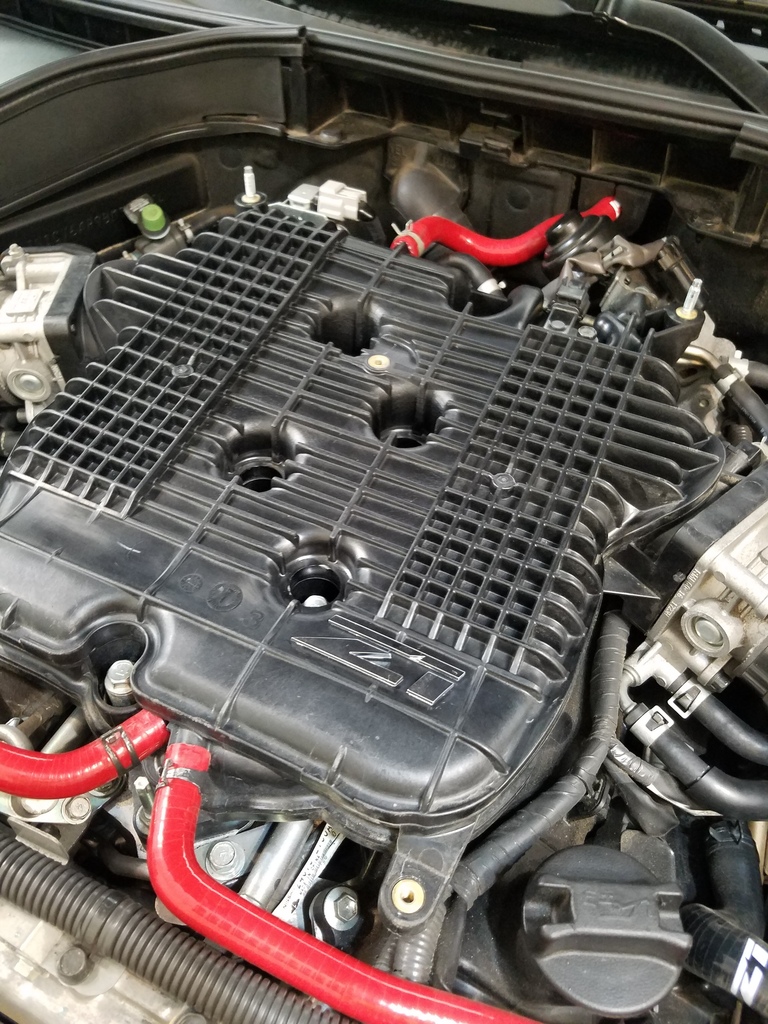

z1

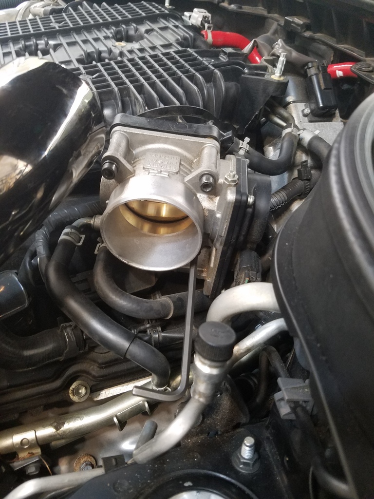

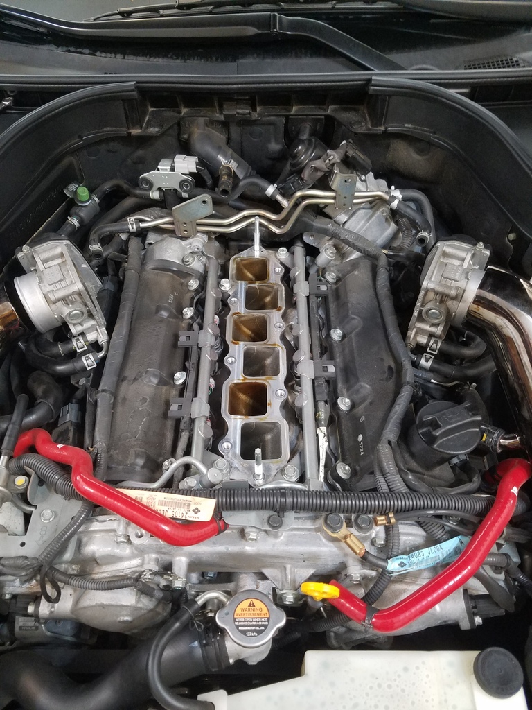

i took off the intakes and it was much easier to get to the tb bolts..
this hose is pain if you do not install if from the engine compartment to the brake area.... you connect the hard tube to the new hose then clamp the factory hose in the brake area to the hard pipe..

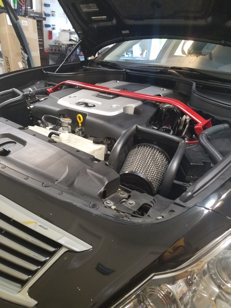

here is a picture of my so so stylish red strut bar... i know yous are all jealous...
amazon/ebay special... just painted

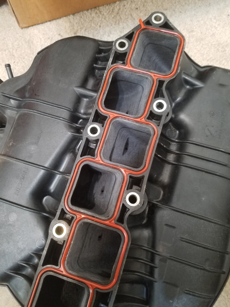

did you feel how rough the porting was, looks rougher then stock. it it polished smooth?
are my eyes deceiving me?
I did. It is baby bottom smooth. It just looks rough.
Been driving the car for a bit now with this on. Seems like a little was lost on the low end around town, but it makes up for it once you put your foot down to change lanes..
Rough ports aren't a bad thing.
