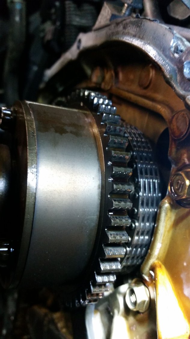

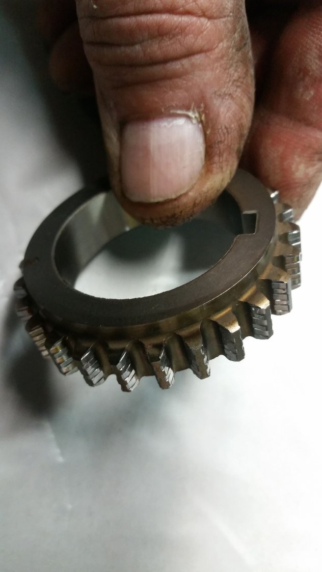

So for anyone that cares, the rattle continued until my car threw codes for low oil pressure. It ended up having blown one of the rear timing gaskets.
What was also discovered during the repair is that the cam and especially crank gears took a hell of a beating. Maybe the timing chain stretched and was causing rattling, maybe because of the low oil pressure...who knows.
The rattle is now gone, the gaskets were repaired, and new timing chain and crank sprocket were installed.
