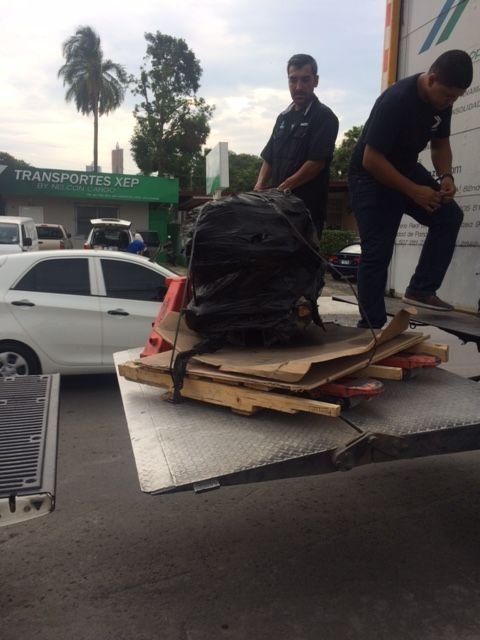

the engine arrived to Panama, 2013 with 10k miles, I show you some pictures of the exit truck parking, mounted on the crane.
then I say progress
