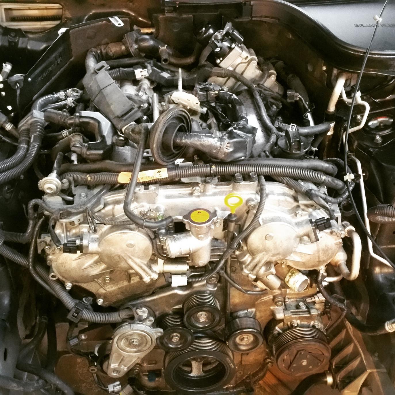

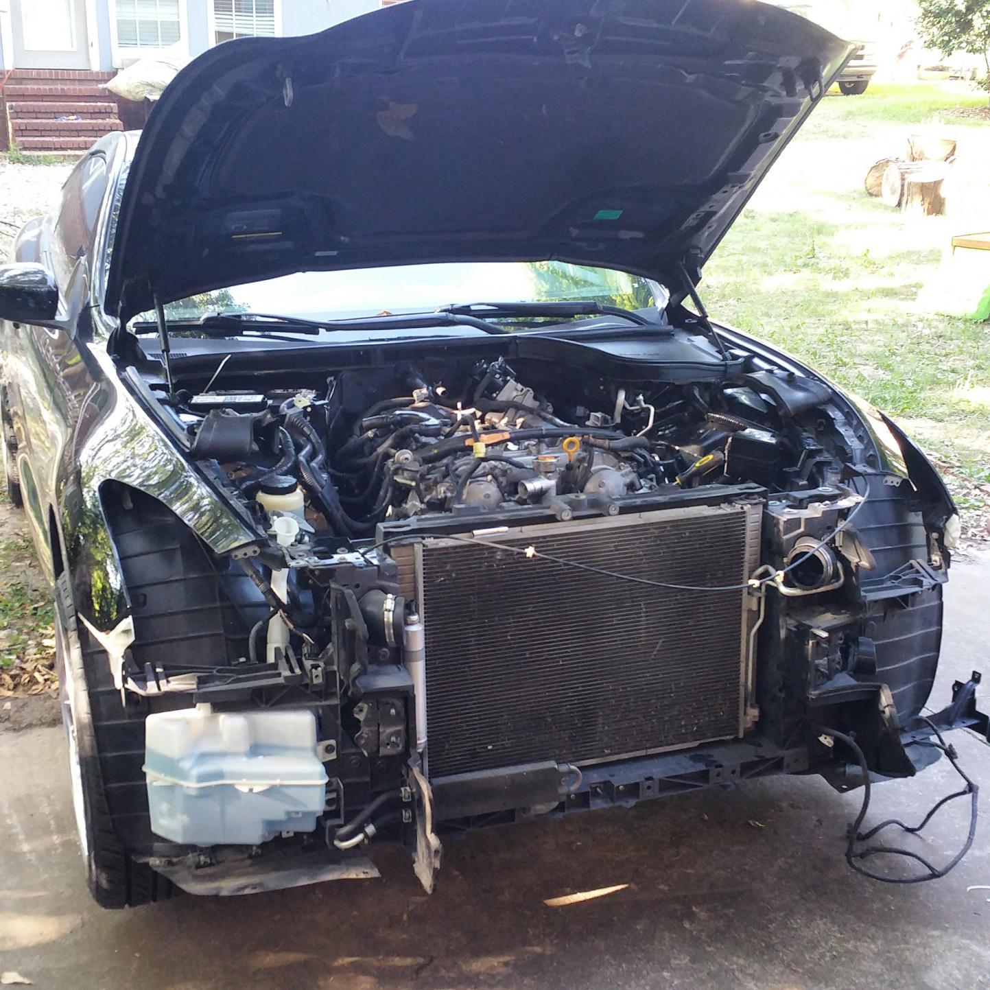

So we went ahead and started removing everything,
Disconnected battery,
removed intake manifold and tubing
removed bumper,
removed wheels
disconnected AC lines
core support,
disconnected harness from the ECU & pulled it out.
battery,
Steering pump,
Alternator,
All we have left is:
Disconnect shifter assembly
Disconnect connections to the tranny
Loosen catylic converters
Remove mount bolts.
Btw does anyone know a good bolt to use to pick the engine up with hoist?
Attached Thumbnails Engine removal help-img_20150522_181819.jpg   Engine removal help-img_20150522_201127.jpg   Engine removal help-img_20150522_210922.jpg
