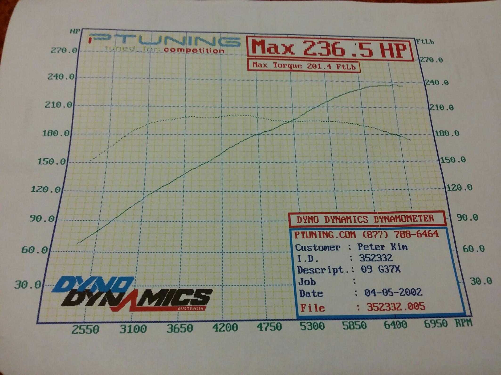

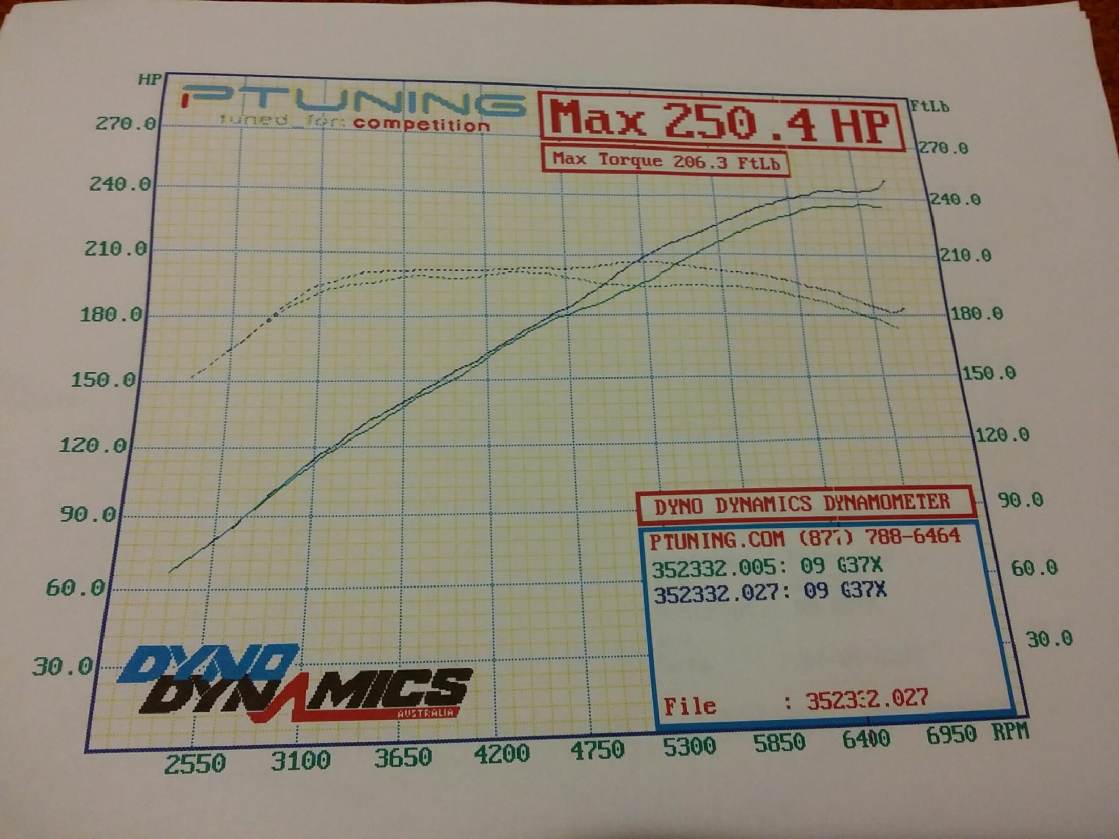

So I got my car upreved and Im a little disappointed by the results unless Im misunderstanding something.
Heres the background. I have a 2009 G37X AWD Sedan. The only performance mods I have are R2C intakes and a cat back exhaust. I took it to PTuning in Virginia cause they had an AWD dyno.
Anyways the peak HP with the stock tune with mods was 236 and after the uprev was 250. Does this sound right? The tuner said that the dyno is not gonna get an accurate reading cause of the AWD kicking in, but isnt that why they have an AWD dyno? I was expecting something around 270-280 at least...
What would a 250hp equate to in crank HP?

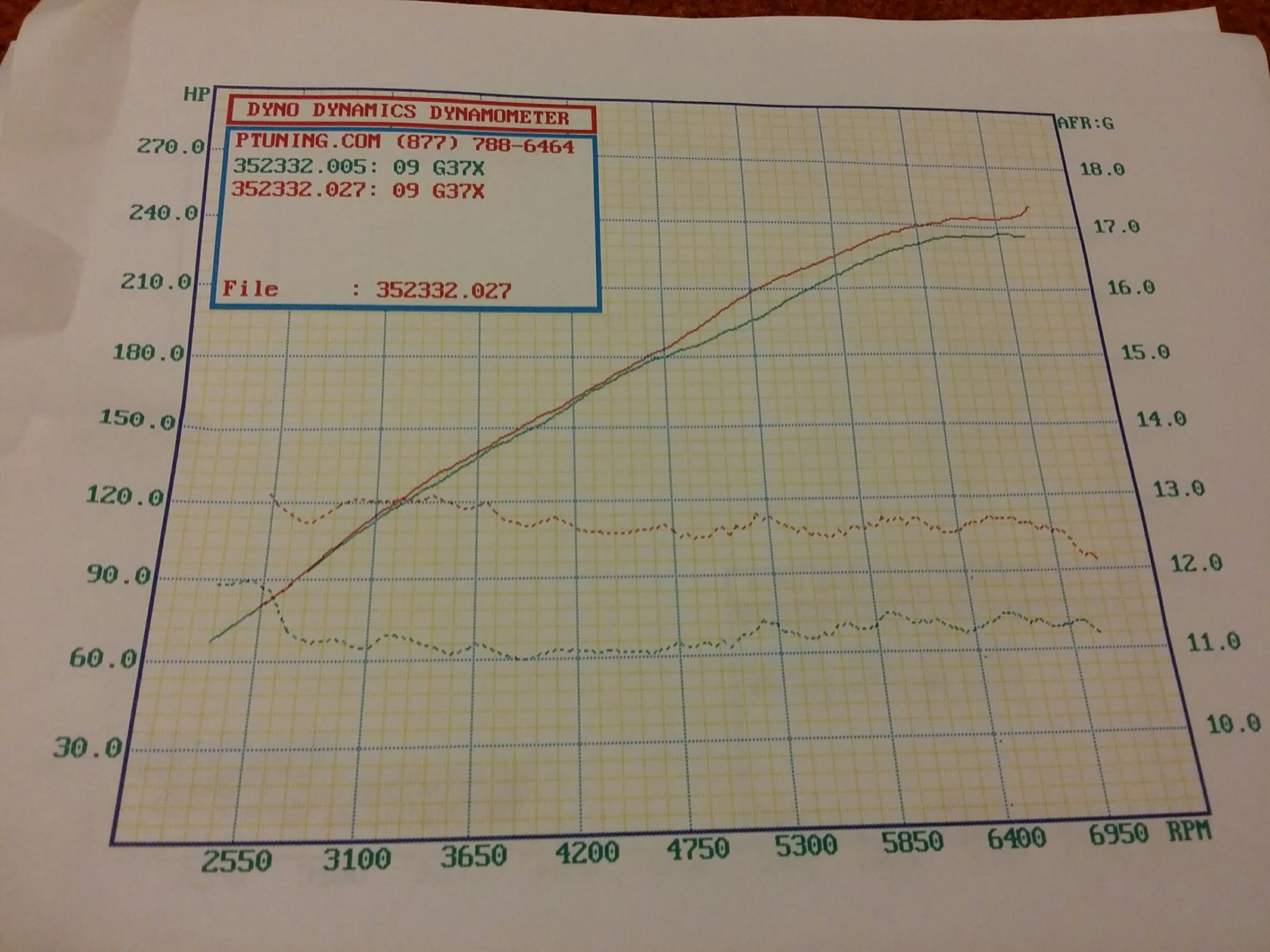

Does the A/F look ok?

That is lower than it should be. Its probably the dyno or setting in the software. I have a 09 X with CAI, cat, and catback. My peak was 278 on mustang dyno.
The APR looks likes its in the right region.

Numbers are low buts it's the calibration they have on their machine , ( wrong)
I wouldn't worry about it . You saw a gain of 14 WHP from te tune that's all that's matters.
What gear did they use also should be done in 4th. I also have a AWD sedan haven't dyno'd it yet my my NA AWD coupe made 298 WHP

as others have said, its the gains that matter. the dyno numbers dont mean anything other than to compare the before and after, especially if they cant get an accurate reading. if the car feels better and sounds better I think you have accomplished your mission
14whp gains are about accurate from a tune. I got tuned with full bolt ons and the tune itself gave me 16whp. also, high flow cats and/or test pipes are big gain adders because they are the most restrictive part of the exhaust system. I used to have injen short ram intakes and when I switched to the stillen gen 3s I didn't see much of a gain, 2-3hp if I recall. then i switched from my prior HFC to ART pipes and my exhaust to the motordyne e370. previous hfc/catback was 2.25" all the way through. new set up is 2.5" most of the way through and the back end of the e370 is 2.75" (inner diamaters, btw) and then got a retune to fully accomodate the new intakes, test pipes and cbe. my dyno run was almost an exact overlay of my original set up.

You can't compare bottom line results of one dyno/car to another. What you need to pay attention to are the gains for your car on that specific dyno on that specific day. That being said, I think you should net higher numbers than what you did.
