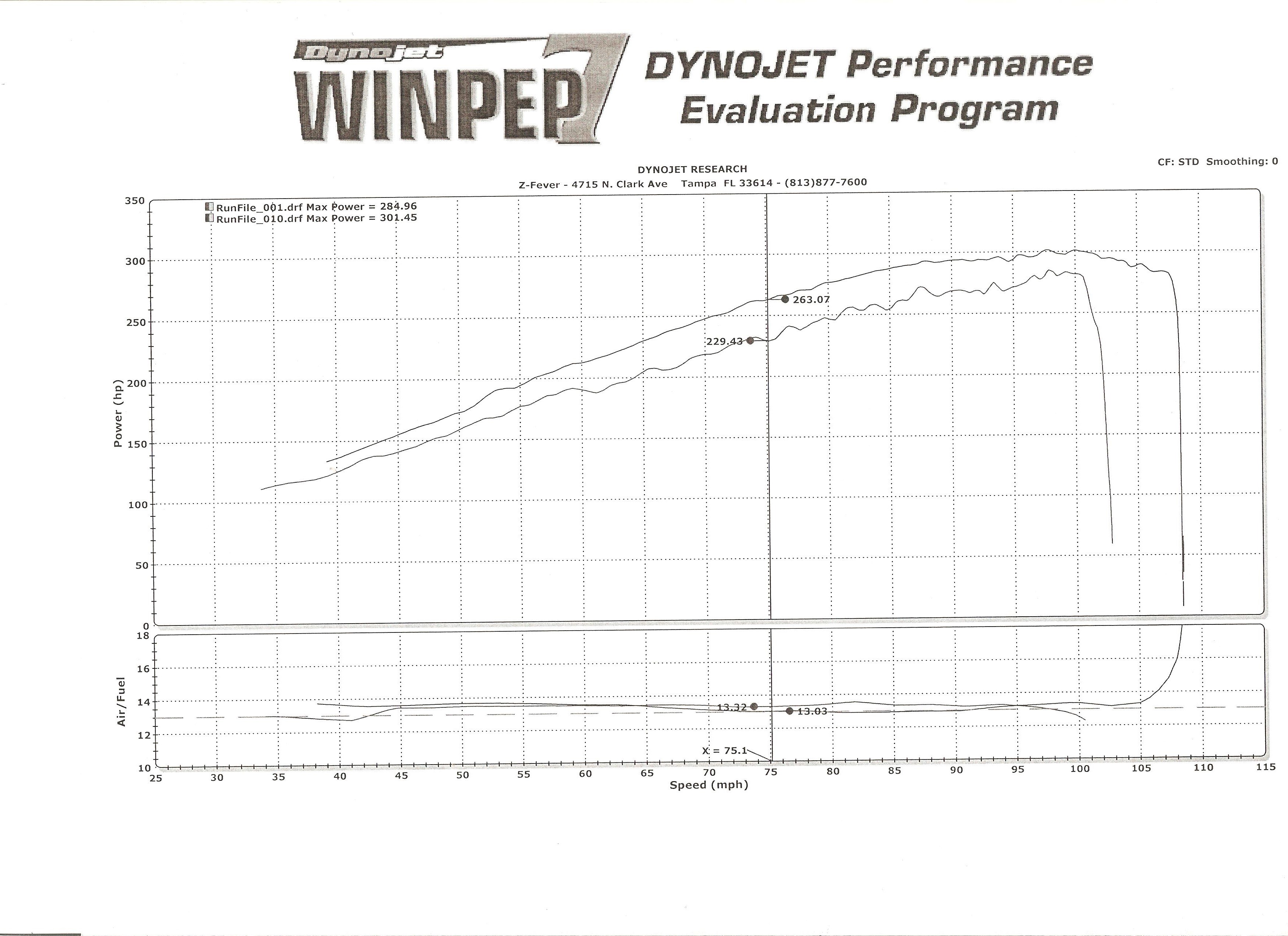

I have my rev limit up to 8k. here is the dyno. you sustain more top end power but its relatively flat and slightly decreasing after 7500
Intakes/HFC/catback
Intakes/HFC/catback
Those are some nice numbers
Thats pretty much what mine looks like but the Mustang dyno I ran on gave me 285 max HP w/ 226 max TQ. The TQ curve was pretty flat and I can feel the difference throughout the gears as a steady pulling that doesn't let up. This made me a happy man.
