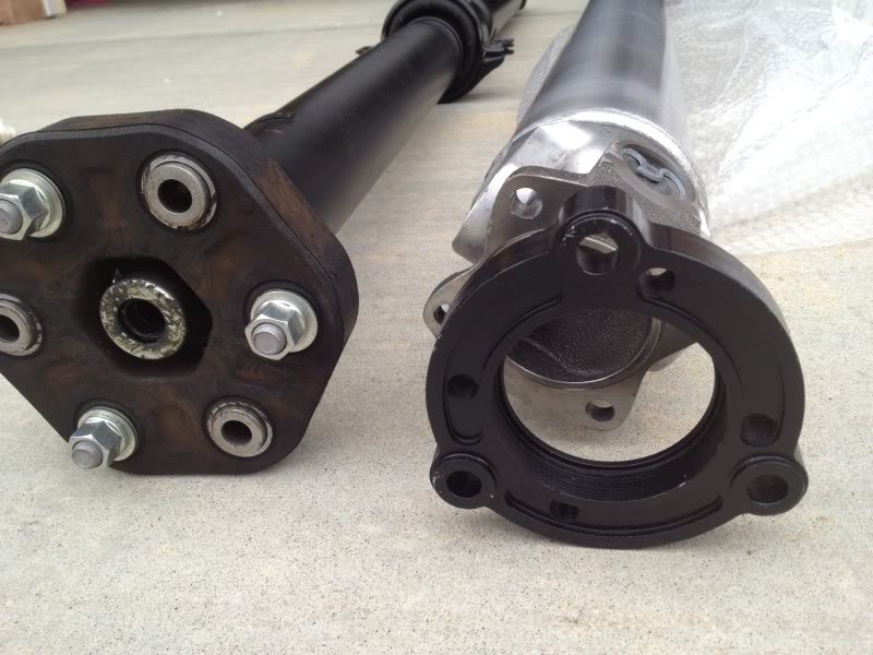

It's going back! It's 1.25 inches longer than the OEM driveshaft. It's 9 lbs lighter.

Does the alum driveshaft have a universal joint at the rear? If so, you DON'T need to use the rubber coupling (Adapter plate?). Bolt it up directly to the flange. You may need shorter bolts.
Then the shaft would be 'shorter' by almost an inch.

It has an adapter plate that is required for installation. It's too long. Installation would be impossible. It has to go back.

Can you take a pic of the rear part??

Sorry for lagging on the pic of the adaptor. I sent the driveshaft back for it to be re-sized. It's been installed now for several weeks and all is good. This was a nice upgrade.
