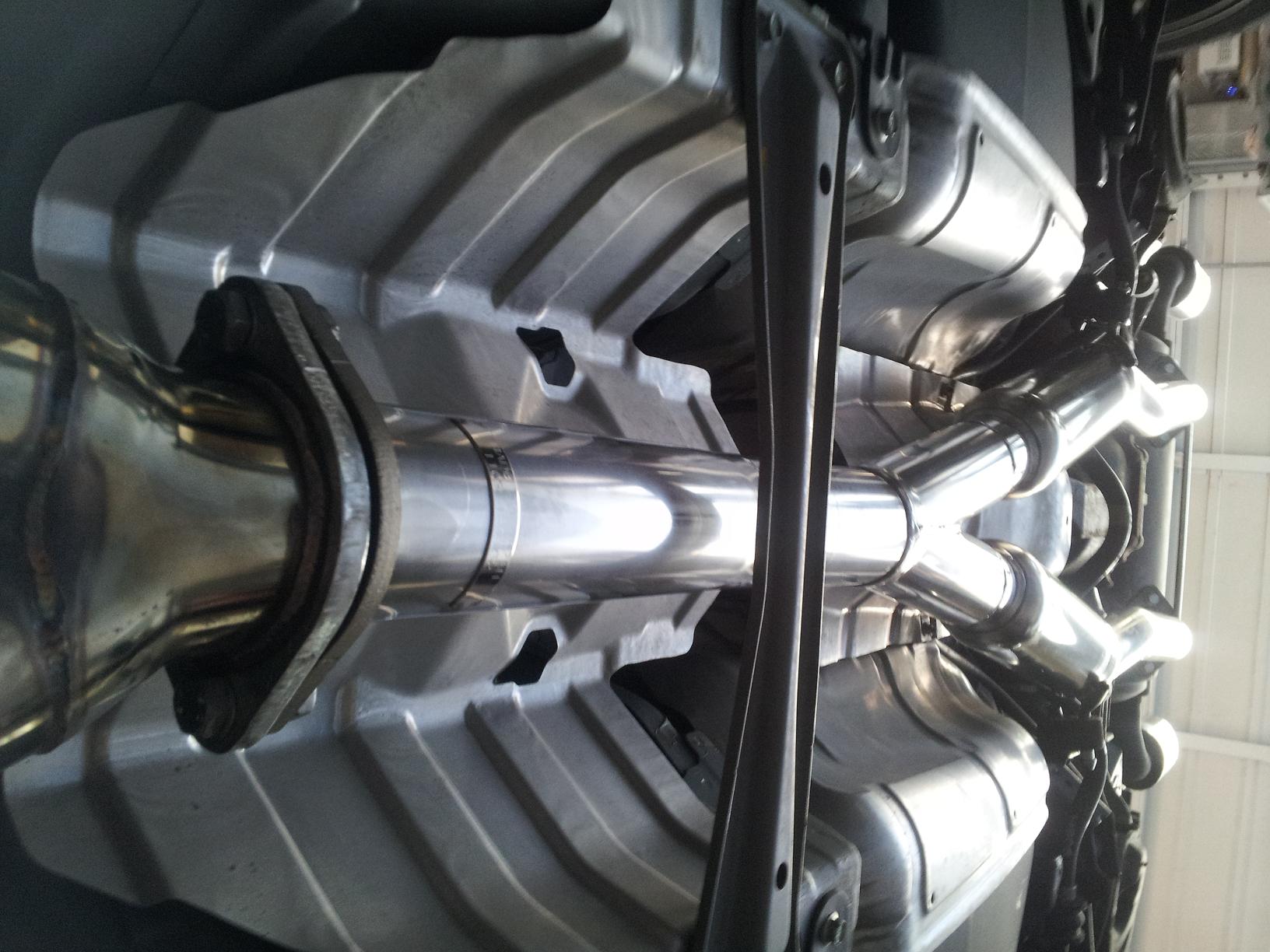

Here is the install of the tanabe mid pipe it went in perfectly about 1 hour install.
So you cut it and modified it?
Old May 19, 2012 | 10:42 AM
timp's Avatar
timp
Posts: 142
From: Vancouver, BC Canada
The tanabe mid pipe will fit stock or aftermarket Y pipe without out any modifications what so ever. I bought the Megan Racing Y pipe and Tanabe mid pipe everything bolted on no issues. I kept the rear stock muffler
