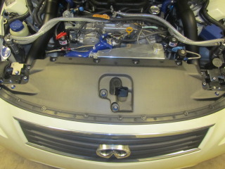

Old Apr 2, 2012 | 09:13 PM
TVPostSound's Avatar
TVPostSound
Joined: May 2010
Posts: 3,613
Likes: 117
From: Granada Hills, CA
Passenger side cam sensor can be seen just to the right of the thing with the red top says NX??
