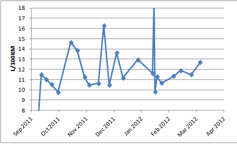

Fuel consumption hasn't changed absent cause (spikes and increases are explained by small fills, city driving, aggressive driving).

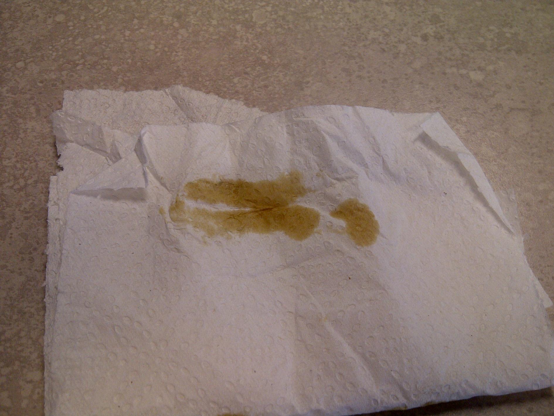

Oil level was good, attached is a picture of the colour on cheap paper towel.
Oil type: not esther. Not sure what my local dealer uses.
