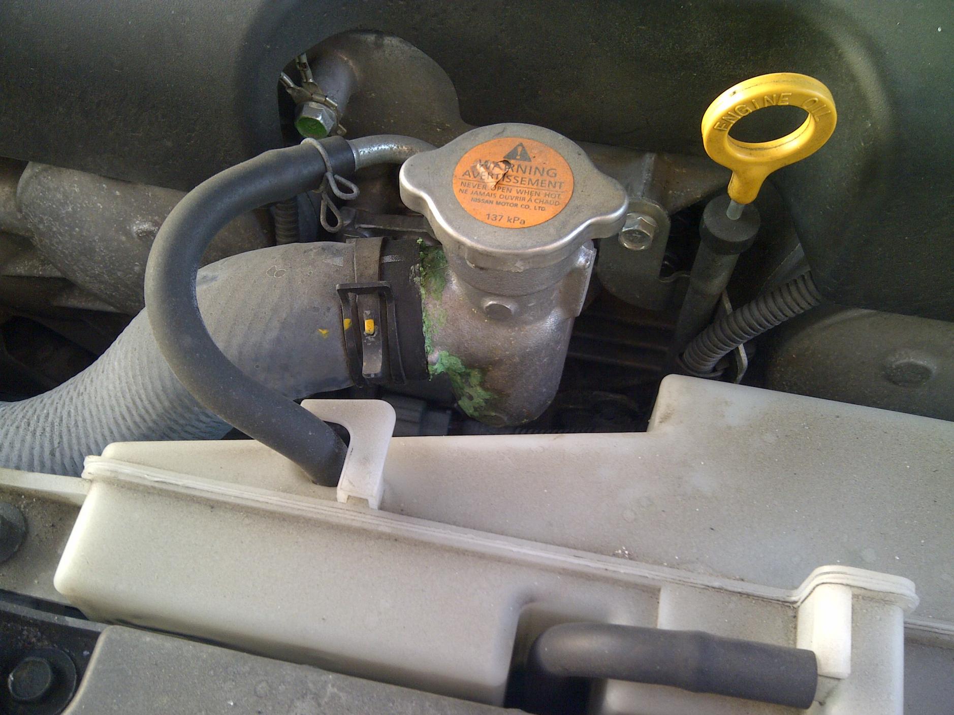

Was looking under the hood and saw this!
Is the green stuff around there normal, or is it a small leak? Help please :|
Attached Thumbnails Was looking under the hood and saw this!-img-20120306-00017.jpg

No, not normal. Hose clamp not clamping tight enough. Assuming car is still under warranty, have dealer fix it.

Saw some too the other day and it is obviously a light leak, didn't really worry me much though. Not really a difficult fix, if that was the side of the block though I'd be alarmed.

Plus one for first post, Not normal. .Warrenty dealer fix, If not you can fix it not hard at all.

Get it fixed and clean your engine bay!

agreed, not normal

After reading the title of this thread, I was expecting to find a rodent's nest. OP is lucky its just a seeping hose clamp.

Had the same problem with clamp ... During oil change in dealership was charged $ 20.00 for a home depot $ 2.00 basic clamp. DIY .... Not covered under warranty. SMH

2-5 min job, Get pliers to remove hose clamp, go to an auto part store and buy a manual adjusting hose clamp for like 2 bucks and put it on... Dont have to waste time going to dealer.
