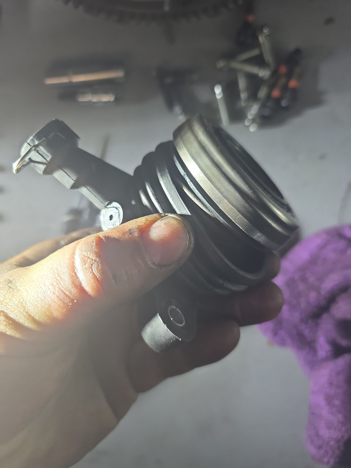

You have to use the bortom wrench to keep the shift linkage from bending and hold the shifter assembly as you spin the head. Took me 20 healthy turns.

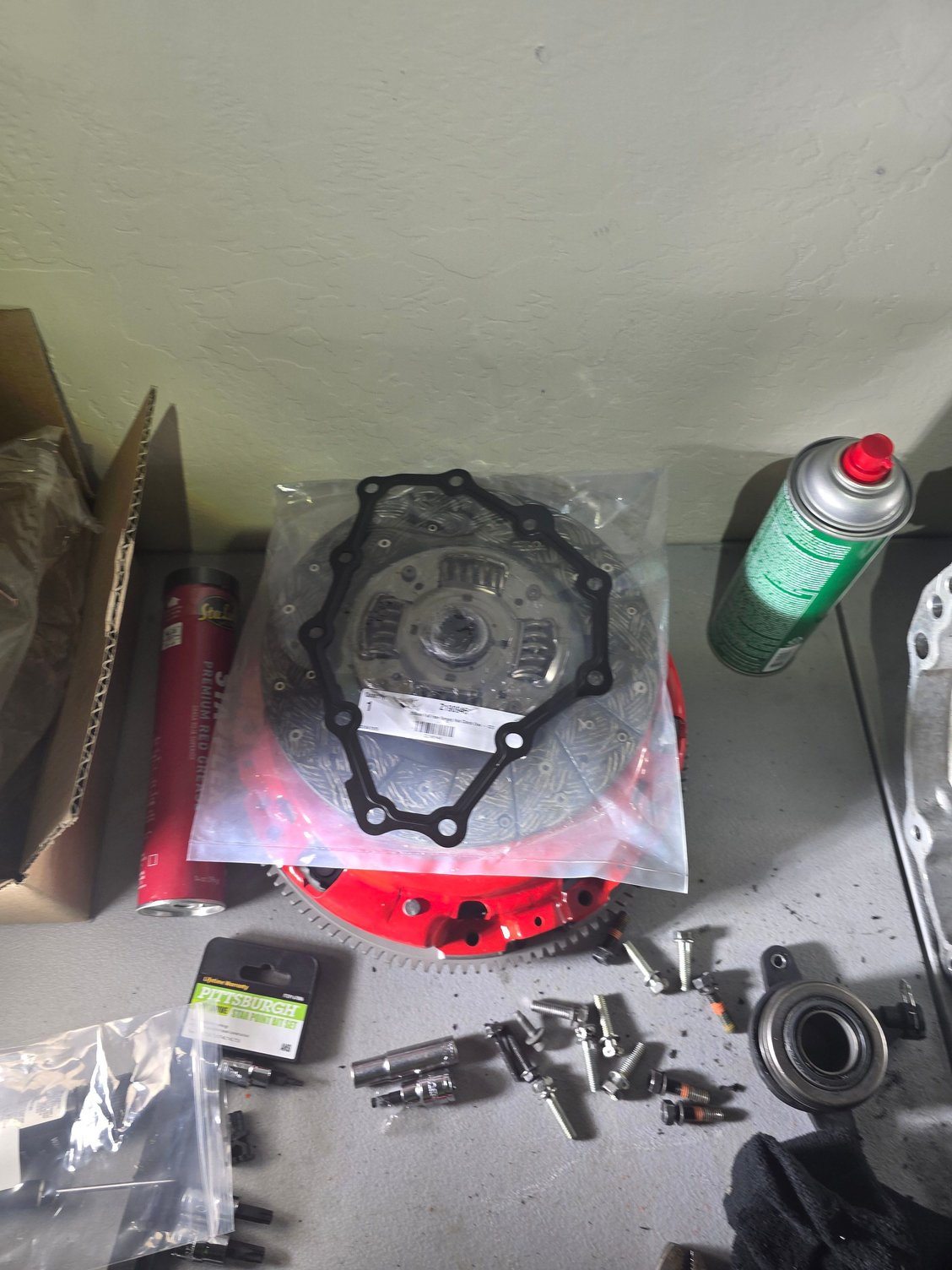

Z1 csc delete easy install
Drag pack clurch kir z1

Suprinsigly the oem csc has some metal components

The 4th oem csc ive changed in less the 15k miles
