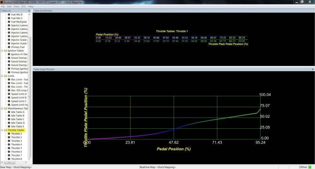

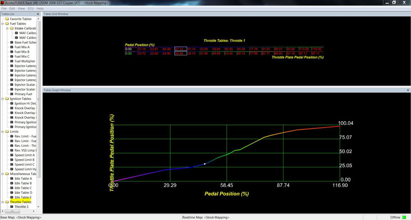

Better way to do it is get a tune AND throttle tables adjust however you want. Get more HP, Torque and FEEL it...lol.

That's because they didn't adjust your throttle tables most likely. Obviously Cobb has that ability, I'd imagine so does Uprev.. they just have to do it and most won't touch them by default. This device and Throttle table adjustment are the same. The ability to swap different settings though is nice buy could be mimiced with different maps.

From the site:
This modified signal forces the throttle body to open 'more' than the stock signal at a given pedal position. In effect, the idle-to-full-throttle pedal travel is reduced. This makes your car 'feel' more powerful because a given pedal input produces greater throttle opening. This is especially evident in the low to mid rpm range where most cars spend their time on the street.
I stand corrected.. editiing the thottle body position relative to the pedal position by the throttle tables in no way accomplishes the same thing
