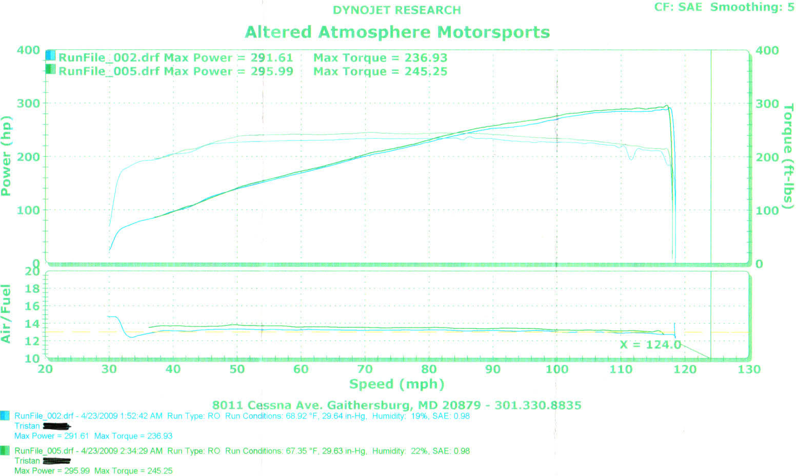

You probably would have gotten a little more out of the stage 2 if you had mufflers. Stock muffler is pretty restrictive compared to aftermarket.
Good numbers nonetheless. About the custom tune through AAM, I wouldn't. You may receive more gains, but it's an ECU flash that you can't uninstall like Cobb.
Plus I haven't heard great things from their tuners as some people on this forum had problems and had to take it elsewhere. Not going to mention any names.
I would love to have a custom tune but I don't have any place here in MD that would do it. I hope Cobb would release the pro tuner soon. Another G37 ran the stock style map on the dyno an it came out 284hp and the stage2 ran a 286hp. I don't remember the torque numbers. His G37 is a 5AT with HFC and CAI.
