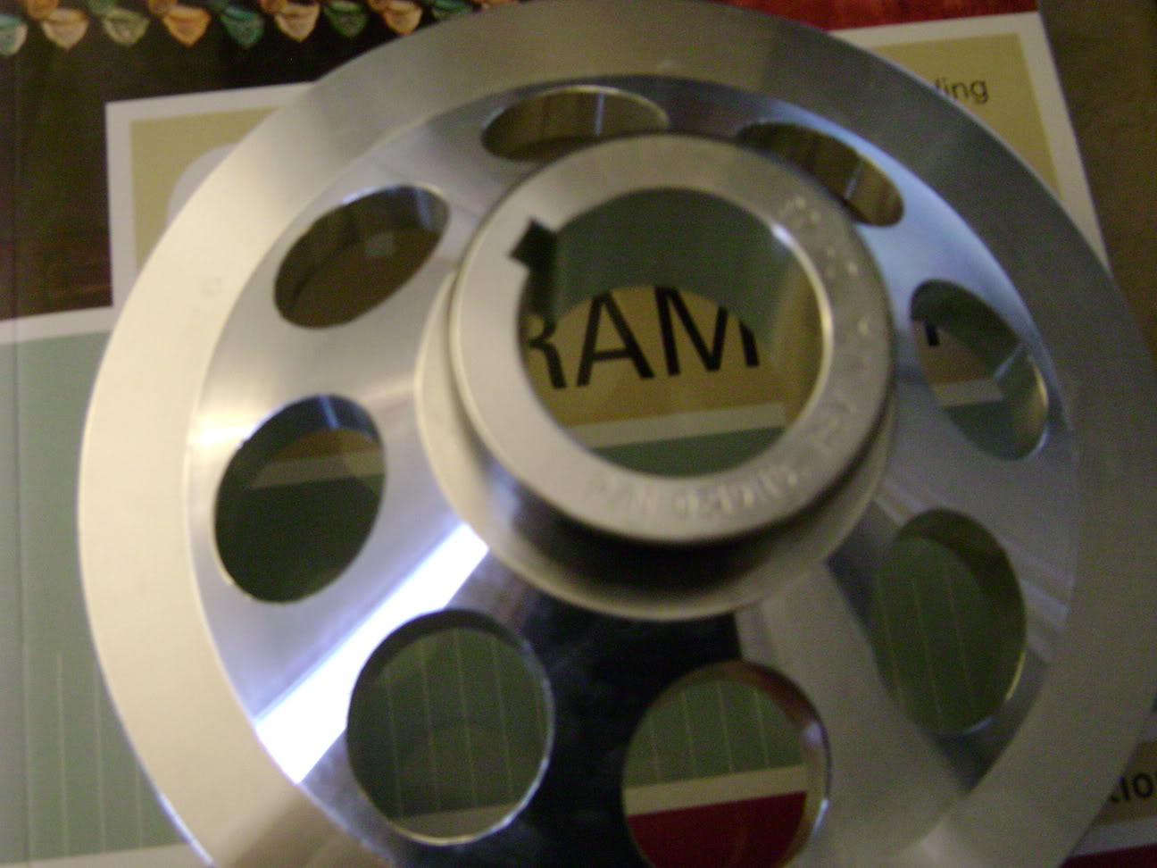

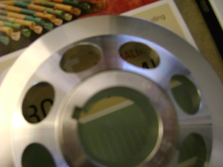

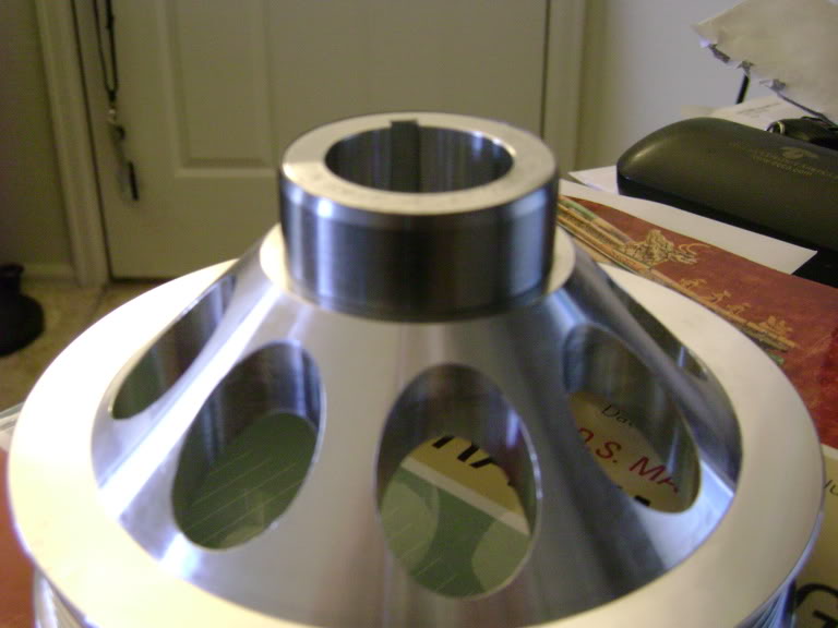

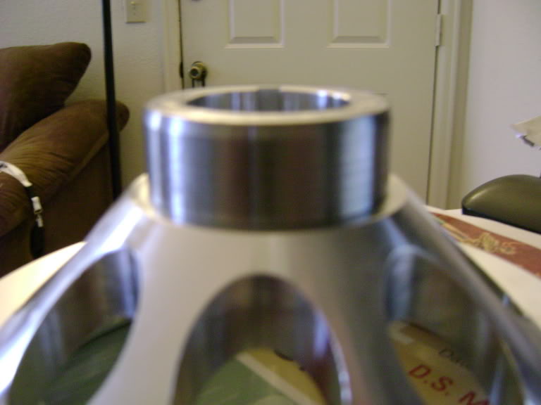

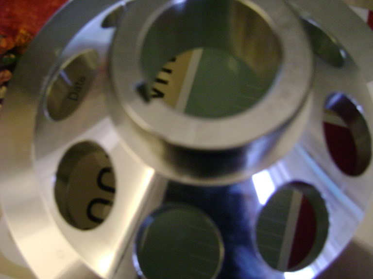

I took some pics of the UR Pulley. They are not the best but it is the best I can take with my camera:
Hope this helps. BTW the ring that is mentioned is a seal. It is hard to see in the picture though but it is that grayish/blackish piece.
