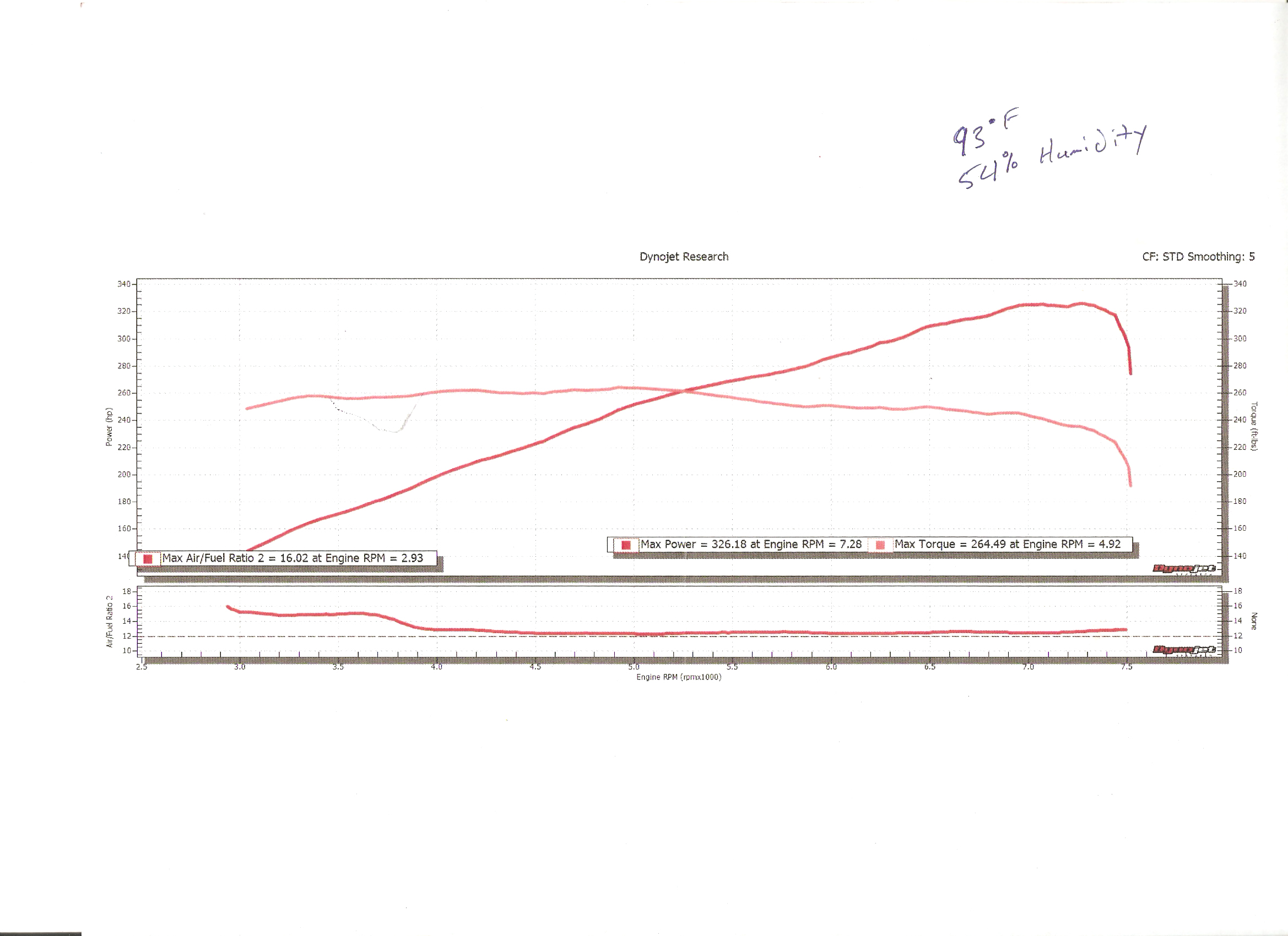

Just got my EcuTek tune on one of the few AWD Dynojets in my area. It reportedly was 93° this early afternoon when the final pull was made and 54% humidity. I got to drive the car for 10 minutes in stop and go traffic so I can't really report on it much but I'm sure I will be happy.
326 WHP
264 Torque
I'm not big on chasing numbers, but I was hoping to brake the 330whp AWD "wall" with the flex fuel tune, but I have a feeling if I go do a dyno run in the winter I will be at or a little past 330whp.
Last edited by zer099; 07-14-2016 at 10:08 AM. Reason: swapped pic of dyno for a better scan

Why the fuel rails and larger injectors? Are the stock ones maxed out at that power level and fuel pressure rate?

The injectors were close to being maxed out. If I go with cams and 72mm shaftless TBs with 3" intakes in the future I would most likely needed to upgrade if I stayed with stock injectors so I decided to do it now. I got 600cc to start with but backed down to the GT-R ones for simplicity of tuning and trying to stay with-in a close range of my end-goals. I got the rails for no reason other then I wanted to have them. 100% not needed. Did it help with anything? No clue, but it didn't hurt. Plus if I decide for whatever reason to go to a return fuel system in the future its now very easy to do.
After looking at a many other peoples dyno sheets, looking for patterns not numbers, I think I could have easily broken 330AWHP with a ported stock plenum, but I wasn't after max power as much as wanted the most I can get under the curve. When I get my front diff swapped out next month I was going to have them do a before and after dyno to see how much going from 3.3 to 3.7 effects the numbers; I might see if I can port out a stock plenum and see if I can do a run comparing them with my setup.

Do you have any before numbers?

93V, in theory you should have better MPG, but it really depends on the tune you get (read: your tuner's ability) and your driving style. I wouldn't expect the world from it however.
jfisher, thank you! Sadly I do not have a dyno of the car stock, which I presume is similar to the other AWD stock dynos I've seen so around mid 270s AWHP and mid 230s AWTQ, and it didn't occur to me to ask for the baseline dyno that was done before the real tuning started. I have to go back too my tuner to see about adjusting the line pressure in the tranny, so I will ask if they happen to have that run saved still. DOubtful, but it never hurts to ask.
