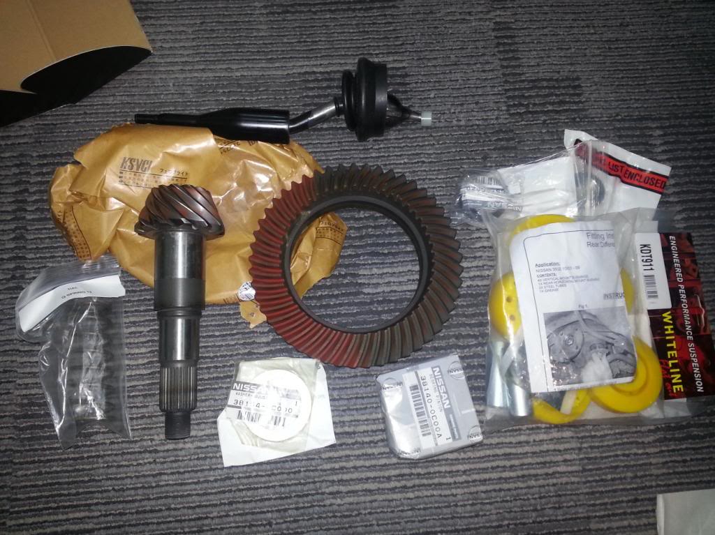

Here's a list of parts I used:
38100-0C760 : 4.083:1 Ring & pinion
38140-0C00A : Pinion Front Bearing
38120-EC000 : Pinion Rear Bearing
38189-P0117 : Oil Seal
38154-0C000 : Washer adjustment
43262-01P10 : Drive Pinion Nut Lock
38165-0C020 : Differential Spacer
I had 170,000 kms on my diff so I figured I'd replace the above parts while I had everything open.

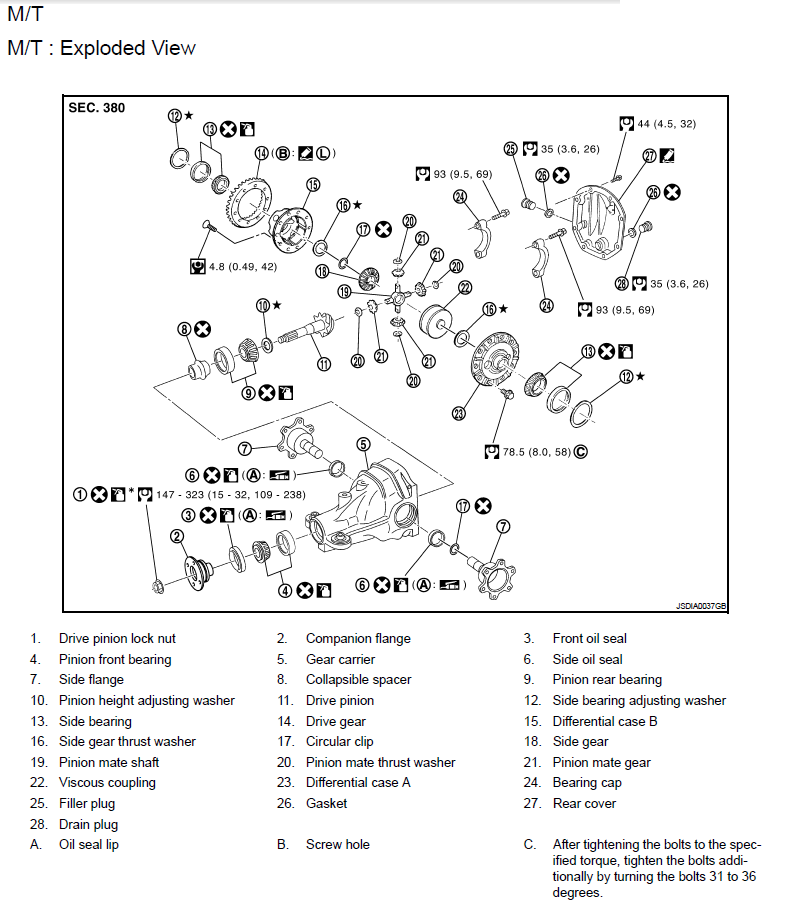

Here's an exploded view of the diff incase you're wondering what all these parts are:

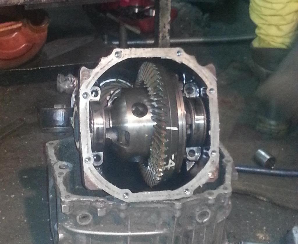

One thing's for sure, you will need an MT differential housing. I tried to use my OEM G37 A/T one and the pinion shaft wouldn't even fit in it. I then tried an A/T from a 350Z and the pinion would not touch the ring no matter how much we moved it around. The only way to pull this off is to use an M/T diff housing. I picked up an MT diff from a 370Z and used my friend's 350Z M/T LSD. Everything fit like a glove.

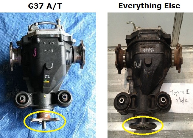

Here's the tricky bit, if you're coming from an A/T G37, then your pinion flange will have three bolts in a triangular layout. The MT's and older ATs came with the round 4 bolt flange. Here's a pic of them side by side.
This means your AT G37 driveshaft flange will not bolt straight up. Since my driveshaft has been already customized, I did not mind cutting its end off and fitting a 4 bolt flange from an M/T. SharpByCoop reported you could use an older G35 driveshaft's rear half and it would bolt right up.

@G37Sam: Instead of modifying the driveshaft of your AT to make it mate to the manual differential, it is possible to swap the AT driveshaft flange from the AT Diff to the MT one you put the 4.08 gears in. That's what I did for my 3.9 gear swap.
Old May 31, 2013 | 05:54 AM
Ivoidwarranties's Avatar
Ivoidwarranties
Joined: Nov 2008
Posts: 2,078
Likes: 29
From: Omaha
True, but by doing this you are now asking your rubber coupler to perform the job of a u-joint because the the pinion does not have a centering pin. I do not think it is wise to use the rubber coupler in this way.

Yes, the auto 3-bolt flange CAN work. No, it's not suggested. At my 500+ hp level we felt a distortin vibration that was cured after we replaced the rubber OEM A/T coupling with the M/T 4-bolt coupling.
One edit needed: ONLY 2007-up G35/G37 rear M/T driveshaft sections will bolt up. NOT from the early ones. You only need the rear section and the mating diff flange.
