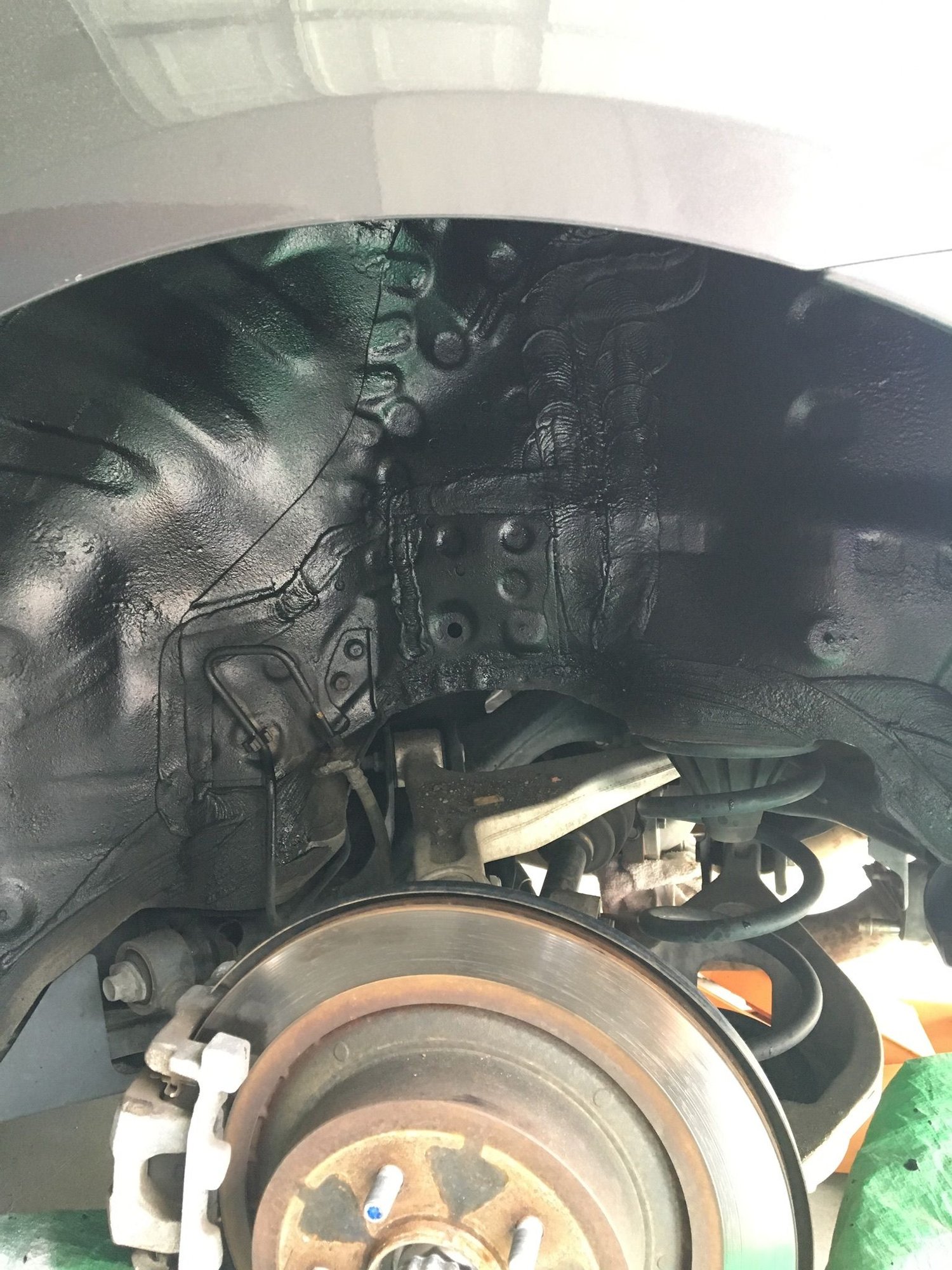

Procedure - Wheel Wells :
  1. Jack up car, remove all wheel well material
  2. Cover up all suspension parts
  3. Liberally spray the sound dampening - avoid key areas (brake lines, suspension,...)
  4. Allow to dry for a few hours, put everything back together
Before and After Pictures :
Wheel well, no insulation shown
Bare metal - nice noise chamber
First coat looks a little wet...
Coat is now dry
Showing off the Koni Adjustables
dB Readings - AFTER Wheel Well Sound Dampening Applied:
  • Local Road @ 55MPH - Range = 64dB - 66dB (~1dB gain)
  • Local Street @ 25MPH - Range = 62dB - 65dB (~2-4dB gain)
  • Highway @ 70MPH - Range = 66dB - 71dB (~2-3dB gain)
