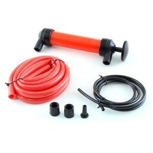

Any reason why I couldn't/shouldn't use this for extracting the old fluid? I have one sitting in my garage.
Old Apr 25, 2017 | 10:43 AM
MotorvateDIY's Avatar
MotorvateDIY
Joined: Nov 2016
Posts: 333
Likes: 354
That should work just fine.
