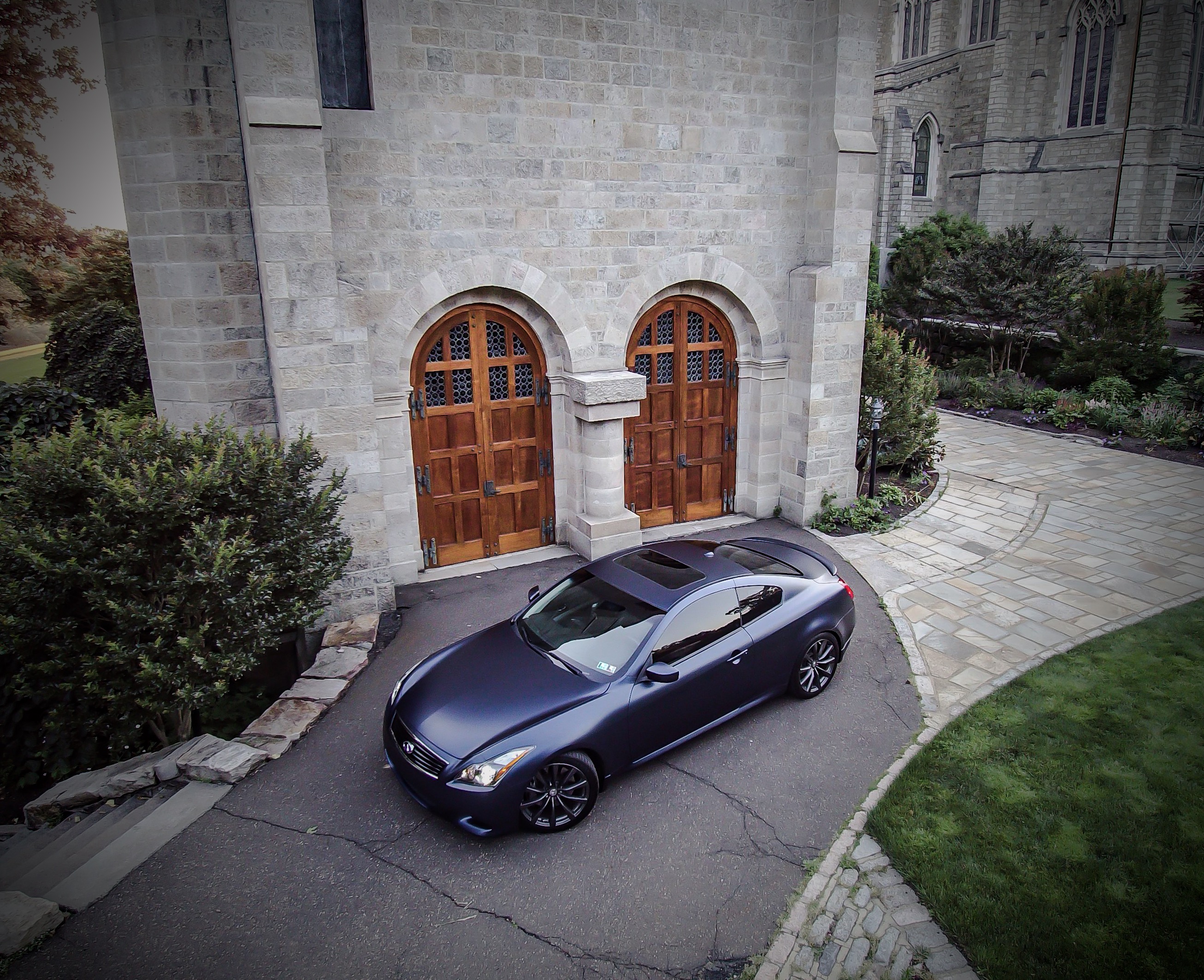

I'm new to this forum, hope I can get some info.
I have 2008 G37s coupe,
front bumper is going to be changed from 2008 sport to the newer 2011 sports version (with foglights installing)
I already changed my headlights to the newer IPL headlights (comes without foglights, my original headlights had foglights built-in)
I was wondering what are the wire colors for the foglight that goes to my headlight? I have to run wire to the bottom fog lights basically.
I appreciate your help!
