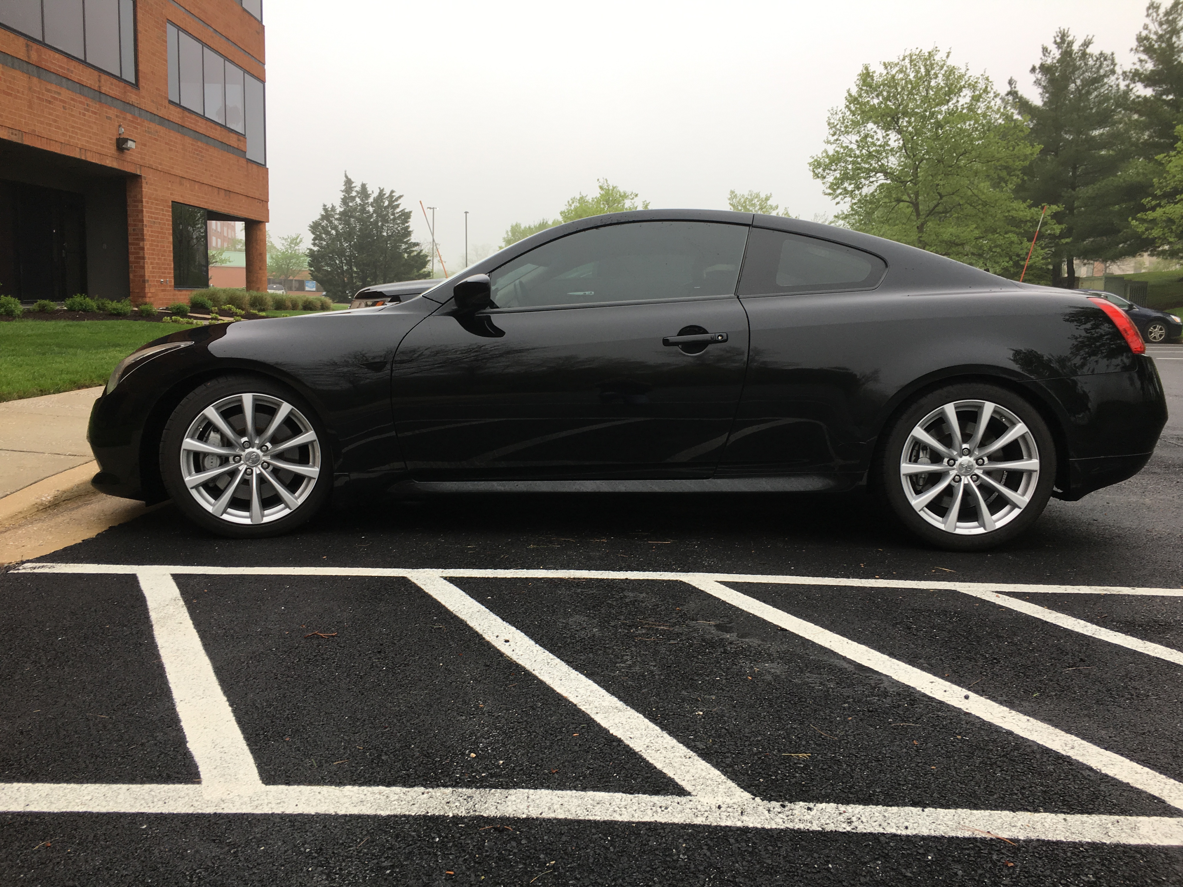

So I did this last weekend, took a few hours. I didnt have any deep scratches, just some minor wear and tear which came out with 400 grit sandpaper. The bondo primer spray filled in any small dings.
I chose a lighter spray paint, I went with a lighter silver metallic as my winter rims are gunmetal so I wanted something with more contrast to my black car. I bought everything at Autozone, the spray paint was half the price from Amazon.
5 bucks for a pack of assorted grit sandpaper, 6 bucks for the can of bondo primer, 6 bucks each (12 total) for 2 cans of spraypaint, and 7 bucks for the large can of clear coat. Pretty darn cheap for a DIY for 4 rims which look brand spanking new.
