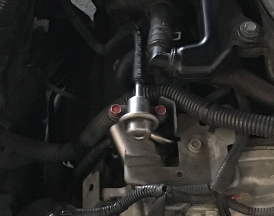

This is the how my fuel damper looks like right now. I think it qualifies to be changed. What are your thoughts? Hopefully that's the only part I need. Please let me know ! Greatly appreciated.
Old Jan 28, 2019 | 11:05 AM
ILM-NC G37S's Avatar
ILM-NC G37S
Joined: Apr 2014
Posts: 4,856
Likes: 1,612
From: NC
If you see/smell raw gasoline in/near/around that area than likely the o-ring on the damper is failing. Also, a very loud ticking/knocking noise could also be a sign of a failing damper. However, if you have any doubts take it to a certified mechanic for a visual inspection/diagnosis.
