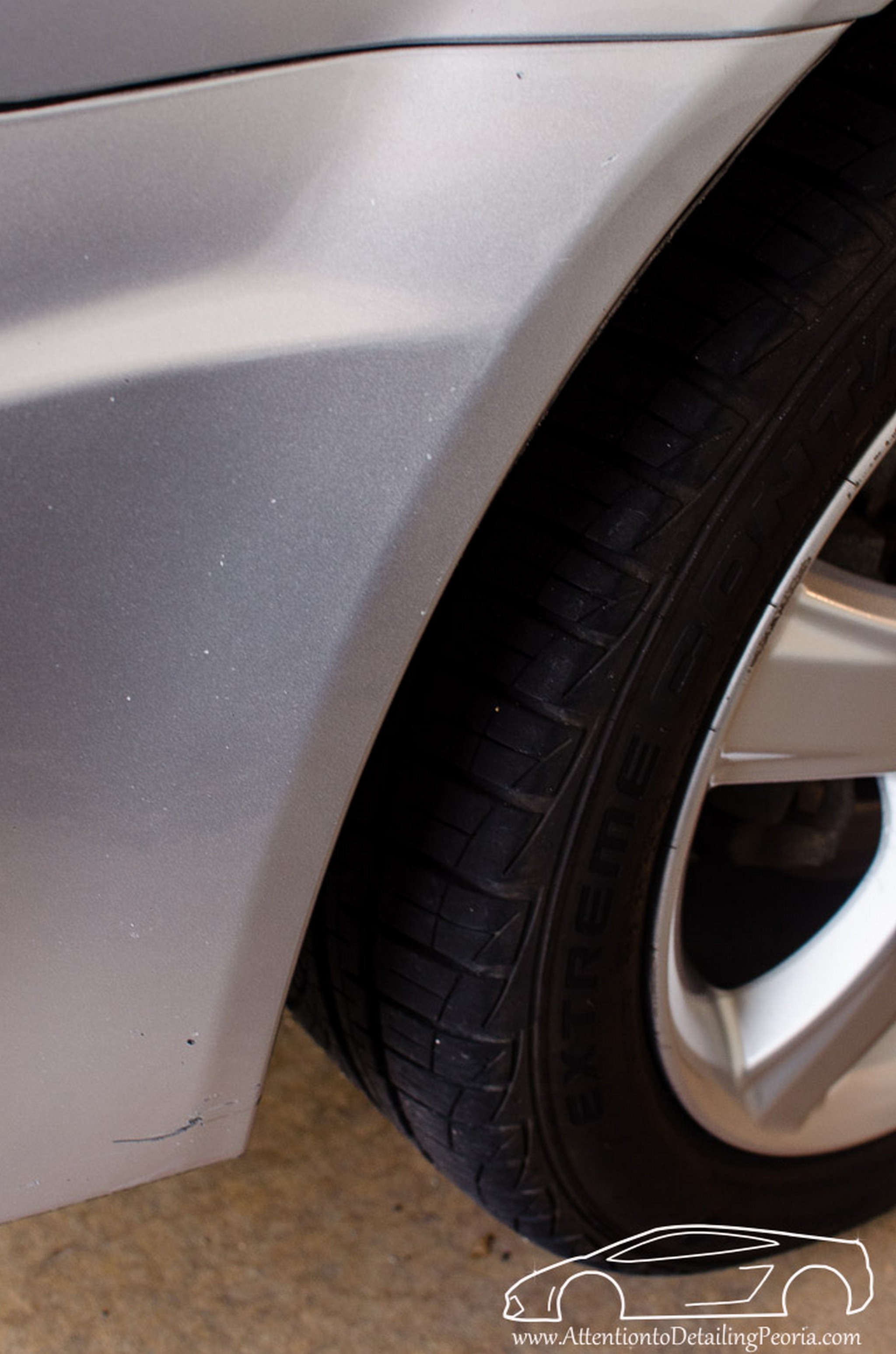

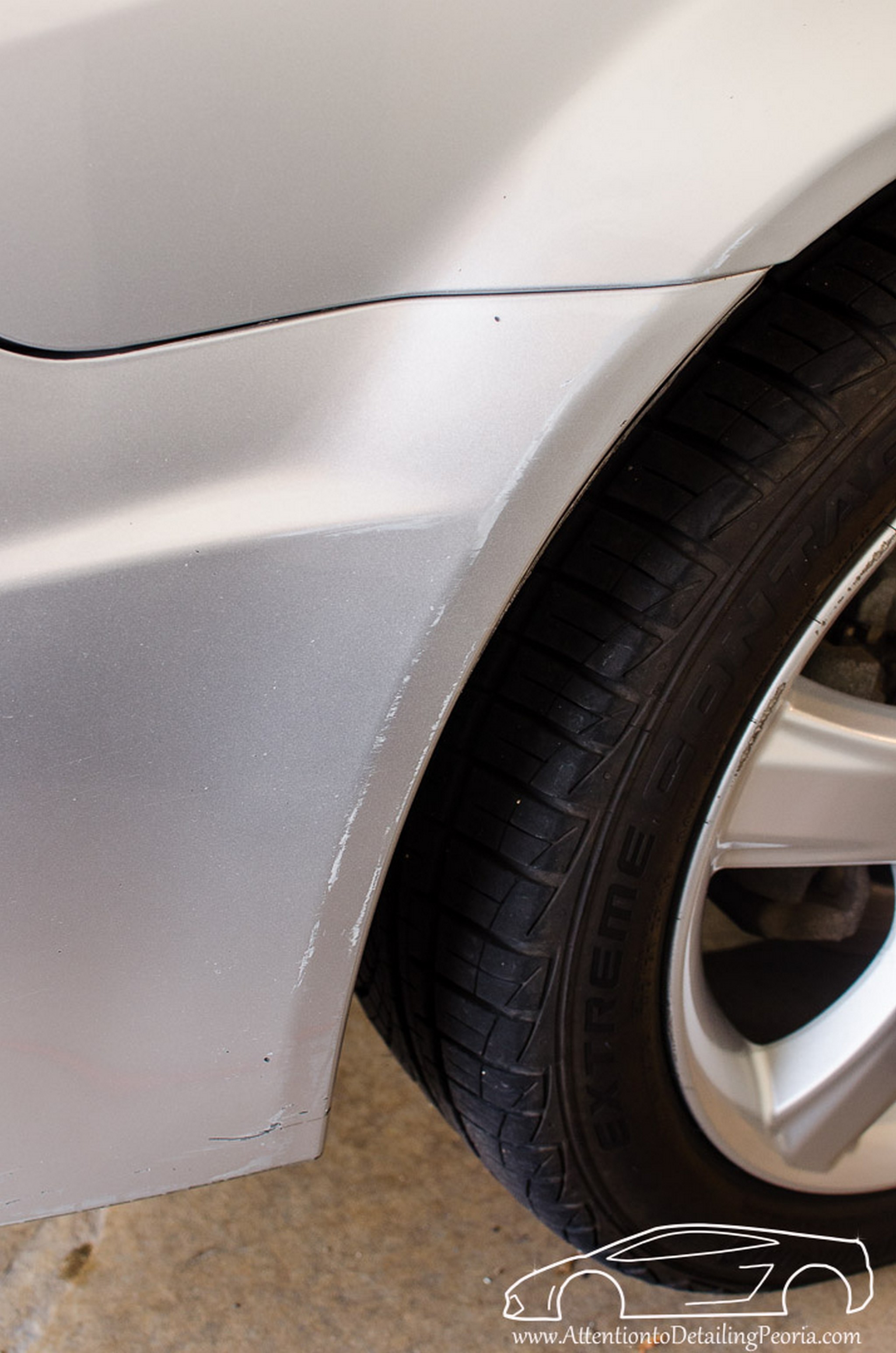

When you bump your car with something, or something bumps your car, or whatever... there are 2 possible outcomes in terms of paint damage.
1 - material transfer. The object (car, garage door, shopping cart, whatever) scuffs your car and leaves a mark. This mark is actually residue from the object that hit your car. In some cases it is paint transfer, other times it is actual plastic material that is transferred. In any case, it is removable!
2 - scratches. In this case the object which hit your car actually scratches into your paint. The severity of these can range from a light blemish to a deep scratch all the way down to the substrate. Light scratches are easily removed, but anything through the clear coat cannot be easily repaired except with repainting.
Example of Material Transfer
Before
After using M105 and M205 on a 3" dual action polisher
Hope that helps. Let me know if you've got any other questions!
