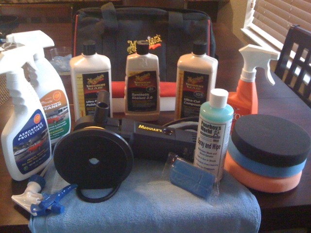

Want to give a quick thanks to the guys at Detailed Image. Just received all my goodies and am looking forward to getting my black G37S a much needed full detail this weekend. Thanks for the great prices and products guys. I will post pics before and after once I get done on Saturday.
I hope you bought more pads or some snappy clean packet things to clean off those pads, because if you got only one of each your going to have a helluva time cleaning them back and forth... I also hope you bought more microfibers
I have 3 Large Microfiber towels and 6 medium. Should be enough I'm assuming.
You'll realize after a 4 panels you wish you would have bought two more pads.
Why did you go w/ blue and black pads? Isn't it practically the same; correction wise? Personally I would have gotten two yellows, two whites, and two blues. I didn't like the orange pad.
Basically, as this was my first true detail purchase, I just followed the instructions on detailed image for each product I bought. For example, they recommended the blue and orange pad for the M105 and M205 products so I bought that. I purchased the black for when I apply my wax. Nowhere on detailed image's site did it say purchase or to be used with "white pad." What exactly separates the white pad from what I bought? Didn't buy the yellow pad because apparently it is a very aggressive cutter and I didn't want to bleep up my car on my first whirl on the DA polisher. Is there a place locally I can purchase decent pads at if I want buy more? Let me know.
