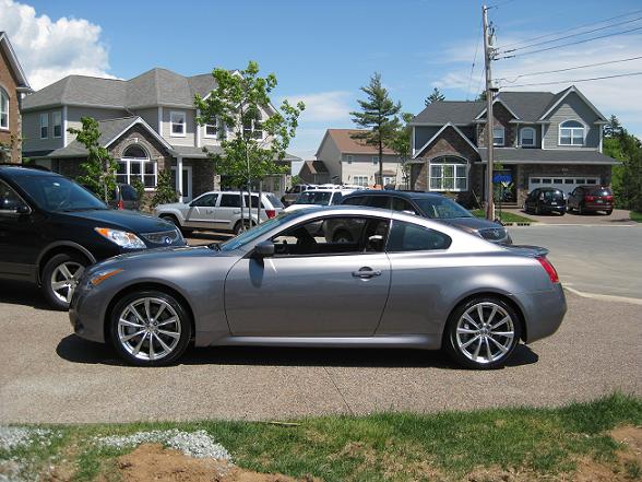

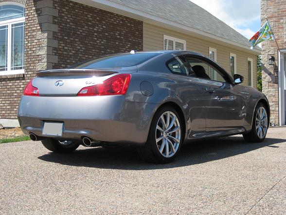

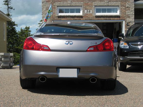

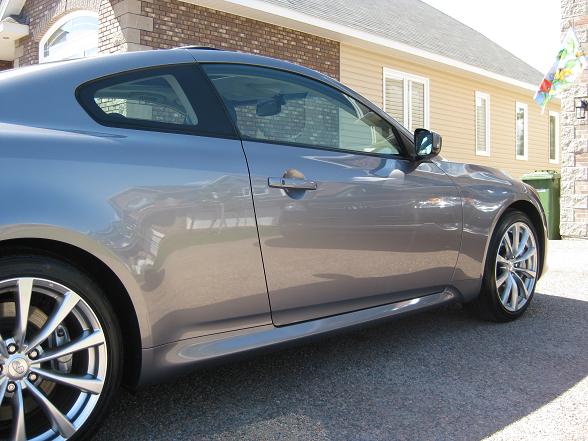

As some will know, I traded my 2008 Ivory Pearl 5AT for a 2009 Liquid Metal Grey (Amethyst Graphite in the US) 6MT. I detailed the car this weekend for the first time... lot's of fun . Thought I would post pics...
Process:
1. Washed car
2. Clayed car (needed it badly)
3. Re-washed
4. The car had some minor swirls so I polished with Menzerna PO203 on a white LCC pad with the PC.
4. 50/50 Isopropyl alcohol wipe down
5. Applied Jeffs Werkstat Prime Strong via black LCC pad and PC.
6. 2 coats of Jeffs Werkstat Acryllic Jett Trigger
7. P21S wax to add a little depth
I'm very happy with the 7 hours of work (my wife less so considering the time I spent ). This car has the self healing clear coat and I had no issues as all with polishing it. Results were as expected. Having said that, it was a medium/mild polish... can't say what the result would be with a compound or more aggressive polish/pad combo.
I have to say that I LOVE this color. I had the IP G37s before this and a white BMW 328i. It was time for a color change and this color is amazing... sometimes it looks deep grey, other times it looks to have a purple hue... it changes with the light. I love it.
Attached Thumbnails 2009 G37S - Liquid Metal Grey... 1st Detail-g37-1.jpg   2009 G37S - Liquid Metal Grey... 1st Detail-g37-3.jpg   2009 G37S - Liquid Metal Grey... 1st Detail-g37-4.jpg   2009 G37S - Liquid Metal Grey... 1st Detail-g37-6.jpg   2009 G37S - Liquid Metal Grey... 1st Detail-g37-7.jpg
