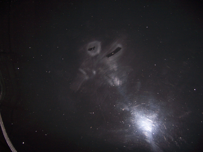

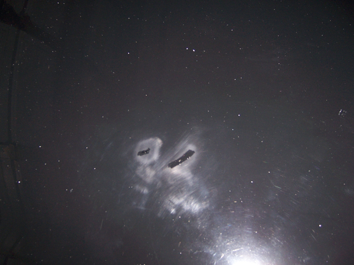

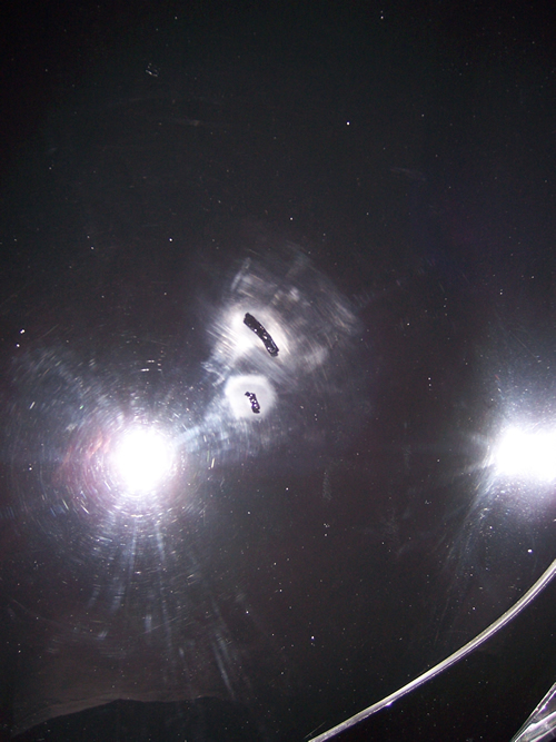

Pictures of the disaster so far
I just took these with the flash. They are not great but they should give you some idea.

In general the paint looks very swirly. Your hazy scratches don't look that much worse than the rest of the paint. I bet they are very light clear-coat scratches, to be expected at this stage and to be polished out in future steps.
Check this out -- and ask him for advice if you want:
http://g35driver.com/forums/showthread.php?t=95437
In particular, your images look A LOT like his in-progress image:
and here's his end-result image:
Note that the rest of your black paint doesn't look anywhere like the black paint in his pictures... that's what I mean by your black paint looks all swirled up/scratched anyways. A good high quality detail would certainly do your car a lot of good. Maybe get a professional detailer to finish up your scratch repair and the polish the whole car?

Notice the spider webing on the light reflections...polishing can take that out and produce a mirror like finish, just look for a local car detailer that offers car polishing. If you want to do this youself, you'll need to spend some bucks for a buffer, pads and polish. http://www.detailedimage.com/DI-Packages-C62/ sells a kit and there are videos online to show you how to use the porter cable, worth having and knowing as a OB owner.
