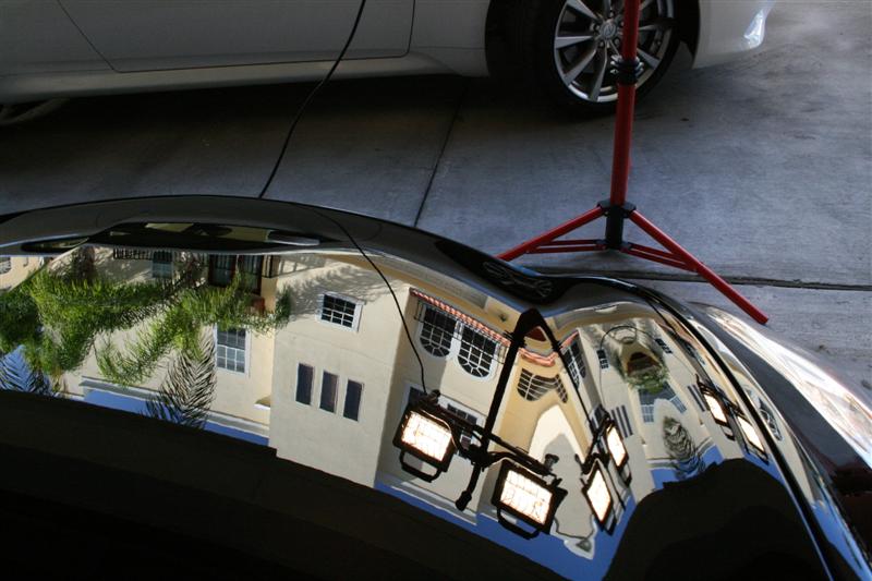

So about 20hrs of labour later & its done. Notes:
1) the clay put quite a few scratches in the clear coat, more than what I'm use to, it was chilly on friday when I was doing it so not sure if that had an impact or if its just that the G has such soft paint. Next time I'll be using a fine grade of clay.
2) Because of the heavy clay, i had to add a polishing step (using super intensive compound and orange pad)
3) it took so long i didn't even have time to take after pics so am attaching an "in progress" one. I tried to take a few this morning but it was pretty hazy so no dice. I'll try this afternoon.
4) I'm thankful we only have one black car
Attached Thumbnails Ask a Professional Detailer... Brought to you by Detailed Image-img_7354-medium-.jpg
Old Dec 14, 2009 | 08:52 PM
  #945
Detailed Image's Avatar
Detailed Image
Auto Detailing Expert
Joined: Mar 2007
Posts: 4,461
Likes: 69
From: Albany, NY
Snoop, thanks for the updates. Looking very sharp and reflective! Great work. You definitely always want to stick with a fine grade bar, I thought that's what you used based on your product combo you posted. As you mentioned with the soft Infiniti paint, there's almost no need for more than a fine grade bar.
Love to see some fully finished shots if you have any.
Thanks for sharing
