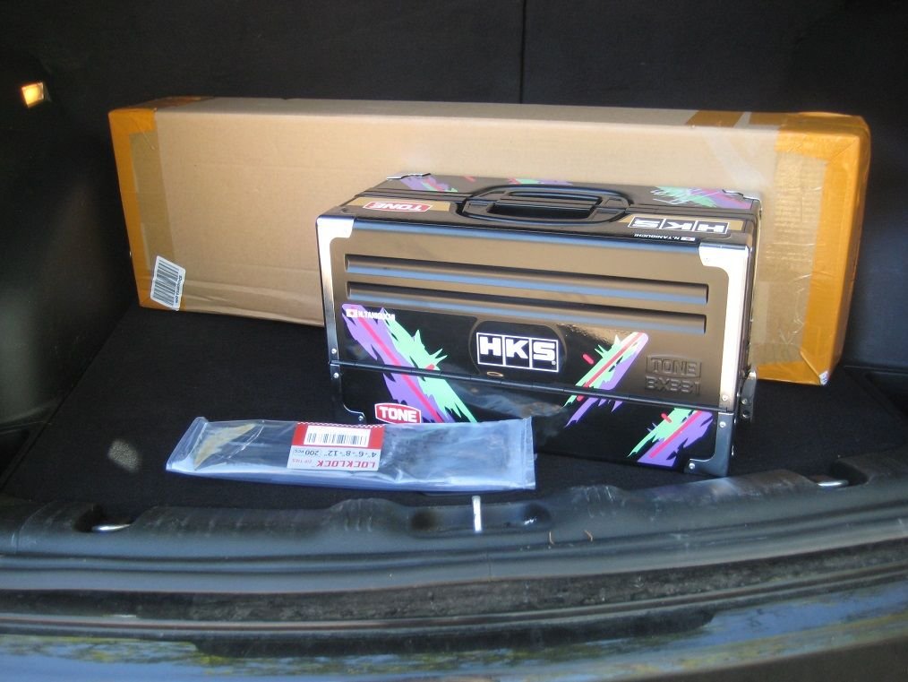

A couple more "mods" while I continue waiting for my backordered suspension arms to arrive. Decided I needed a bit more excitement under the hood, so grabbed this HKS radiator cap and Project Mu sweatband for my PS reservoir. Hope to have a better update soon if I ever get shipping info for my other parts, coilovers are getting pretty lonely sitting by the door.

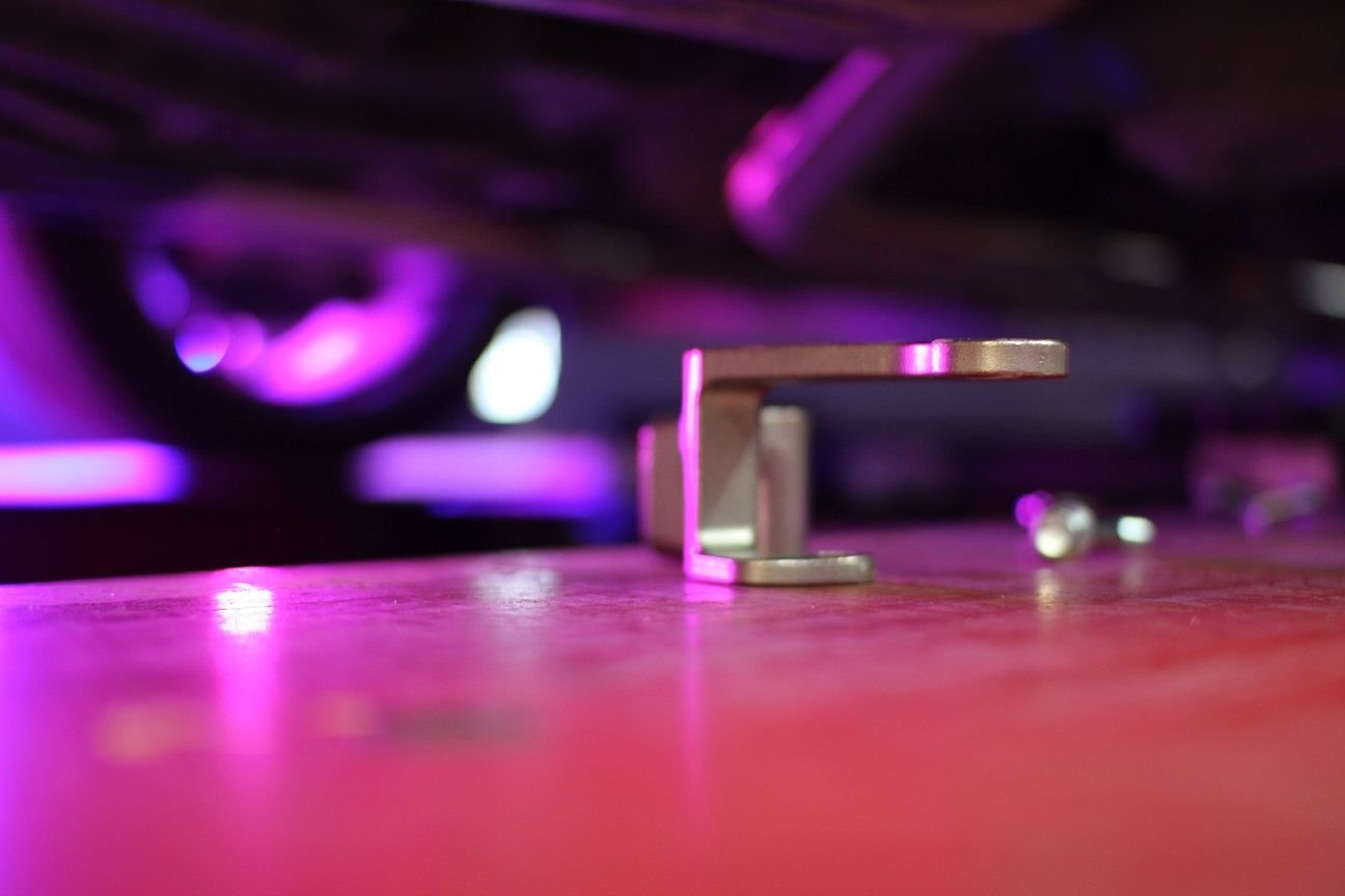

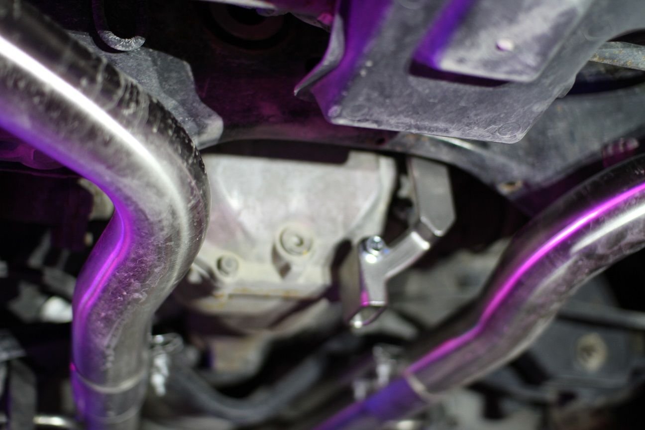

Still waiting for shipping info on my suspension arms, but was able to get my trans fluid flushed and a diff brace installed today. Went with the Z1 brace and MT-90 to fill the trans, bonus photo of a less cool Skyline parked next to mine lol. I'd say the brace made a noticable difference as far as throttle response and the feeling during shifts. I'd get the occasional bit of drivetrain noise during fast shifts, but that seems to have been replaced by wheelspin which is an upgrade IMO.

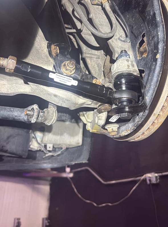

All my suspension bits showed up over the past couple months. Ended up going with Stance XR1 true coilovers (kind of sad I didn't go with the Swift spring option), NISMO FUCAs, SPL rear camber and toe arms, and then (unpictured) the GKTech bolt on angle kit. Decided to knock out an oil change as well, trying out Motul 8100 5w40 and a NISMO filter. Below are a couple pics from the install (don't mind the surface rust):
After cruising around a bit the past couple days, I noticed I'm rubbing my right wheel a bit at full lock, so I'll need to get the front fenders rolled flat to match the rears and hope that'll resolve the issue. I'm hearing a faint bit of rubbing between the rotor and dust shield as well, so I'll bend that around while doing the fenders.

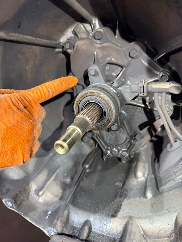

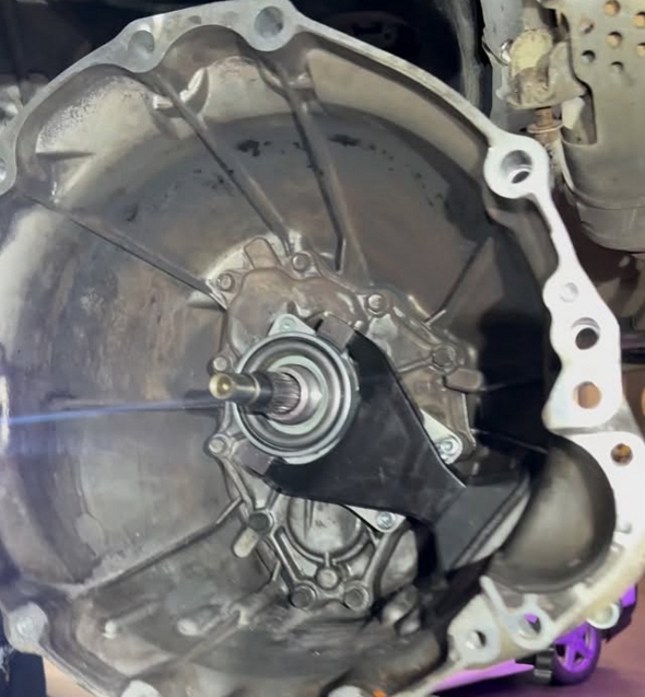

Got hit with the dreaded (and expected) CSC failure a couple weeks ago. Luckily I caught it before losing all pedal pressure, but decided to just go all out and get a CSC delete so I don't need to drop the trans in the event of an additional failure in the future. Went with the CZP delete and couldn't be happier with the result, luckily the shop that did the install had one hanging around. Pedal feels more consistent and only a touch stiffer than with the OEM CSC, definitely a modification I recommend to anyone who has a failed/failing CSC because it will break again.

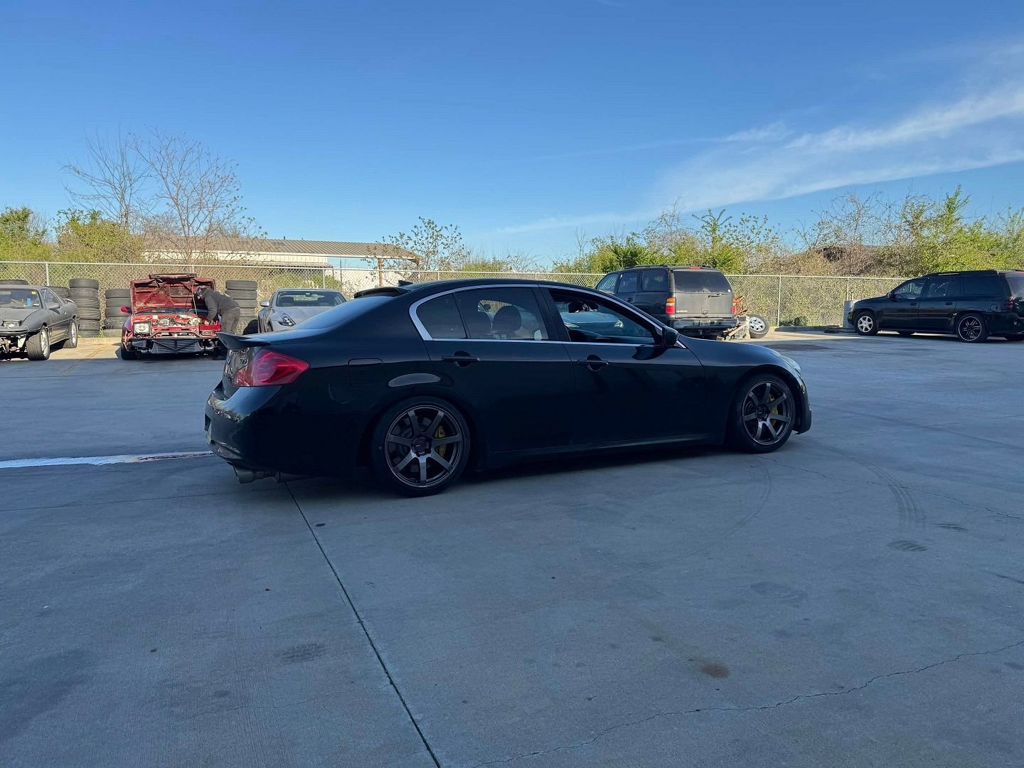

Finally went down to 18s and got some fresh tires for the new wheels. Decided on Valino 08Cs for the front and Kenda KR20As in the rear (235/40 all around), front wheels are 18x9 +30 (have a 15mm spacer for effective +15) and 18x9.5 +25 in the rear. I'd like to go ~1" lower all around to close up the wheel gap, but at the moment I'm just living with this height. While the car was at the shop for tires I also had them take care of welding my diff, I'd planned on a 2-way but the shipping time didn't line up with the event last weekend. I will likely still be ordering the Cusco unit I was looking at but I'm in less of a rush now, the welded is surprisingly livable on a daily driver.
Took the car out to its first real event and it honestly drives better than some of the cars I put together years ago even though its quite heavy. Once you get used to the weight and wheelbase it becomes very easy to drive and I'm excited to get into some tandem later this year. The oil and power steering coolers I installed also worked well, never had steering issues and even with my OEM radiator the temps barely went above the typical reading on the gauge. I am adding a Defi Advance FD unit soon to more accurately monitor coolant temps and oil pressure, but other than that I think the last piece of this puzzle is a Bride seat (my helmet hits the A pillar pretty regularly with the stock one) and then just tons of pairs/sets of wheels.
