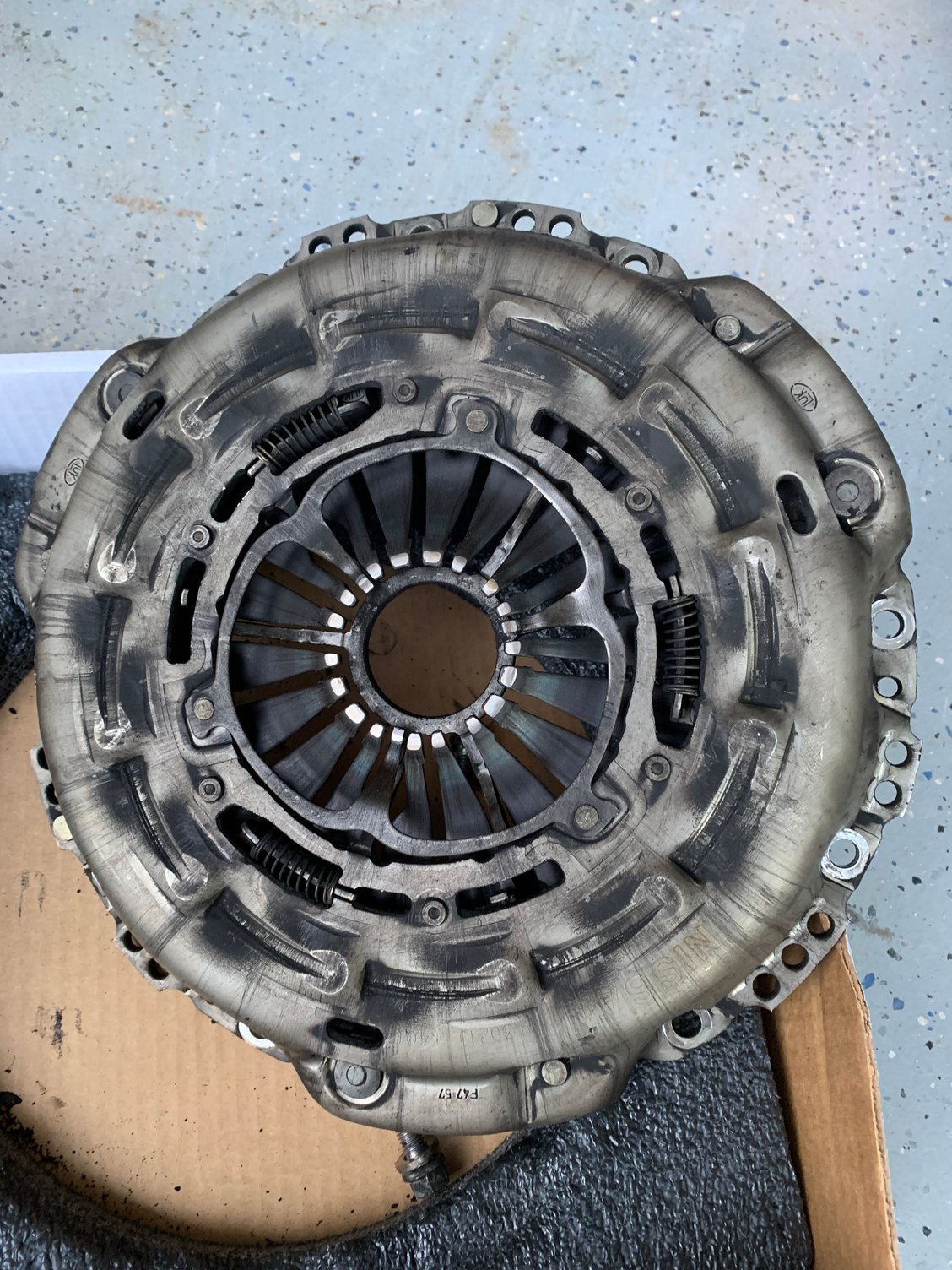

SO here's pics of the removed parts: Pressure plate front and back, clutch disk front and back, flywheel front and back. Other than some mild overheat spots, they look pretty decent to me.
And here's the culprits:
The master cylinder was covered by some sort of latex/sealant goo that had hardened. The CSC had fluid everywhere.

So the CSC failure led you down the primrose path of a clutch & LW flywheel upgrade... right?
I mean, the HD CSC is a fine replacement, and probably gives you peace of mind, but what about the drivetrain upgrade? I've been waiting to read about your clutch/FW upgrade. Particularly since you spent thousands of dollars on parts & labor, with more than a little agita about the project.
Yep. $1500 labor whether they replace JUST the CSC - or everything in there. HD CSC was $350, so the flywheel and clutch weren't out of the realm of possibility. Spent the extra $150 on ZSpeeds install kit - all new heavy duty bolts for PP and FW, Redline fluid to refill the trans and Motul brake/clutch fluid. Master was $135 I think. Notable weight difference - the LW was just kinda heavy, the regular FW is actually difficult for me to lift with one hand. I'm no strongman, but I do hike with a 50 pound pack... and this was heavy.
Can't really evaluate it until the whole shebang is broken in - 500 miles or so. Until then, 500 miles of sedate driving. I drive the car maybe 1x week. Not noting much of a difference at sedate mode - other than the rattling (noise only, and minor) and slightly increased pedal effort. I mean like 20% - might just be selection bias, honestly. That and the pedal is too close to the floor - need to install RJM pedal and adjust properly.
