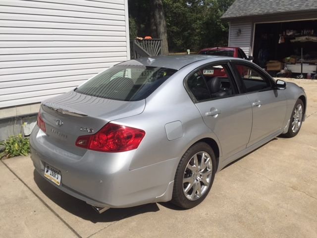

Painted and ready for final assembly. Doors were painted off the car. The silver was a total PITA. I had flop issues and had to have it tinted. It matches ok and most of the mismatch was hidden in blends. The gas door was painted off the car and didn't match well. Luckily the original door was undamaged and a ok match. There is a little color mismatch at the rear cover seam, which is a little strange since it matched the trunk ok.

A few finish shots. I had to change the driver's rear wheel bearing today. The toe and camber rods were bent. Apparently that hit damaged the bearing. In the auction pictures, the front sport cover was great. When the car got here, the bottom of the cover was damaged by a carless yard fork-truck operator. So, I bought the eBay splitter. Not sure how it's going to hold up. It's some weird plastic, and the double sided tape wouldn't even stick to.
When the car was delivered, it was missing the floor mats, battery, front door scuff plates, and owners manual. Not sure if it happened at Copart or if the truck driver stole them. It was about $300 worth of stuff. I was happy to get a set of lighted sills for $65 delivered and silver Infiniti wing for $135 delivered from 360motors on eBay.
