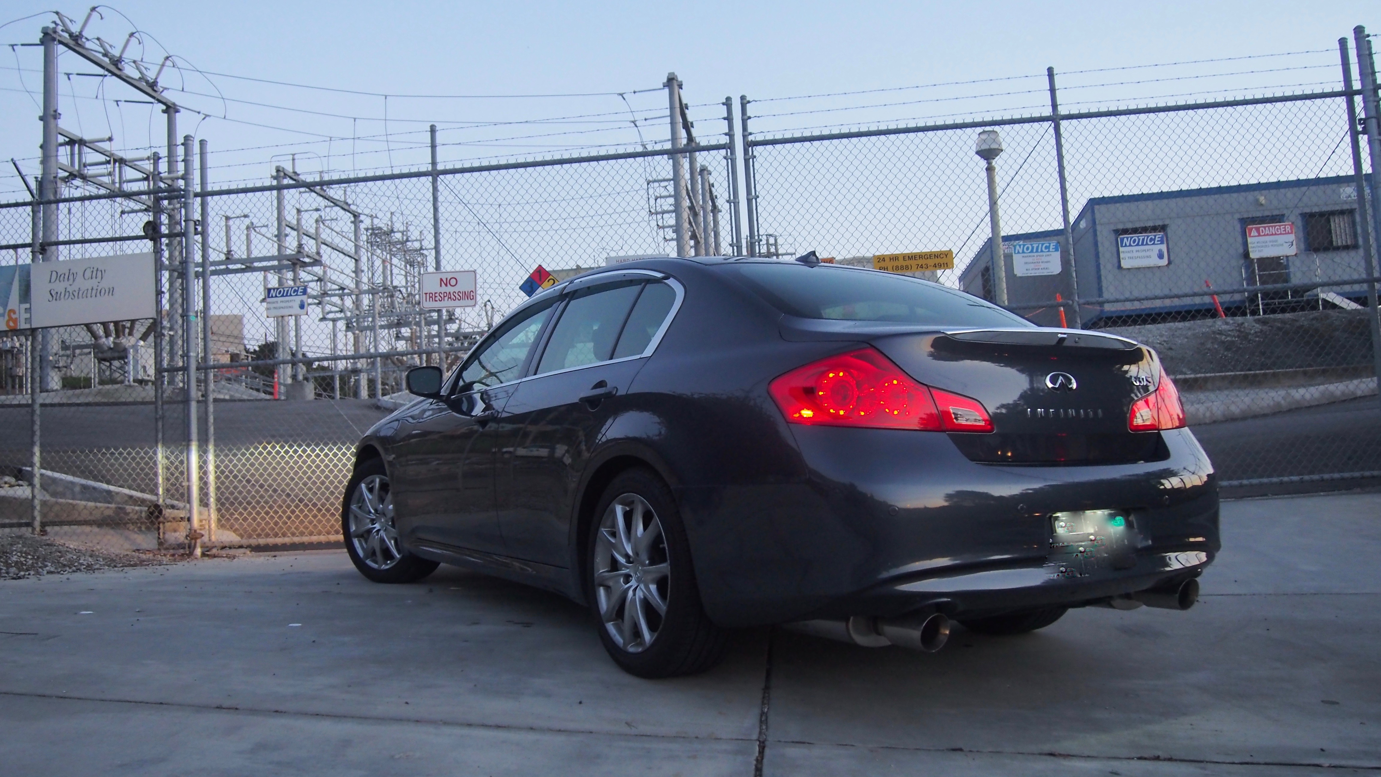

Finally got around to taking a proper pic of the car with my camera.
