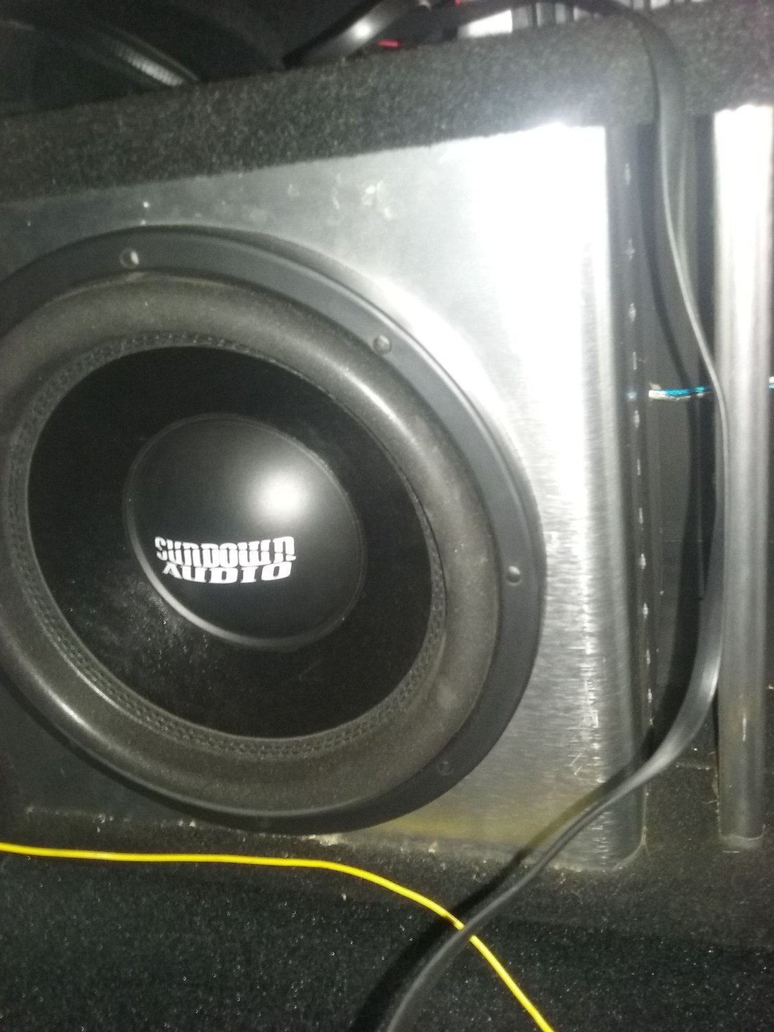

Subs going in
Two Sundown Audio 12,s
Hifonics Brutas 1700d
Subs under carpet facing foward ,no wires ran yet for power started to rain.... got the wire kit ready...prob a tuesday install.

the subs are 2 12" Sundown Audio on a Brutas 1700.1
rated and 600 Each
some action shots of the same woofers i have going in

ok got the subs installed, did it myself and everything is working great, i need to get it tuned up and some thicker better wire( it was a quick install)
didnt run into issues except for that STICKY black tar **** behind the door panals my god lmao **** was all over........TIP Mineral Spirits.....came right off....
I will try to get a sound clip and a few snaps , i have the subs pointing towards the seat so have to crawl in there to get some snaps lol sound quality will prob be terrible..(phone) .
btw for future Lookers This was installed using a
2010 Infinti G37 BASE (just door Speakers NO Stock subs As basic as can get)
Hifonics Brutas 1700.1d
(2) 12" SundownAudio SA 12 d2 @ 600 Each
scosche loc2sl(walmart)
Tied Loc into the Door (I used the Right Door Rear) Pink/Blue Wires (used T Taps) right before the Plug on the Door Speakers.
Remote Was tied into the LOC and Ran to the Trunk (Blue Wire On scosche loc2sl) to the AMP
12v Wire on the scosche loc2sl (Yellow) this was ran to the back and Hooked the 12V With the 0 Guage Power) On the AMP
Ground Wire (Black on scosche loc2sl) to a ground Spot Behind the Pillar in the Inside of car
hooked up speakers wires
RCA's ran from the scosche loc2sl to the AMP Inputs.
No problems as of yet.
