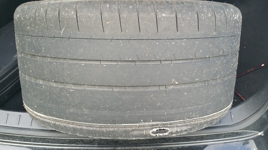

Well had a blow out yesterday....rear passenger tire is completely shredded. Steel wires poking out of the Michelin PSS...I have to say...I've only had them on for about 10 months now and somewhere around 7k miles....I am running -2 camber but toe has always been in spec. I am extremely disappointed to say the least and will NEVER buy Michelin's again! I looked at my rear drivers side and same thing...steel wires poking through!

yes me and you both.....but I still think something went wrong at some point besides just running negative camber.
I picked up a set of 275/30 Dunlop sp sport maxx gt's.....im not happy at all going with the 275 as its more stretched then I prefer, but fig I could run less neg camber and see how that goes. So only time will tell.
and for those that didnt the pic before in the other thread...here ya go

Well that wear is evenly slanted all the way to the end, doesn't seem abnormal for running higher camber but the amount of miles it took to get that wear seems accelerated for sure.
Hopefully w/ a little less camber you'll have better results.

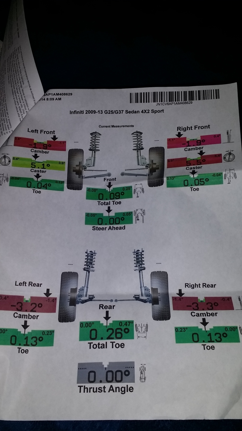

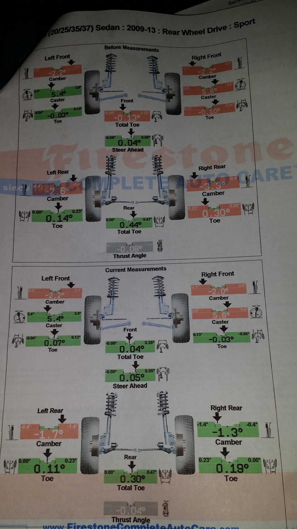

Ok found my print out from back in Oct as well as the one from last weekend, cant for the life of me find the one from a few months back. With that said, I was wrong, my rear camber was -3 and I am running -2 upfront. So I can see the wear on the tire as such, but again not it completely blowing out in 5k miles.

That sounds pretty typical of tires running camber -3 or more, you've got the whole load of the powered rear of your car centered on about a third of your tires' contact patch. Once the tread gets down to a certain point below the wear bars it really wears fast. Just be glad you kept your car under control and nothing else happened.
High-performance tires against hot Florida blacktop, on a RWD sport sedan with over 330 HP, while out of spec over 3* negative camber?
There's your answer, Daddy. 5K miles seems just about right.

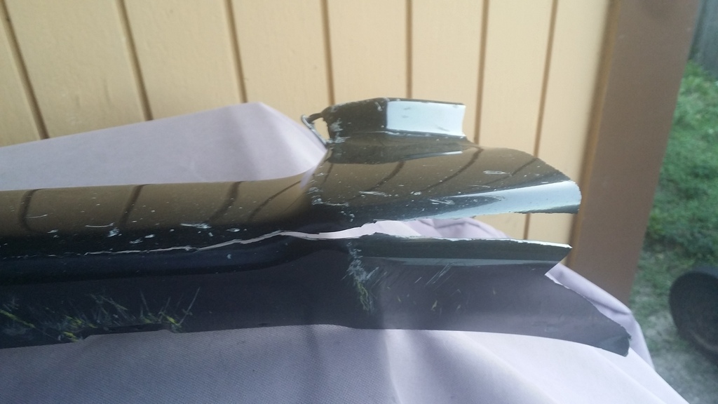

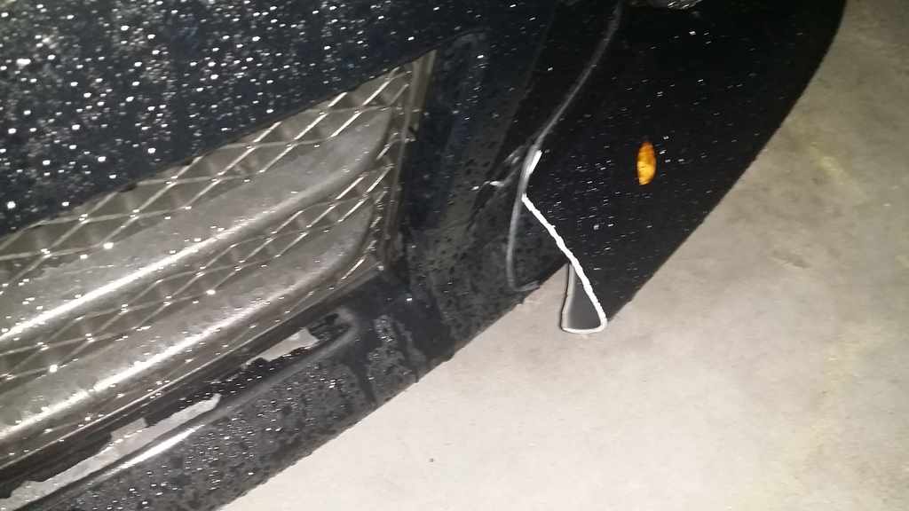

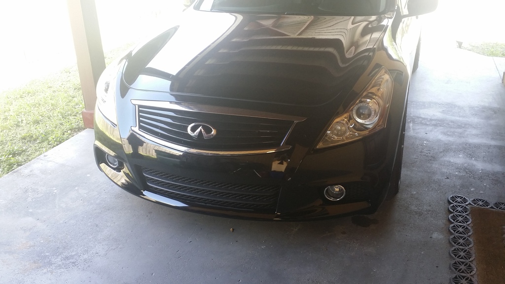

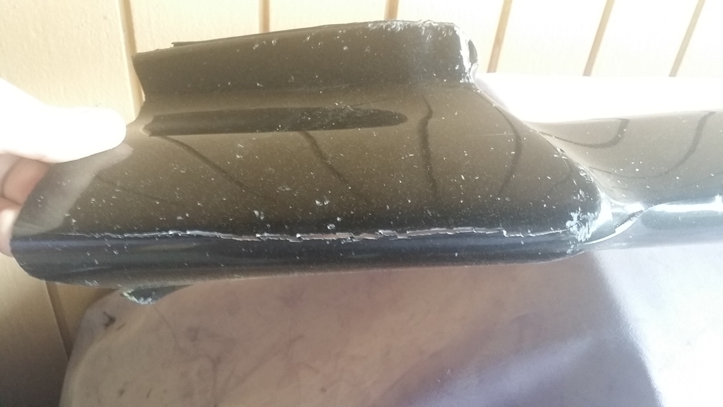

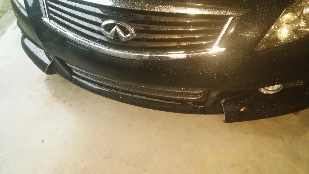

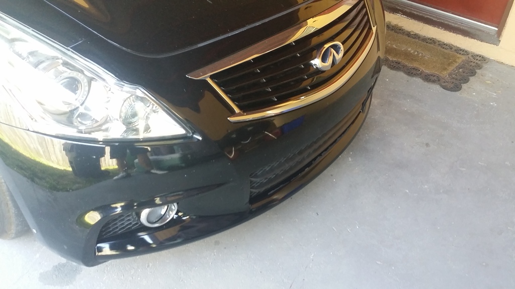

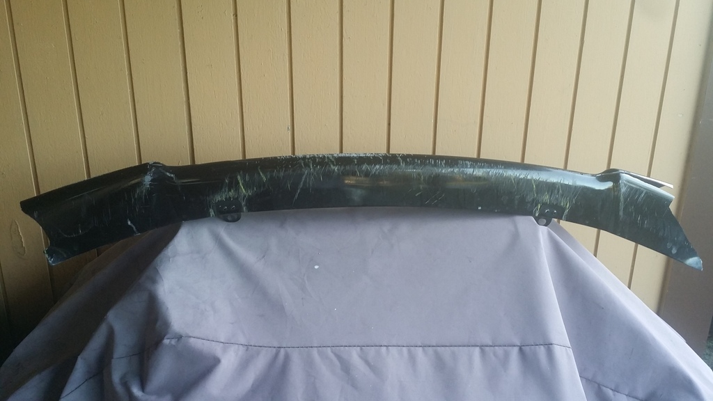

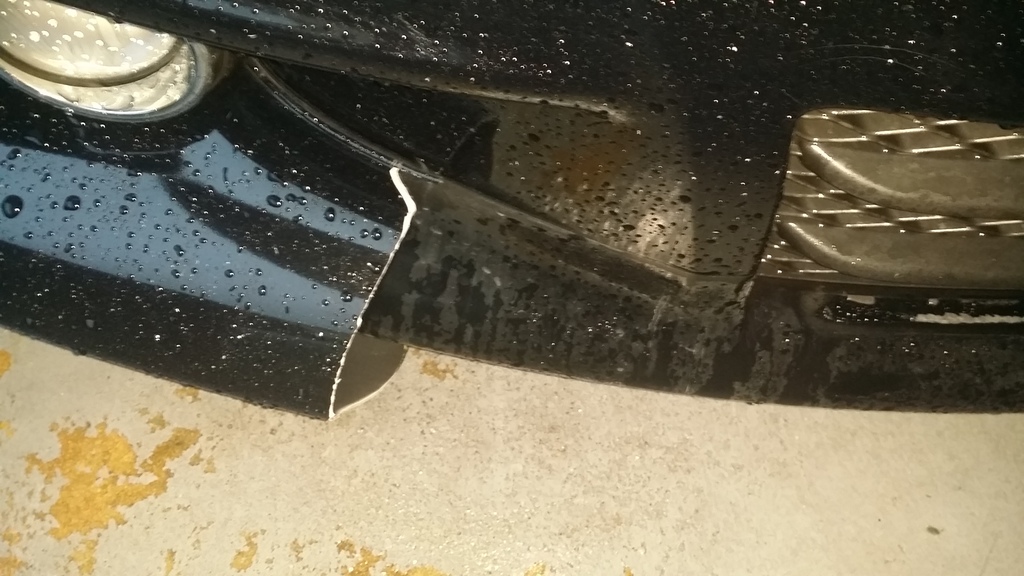

Well believe its over due....haven't been on here a whole lot due to a job promotion. But I believe most have seen or heard about my incident with the wife ripping off my front sport lip
I went from this the weekend before:
To this in less than a week:
I finally got around to taking of the remaining pieces and tape....she is now lonely and plain like all the other G's
