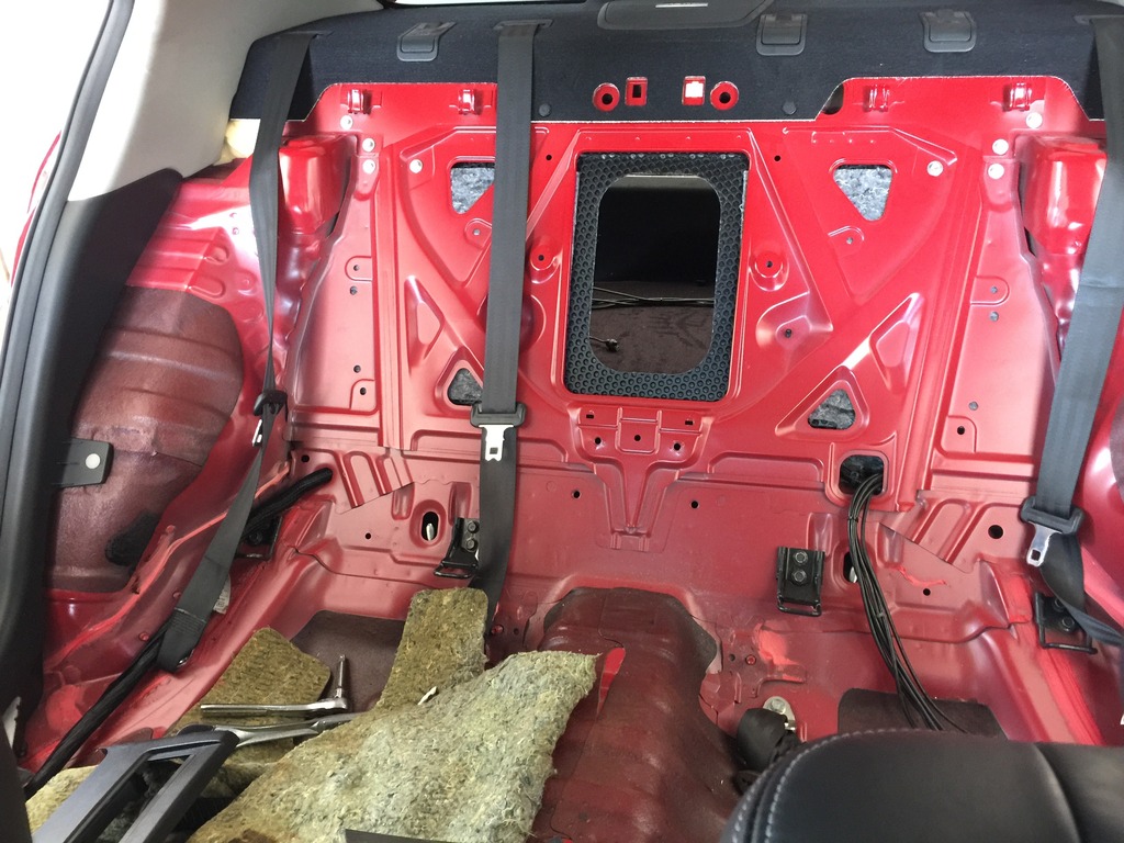

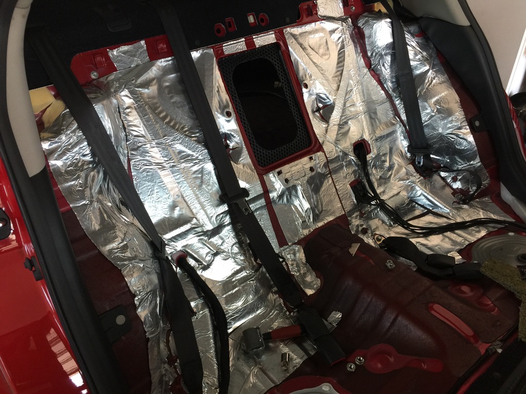

so i finally got off my lazy butt and did some work towards getting the air thats been collecting dust going again.
ran power, control and pressure gauge wires. while i was hammering the openings for the wires to flare the edges i realized that the back panel is one big resonating panel. Dusted off some matting and went on in.

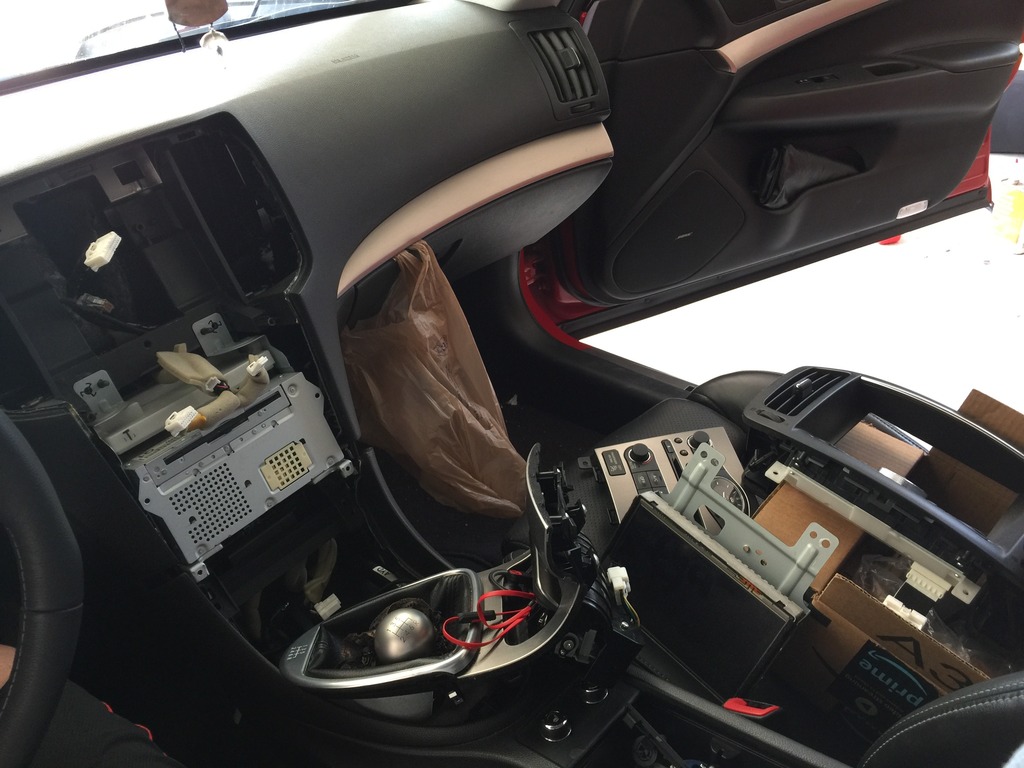

was curious about space and took the dash apart.

That's quite the coincidence, seeing that naked back seat. I'm about to take down that area, too, and just printed out a few pages from the FSM on the topic. So... any tips? Did you remove the rear shelf as well?
Did you notice any spund differences afterwards? I think conventional wisdom says that noise through the frame comes from below, although resonance can occur anywhere, really.
Old Jun 4, 2017 | 11:37 AM
  #249
ToXIc's Avatar
ToXIc
Joined: Aug 2014
Posts: 756
Likes: 105
it wasnt hard at all, didnt even use the FSM just started scrapping.
1:remove bottom seat
2:then the two sides
3:top part of arm rest
4:bottom of arm rest
i didnt remove the self only because the seat belts ran trough it and had too much going on the eff with it. if i was just in there for dampening i probably would.
there was a big difference in sound even in my garage i literary did a double take. the full motordyne is aggressive and loud especially at start up.
trying to talk myself in to scrapping the trunk carpet and tackling it from there. the bottom had factor matting so i just did mostly the bare areas.
i got the matting from the hot rod shop that restoring the Z, its really light and works great. 10 roiling yards was about 8lbs.
Old Jun 4, 2017 | 11:45 AM
Seriously? What is different about it?
And all you covered was the backrest section?

It just really surprised me. Normally you can distinctly hear it from the back of the car but now it's spread out.
I still have to go for a spirited drive and compare as I don't really drive the G on the weekends.

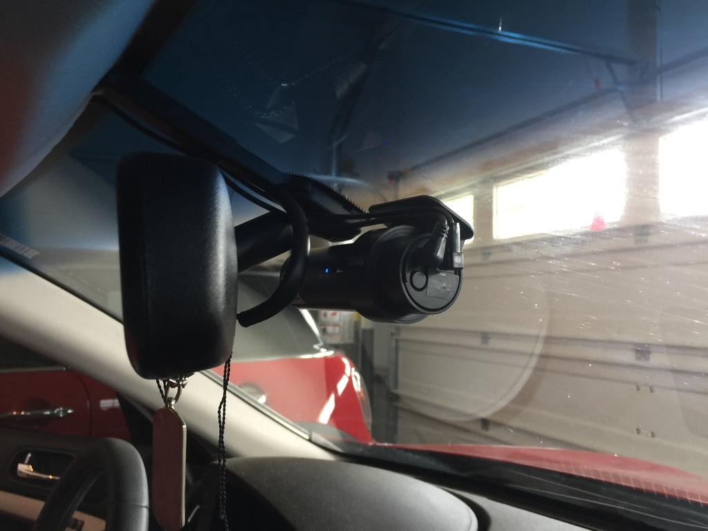

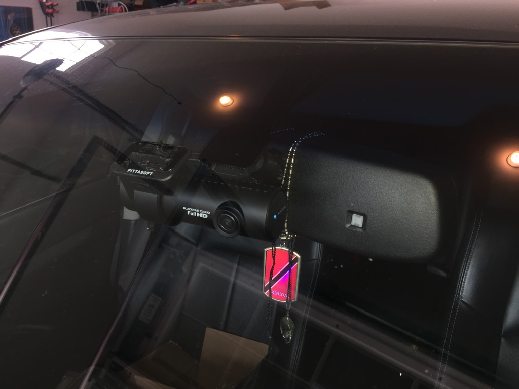

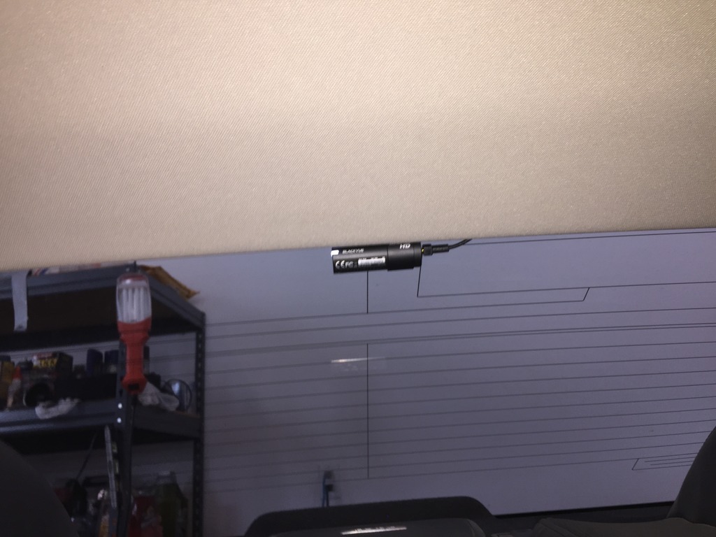

also after waiting for forever i finally upgraded my dashcam

Tell me more about the Dynamat. It seems to come in 18"x32" sections, and bundled as 9 pieces for $150 give or take. How much did you buy? Did you have any left over?
It looks like if you had some more, you could have applied more coverage? Are you going to continue?
Old Jun 4, 2017 | 02:40 PM
  #254
Posts: 19,846
Likes: 5,143
Here's another question... you've removed your center console and shifter components before, right? There is a *HUGE* amount of noise coming up through that shifter area, muffled only by a rubber boot on the underside.. Have you considered using Dynamat in that area?
Old Jun 4, 2017 | 03:40 PM
  #255
ToXIc's Avatar
ToXIc
Joined: Aug 2014
Posts: 756
Likes: 105
so its not the "dynamat" branded matting i got it last year from the shop, he charged me $80 for 10yrds. this isnt as thick and heavy as dynamat but works just as well. i'll have to ask them about it and will let you know.
