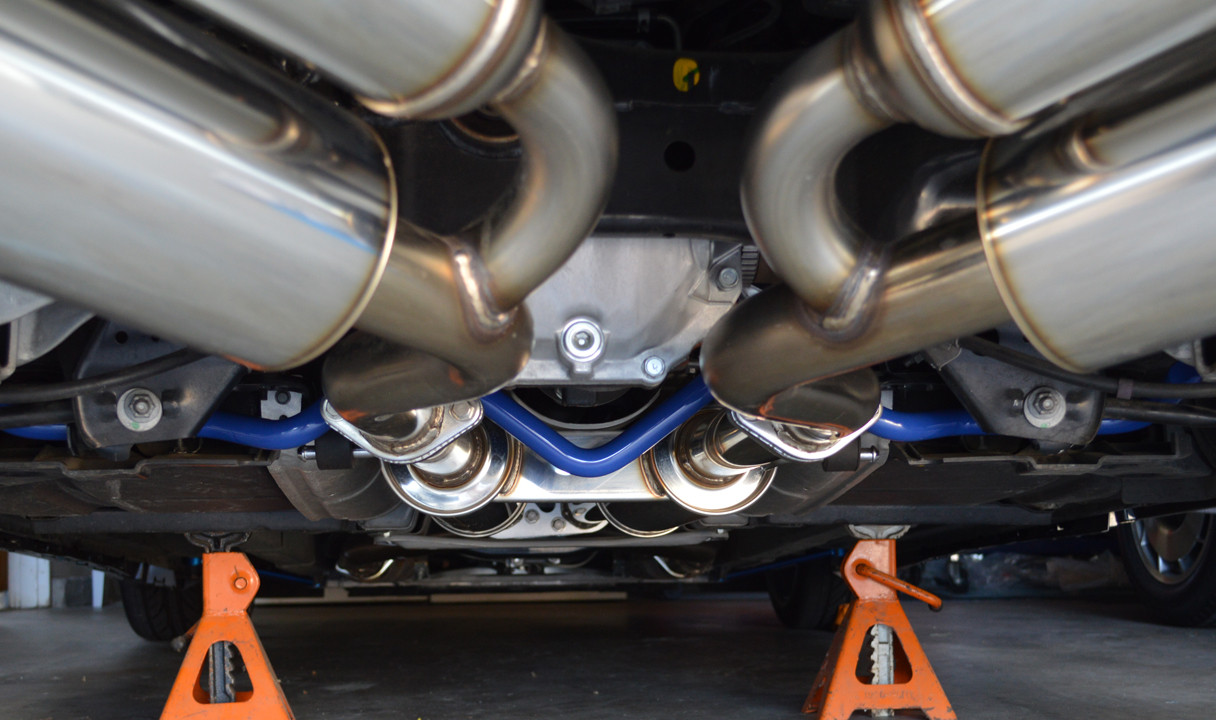

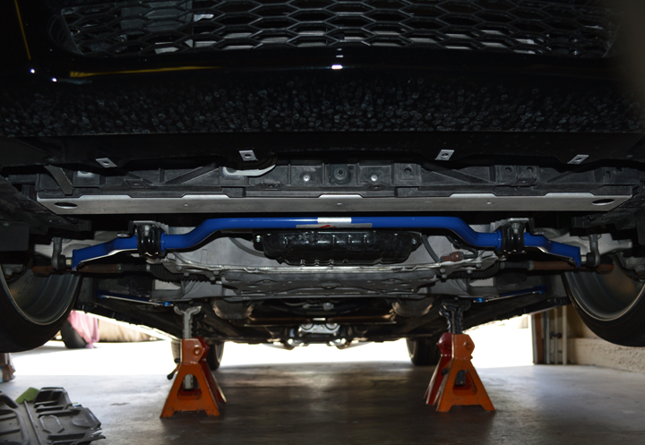

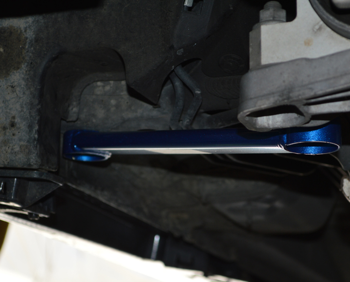

Last month I finally got around to installing the rest of my suspension components. The Cusco front and rear sway bars with front power brace all went in.
My impressions on the Cusco sway bars are that they made a huge night and day difference in handling! My car feels very planted to the road with very little body roll.
With that said, I didn't do much research before buying the sway bars and picked them up to complete a Cusco suspension package at a great price from Frank at Modbargains, a vendor on the forums. I just knew any sets of sway bars would be an improvement over stock and it would be neat to have all matching Cusco blue suspension parts.
The sway bars are listed at 28mm (hollow) @ 124% stiffness over stock for the front , and 25mm (solid) @ 238% over stock non sport G37. These sway bars offer no adjustability, nor do they use poly bushings. I think this set also cost a bit more than Hotchkis, which gives you adjustability and poly bushings w/ new brackets etc. I can see why most on the forum go with Hotchkis.
Overall, I'm very happy with the Cusco sways and guess there is no need to worry about noise and/or greasing the bushings. I'll always wonder how much more stiff the car can get if I had Hotchkis...or some other set with adjustability.
