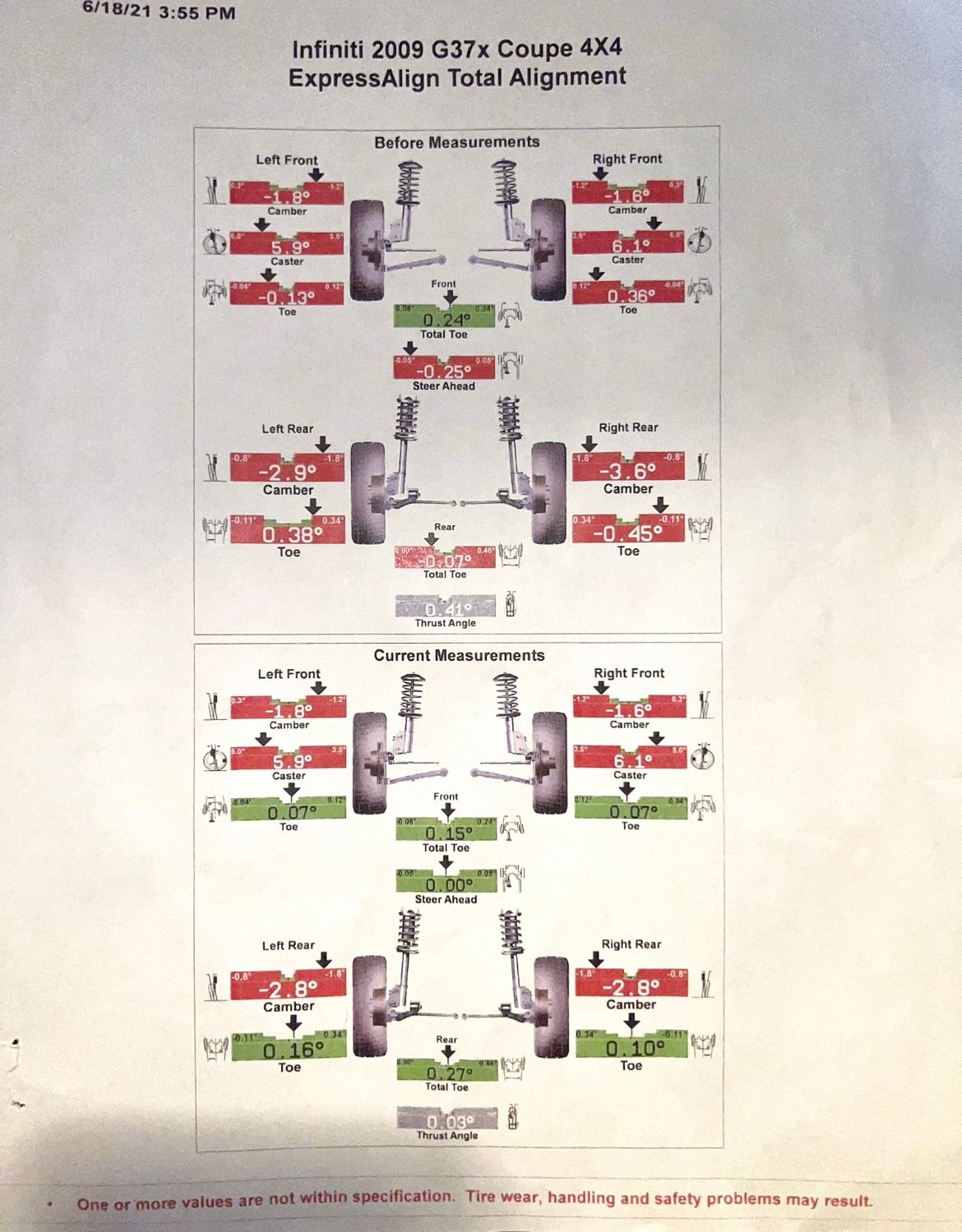

Any chance you have your last alignment sheet? This will help track down the issue.
Start with the oem wheel swap, I usually recommend installs one at a time or at least non conjunctional parts especially in the alignment end of things.
You say you have different offset but then that you are rocking RPF-1s wheels size 18 with a +38 offset. +38 all around or not?
Camber - it's possible that to obtain less tire wear they might have opted for a more positive camber and since the offset might be different it might play a part when it's mixed with AWD plus different offset. I could be wrong.

I’ll have to get my last alignment sheet after work.
I have the same +38 offset for all 4 wheels.
the noises honestly do sound like they are coming from the control arms, they make noises over bumps and turns, especially when reversing and turning. Installing the OEM wheels will be a bit of a problem since I need tires for them. If it’s the control arms causing the bad handling, what would be my next move? To replace them? I’ll definitely try and grease up all the bushings to get rid of the noise.

sorry that took so long, here is my last alignment sheet

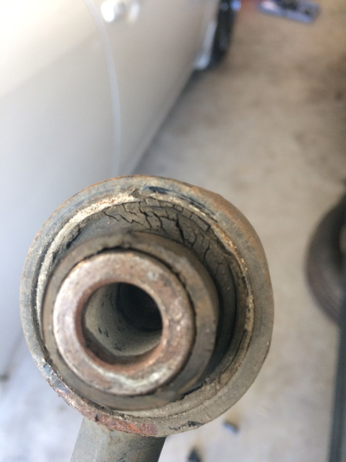

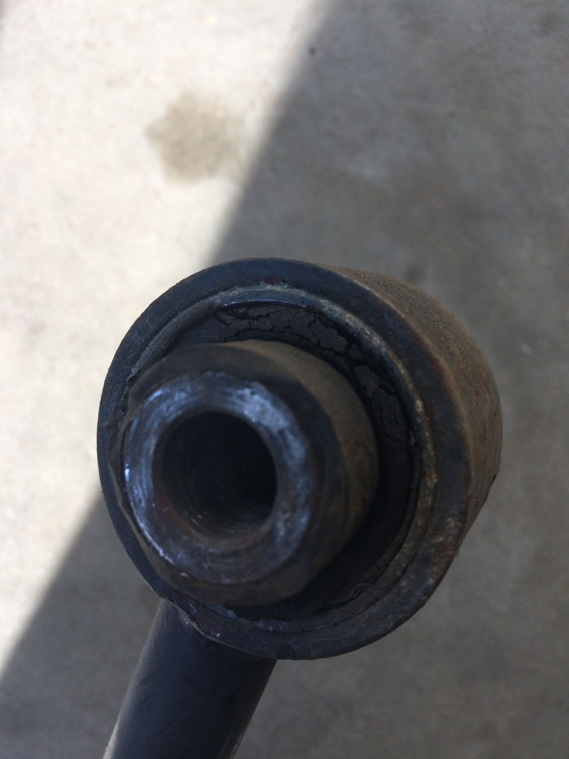

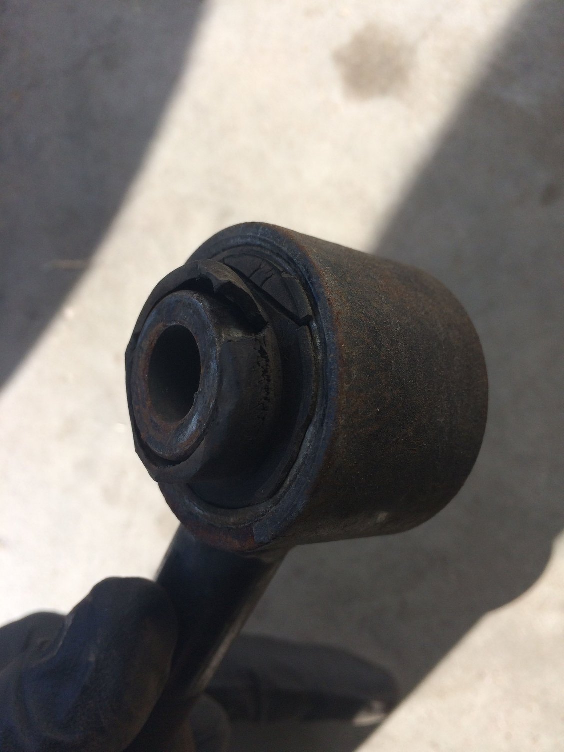

So, I had a very similar issue after installing my fortune auto coil overs. Same deal, car would basically 'wag' its tail. Used cheap, completely adjustable, control arms to get the job done and alignment completed. Figured I'd replace the following year. Here was my cheap suspension bits after less than 2k miles:
Pop off the control arms and take a look at the bushings. Mine felt solid as well but when the load of the car moves left and right there's a whole lot of play inside those bushings if they're jacked up like the pics above.

Yup, those are what are featured above. Visually, they looked fine. Wasn't until I popped them off and saw the bushings until I realized that was my problem. Threw the OEM ones back on, got a re-alignment and no more swaying/wiggling.
