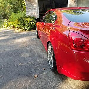

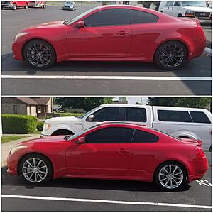

Here's the car. I put pics in the wheel thread too. I'll post the full alignment sheet tonight. I'm thinking of making my own spacers if I can find a drop of 6" bar stock. Then I won't need to use the centering rings that came w/ the wheels. We have a machine shop at work. The rear could use a 5-10 mm spacer, the front is pretty flush.
2008 G37s 6mt
Forgestar F14 18x9.5 + 35
265/40/18
Tein Street Basis coils
No spacers (yet)

Oh yeah, very nice. I didn't realize the 18" F14 would fit over those brakes, that's awesome. What a great OEM-ish look, reasonably priced and very lightweight for cast wheels.
If anything at all, the rears look like they could come out a little more flush, but you're on top of the situation already.
Well done!

Nice! Looks like you've got it down. Also looks like you could also run a bit wider (275/40R18 - same height as OEM tires) in the future if you'd like. I was looking at a set of the 18x10s of these myself. They look good.
