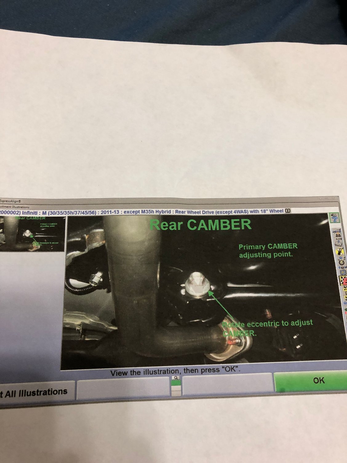

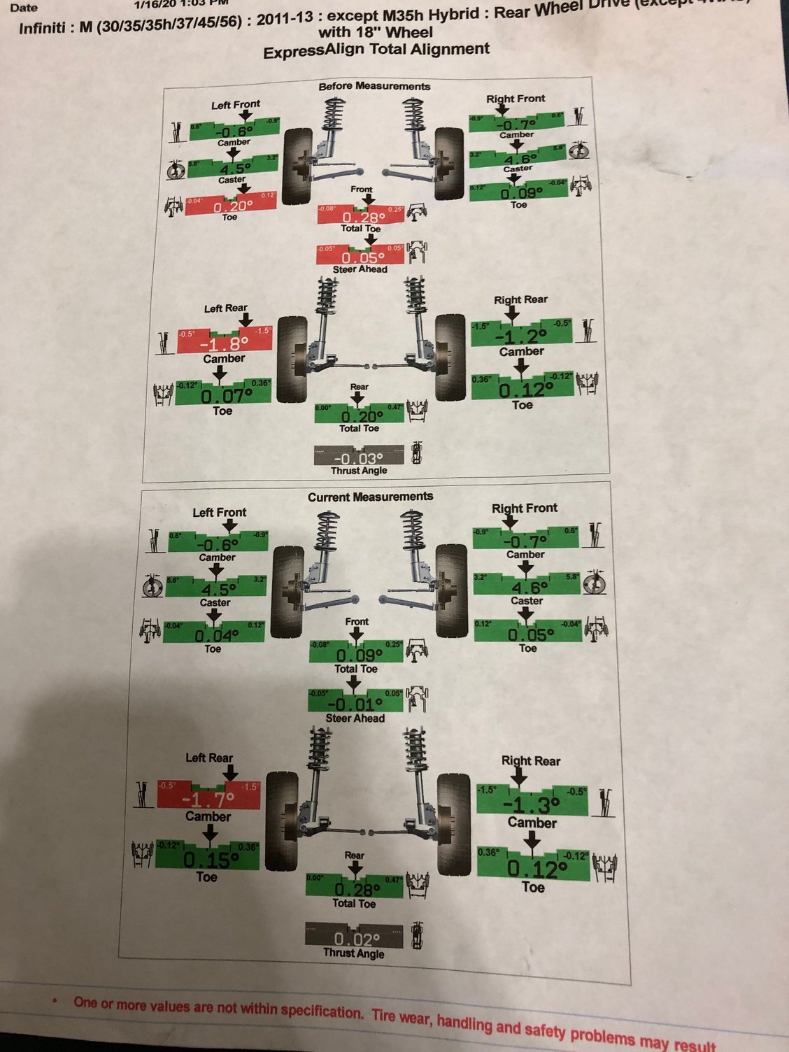

last week I went to get my tires rotated and they showed me my tires were getting worn down again and I needed new tires. So i went and bought new tires and today got a alignment. They said I need a new camber kit because they couldn’t adjust anymore on my rear left side. I will attach the pictures they left me with. My suspension is totally stock with stock rims. Question is, do I need to get a new camber kit or will it be ok? I do have lifetime alignment warranty from brake check. Any help is appreciated!

Two things. You want less toe-in in the rear, no more than 2°. Regarding camber, have them match the right side to the left. That's in no way excessive camber. I run -2° front and rear with no issue.

If anything you can get some SPC rear camber kit and toe bolt, it isn’t too expensive and you can make offers on eBay and get them a bit cheaper.
