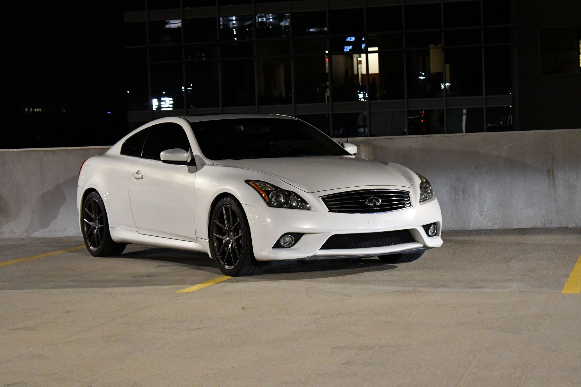

I have Swift 4N911 on my 14 Q60 AWD. When I first lowered it, it didn't look "low enough" to me. It has since settled and looks exactly the way I wanted it.
We have pretty bad winters here and very bad roads, but my car is a beast with DWS06 tires and the car isn't too low.
BTW I can go over speed bumps same speed as before. Not sure if that's apply to your exhaust setup.

I have swift on my G37xS and at times I would scrape my catalytic converters but only a few times varying on the speed bump. If it just a regular one it ain’t a problem, but some of these plazas be having mount Everest speed bumps which scrapes unless I go at an angle. As far as the camber arms, it various. Someone needed them but some didn’t, but I got front and rear camber arms. As far as the ride quality it’s about the same, it’s just when you hit bumps you feel it a bit more than stock. It also handles a lot better when taking corners, and less body roll.
Thank you! My car is also white so this gives me a better view/idea of what it would look like. Are you on 19” or 20”?

Rim set up is 19x8.5 offset of 35. Tire set up is 245/40/19 all around. Like takemorepills said the car also does wonder around the road a bit, specially when it is not a perfect surface, but if you go under the car and look at your power steering from the driver side, you will notice a bolt on it, and i recently tightened it a bit and it did make the steering a bit heavy but not much, and it doesn't wonder around as much as it did before. By the way I would highly recommend getting the springs from ebay, you can always make counter offers and get them a bit cheaper that is what I did, also did the same for the front and rear camber arms.
