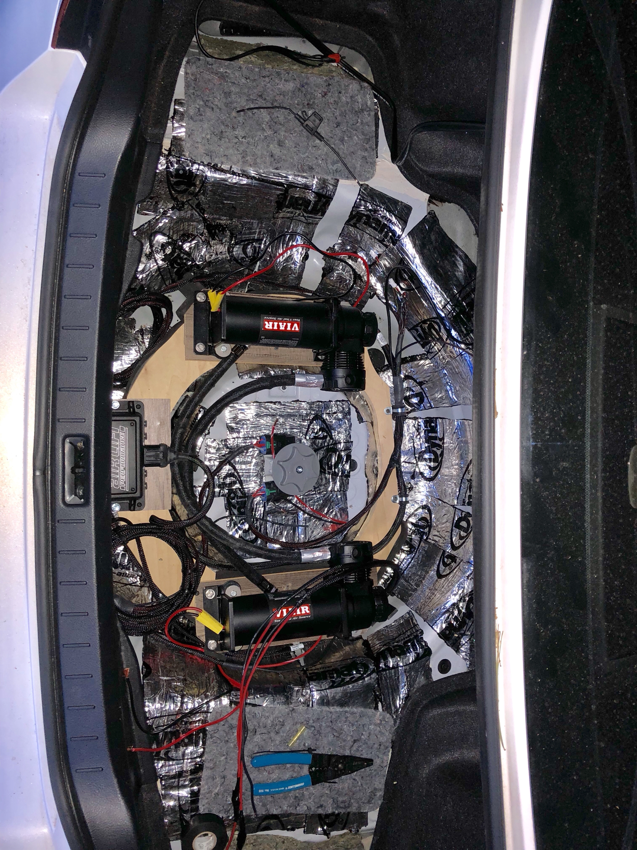

what size gallon tank are you getting? the compressors are what make the noise not the tank tho. I have Dual Viair 444C Compressors with compressor silencers and it's not bad on the noise. If you are listening to music you'll hardly hear it, it's like a quiet hum in the background.
I have a simple setup. my tank is 4 gallons and I put a pic below, since you have a sedan you should have more space than me.

Thank you for the reply. I was thinking of running with a 5 gallon tank to hopefully increase the time that the compressors off. I always have music on so if it is just a hum in the background it should work for me. I do like how minimal your setup is, I was thinking of running something similar with a dual compressor setup but hoping to mount the compressors over the tank.

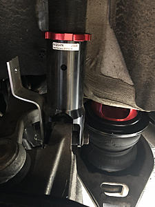

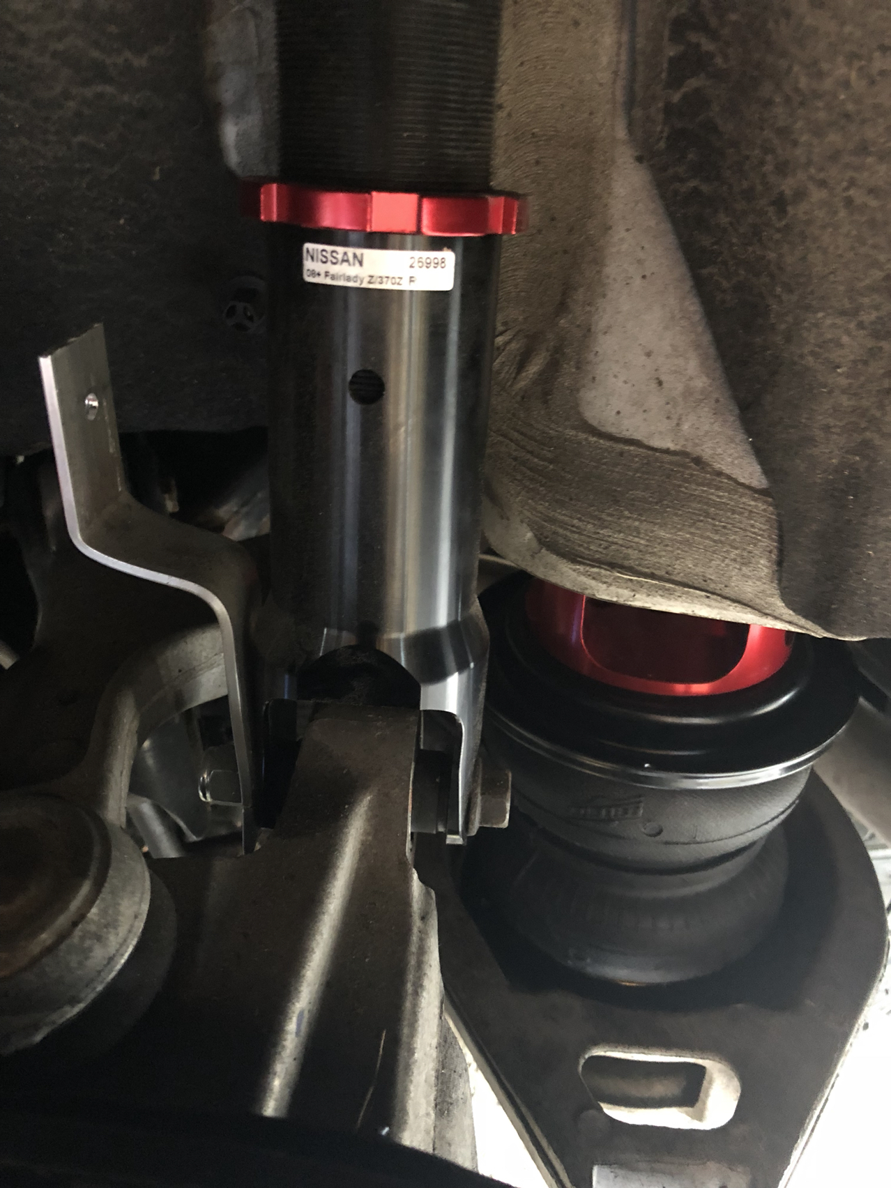

Currently installing air ride right now (by myself) figured I'm too OCD to rely on a shop to get the job done to my standards.
Anyways, I went with the endo-t5 which is the 5 gallon tank only. I could always upgrade to the CTV if I wanted to but I just liked the look of the tank and the engineering.
Went with airlift 3P+H - height sensors aren't bad to install. I thought they would be but I think I got them in right.
I made brackets for the height sensors so I didn't have to drill into the suspension in the back. Haven't done the fronts yet.

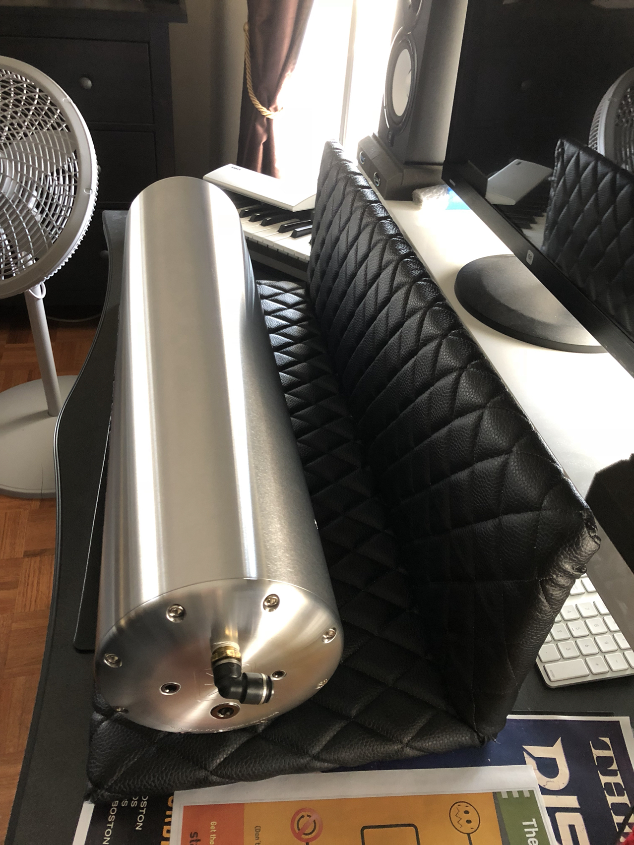

This is my tank setup, built this out of some wood and some diamond stitch leather.Air suspension help-photo616.jpg
