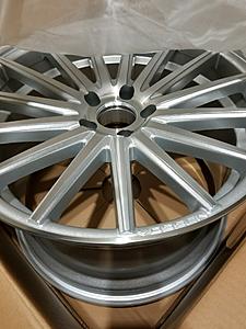

Hi guys new to the forum and new to the aftermarket wheel world. I just recently purchased a set of vossen VFS2 on impulse buy and need some help
Front 19x9.5 +25
Rear 19×11 +45
Car Stock
2012 G37 Sedan non sport RWD
I was told 235/40 in the front and 275/35 in the rears would work
I'm reaching out to see if anyone knows of a setup/mods that will make these rims look good/flush with my g37 sedan without sacrificing quality ride or handling or if I should consider returning them for different sizes. Any advice also appreciated thank you.
Attached Thumbnails Vossen VFS2 fitment-snapchat-2077940671.jpg   Vossen VFS2 fitment-20171214_181942.jpg
Old Dec 15, 2017 | 08:47 AM
Those wheel specs would work on a coupe, unfortunately they will poke out quite a bit on a sedan and not look proper. If you can return them without taking much of a hit that would be best. I would look for a 9.5 +35 to +40 front and 10.5 +45 rear. With that setup you can run 245/40/19 front 275/35/19 rear.
