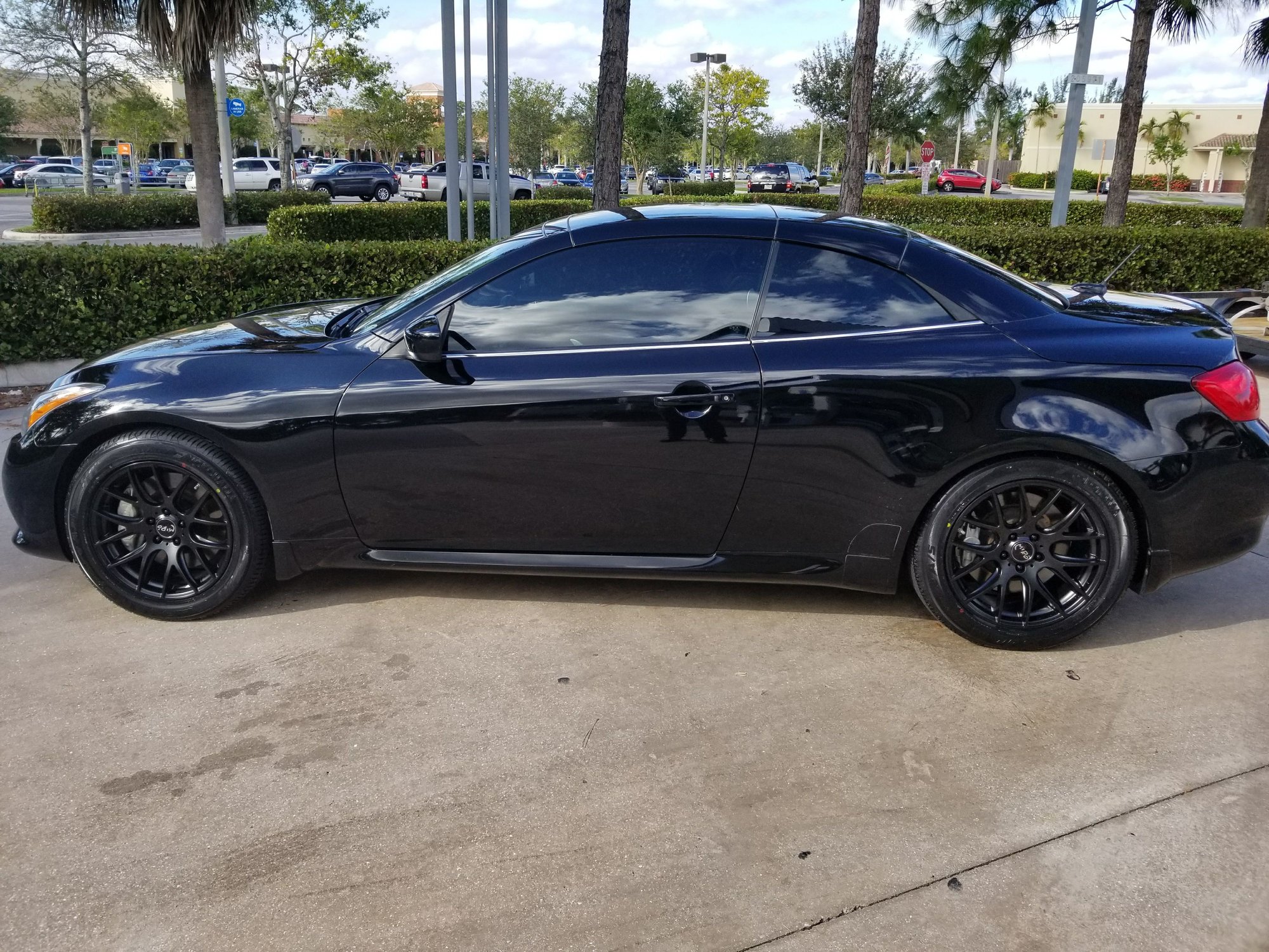

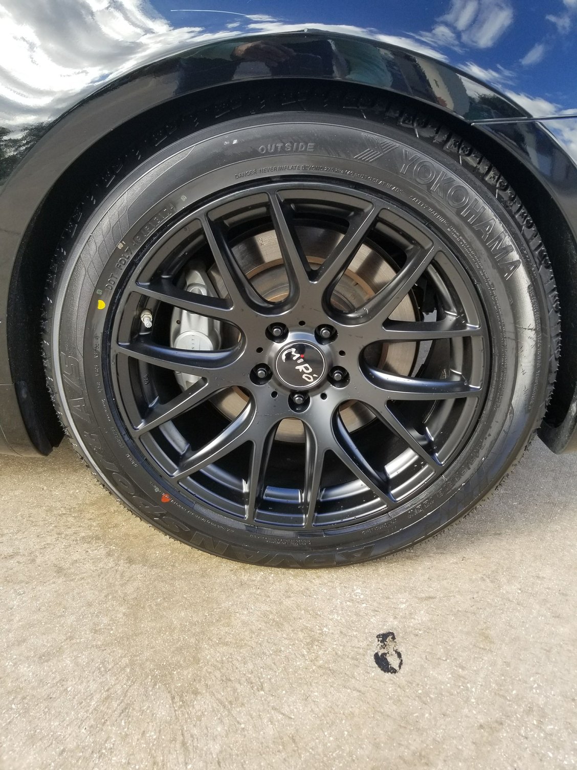

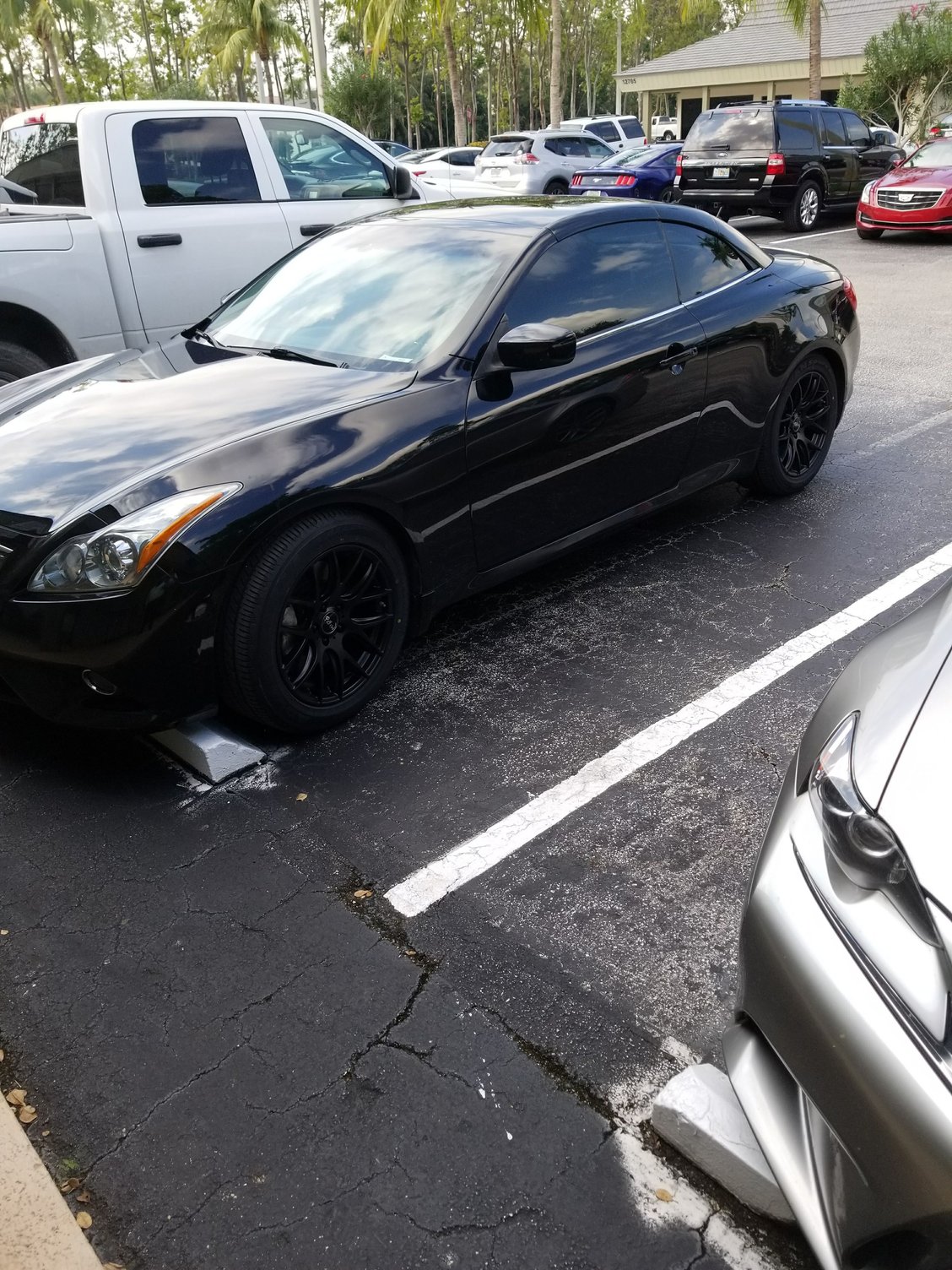

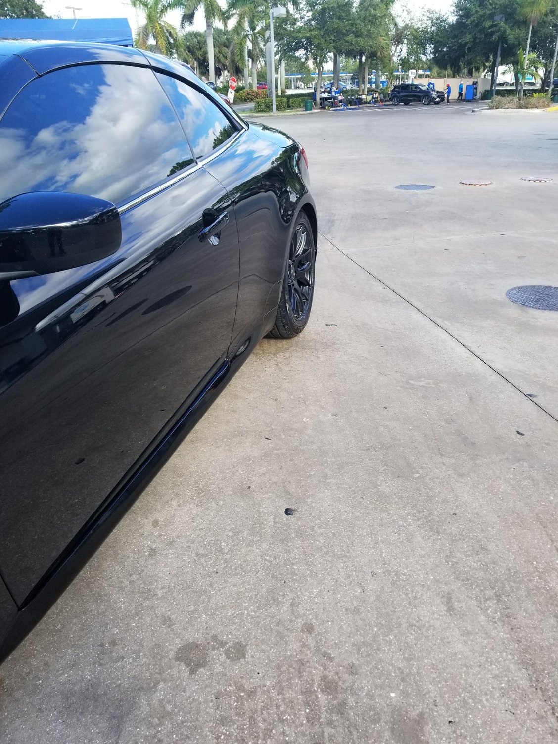

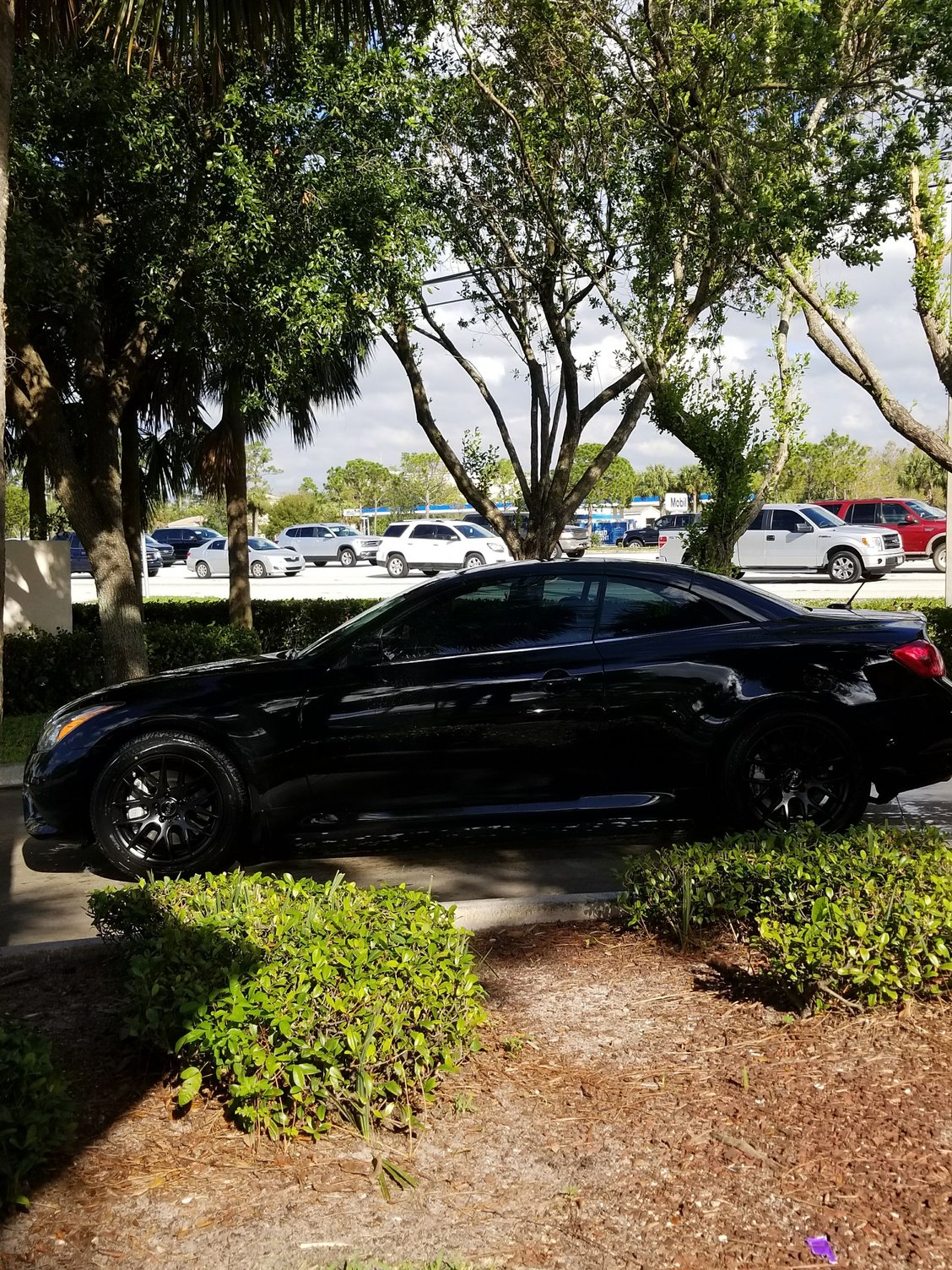

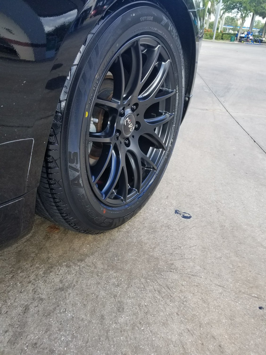

Front
Rear
Rear
Old Nov 24, 2017 | 03:33 PM
  #21
G37svert2013's Avatar
G37svert2013
Joined: Sep 2017
Posts: 31
This is with a 10mm spacer on the front, the 5mm was enough to clear but only left about 1mm between the caliper, and I was very skeptical of that clearance. I may try a 7mm just to pull it back in a little bit. Also, with the 5mm spacer I could only get about 5.5 turns of the lug nut, so the front has ARP 100-7729 studs.
The rear has no spacer, and obviously needs one, just because it seems sunken in. I assume I will have the same issue with # of turns with rear lugs if I try the 5mm spacer on the back, and don't feel like paying to have the back studs changed right now. I had already bought a bolt-on 15mm spacer for the back, but I think that will be too much, and I don't necessarily trust that type as much as doing the extended lugs with regular spacer.
Miro type 111 18" D 8.5" W with 35mm offset. Yokohama Advan Sport A/S 245/50/18 square.
