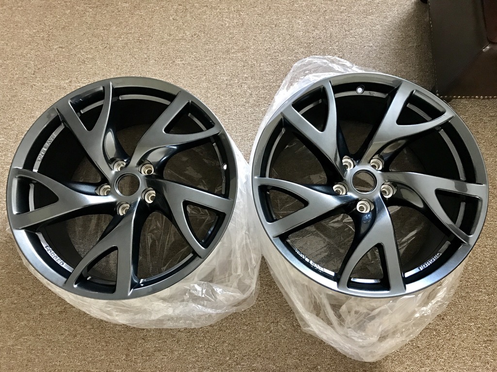

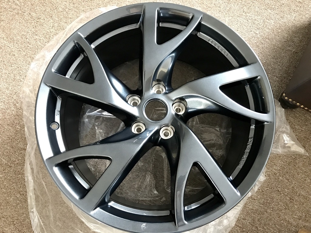

Never, I mean selling when the lease is over. Man the quality on the Rays forged is sooo on point!
Soo sexxyyyyy
