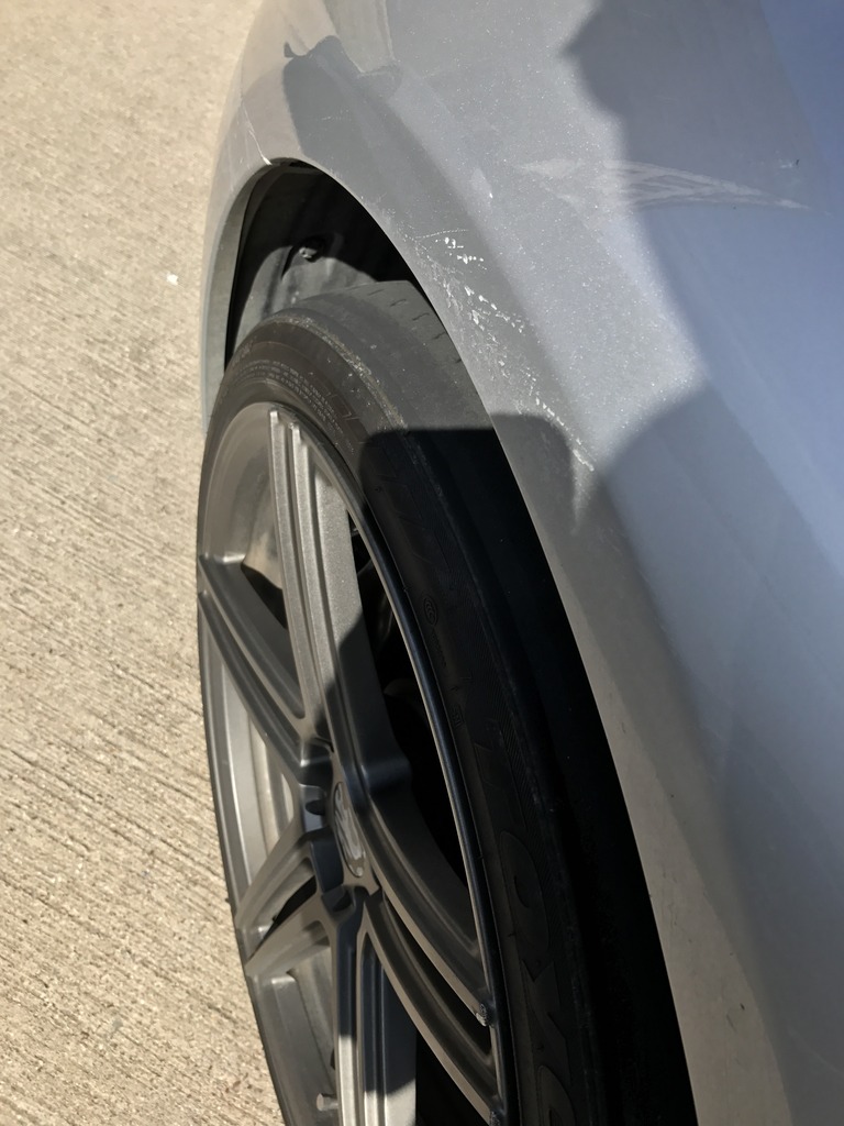

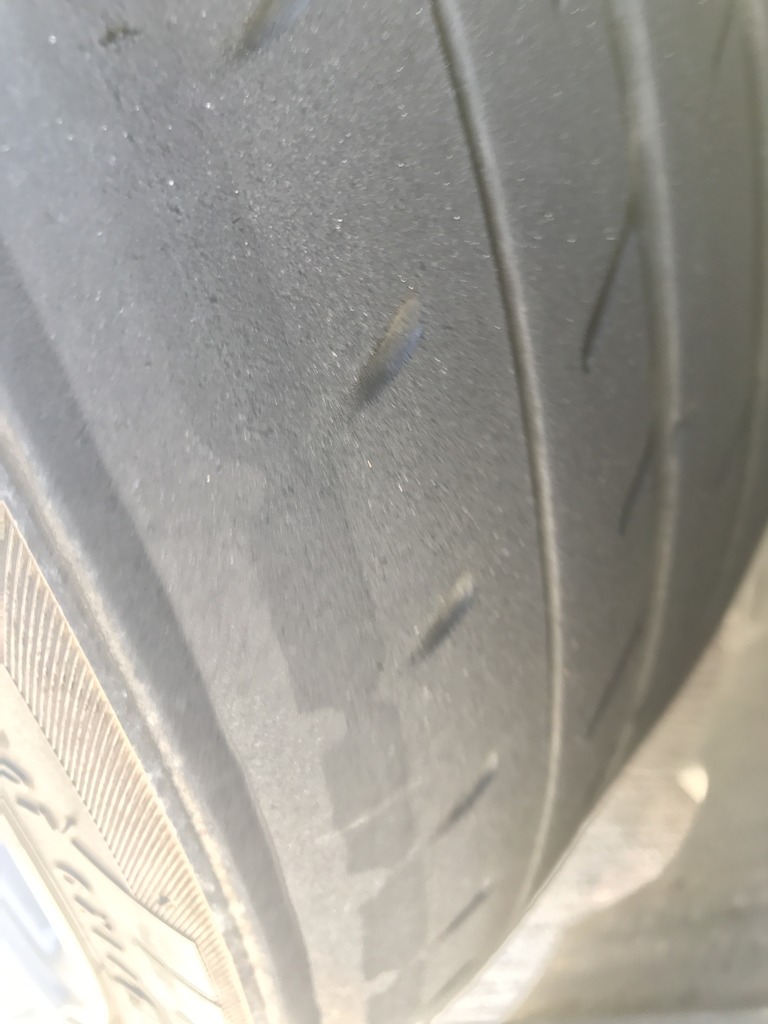

As the title says, I'm getting outer tire wear on the front only. Do I need a front camber kit? Wheel specs are on the from 8.5 +35 with a 20 inch diameter

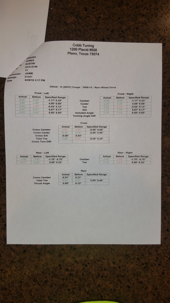

My alignment done about 9 months ago.

Yeah, but these are the first set of tires I've had on the wheels. I bought the car with the wheels already on it. I am staggered wheels (width of course) rears are 10 inch wide. Tires are indeed directional, Toyo T1 sport.
To be completely fair, my alignment was way out of wack when first getting these tires put on, but the outer tread has gone from decent to what you see in the pic in a matter of months. Idk could be because of my alignment previously being off. Just wondering if this is a common occurrence with 20 inch wheels.

to me it looks like you have positive camber on that front left. usually it happens on the inside of the tire after lowering your car. do you have any suspension mods? you will prob need to get that tire replaced. it also looks like the alignment was done last june. have you gotten an alignment done since? on my g37 and my old G35 the alignment almost never stays in spec for very long. i get my alignment done almost every 2 months.

Yep, something is amiss here. That heavy outer wear in front looks like heavy negative camber or your toe is out quite a bit there.
That spec sheet you posted won't cause that kind of wear. I would get it rechecked and if possible getting that front camber balanced to a -0.6 on both sides would be preferred. Based on that spec sheet you shouldn't see ANY excessive wear along the tread block.
