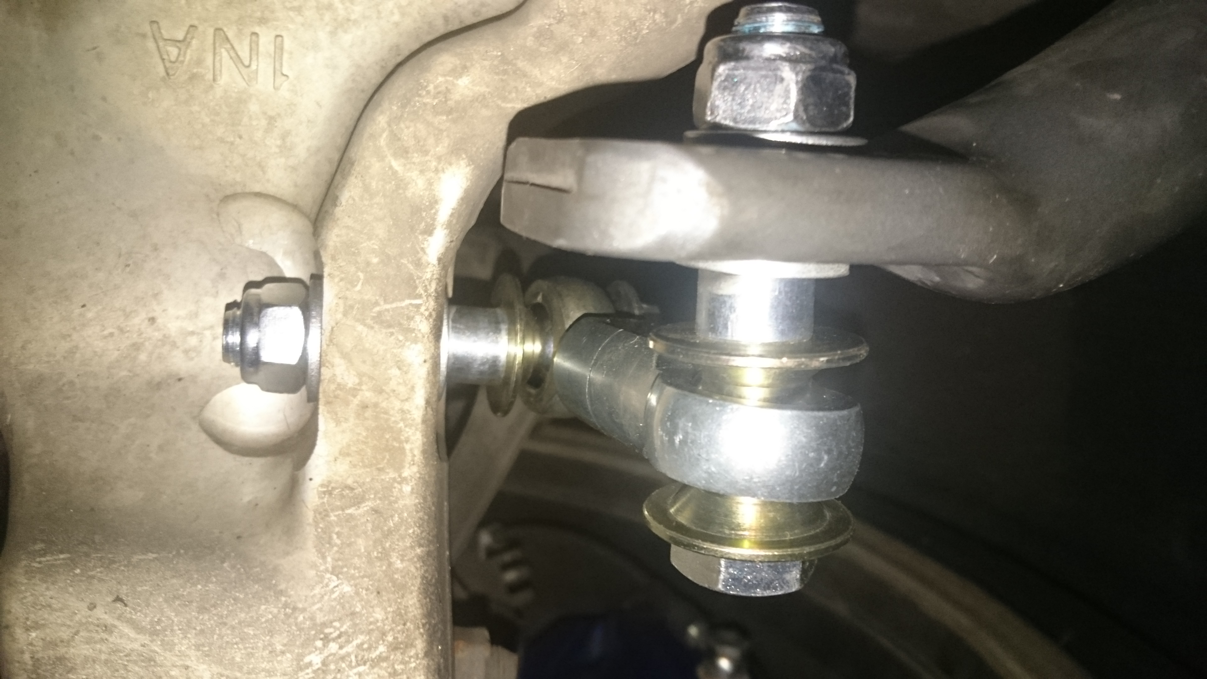

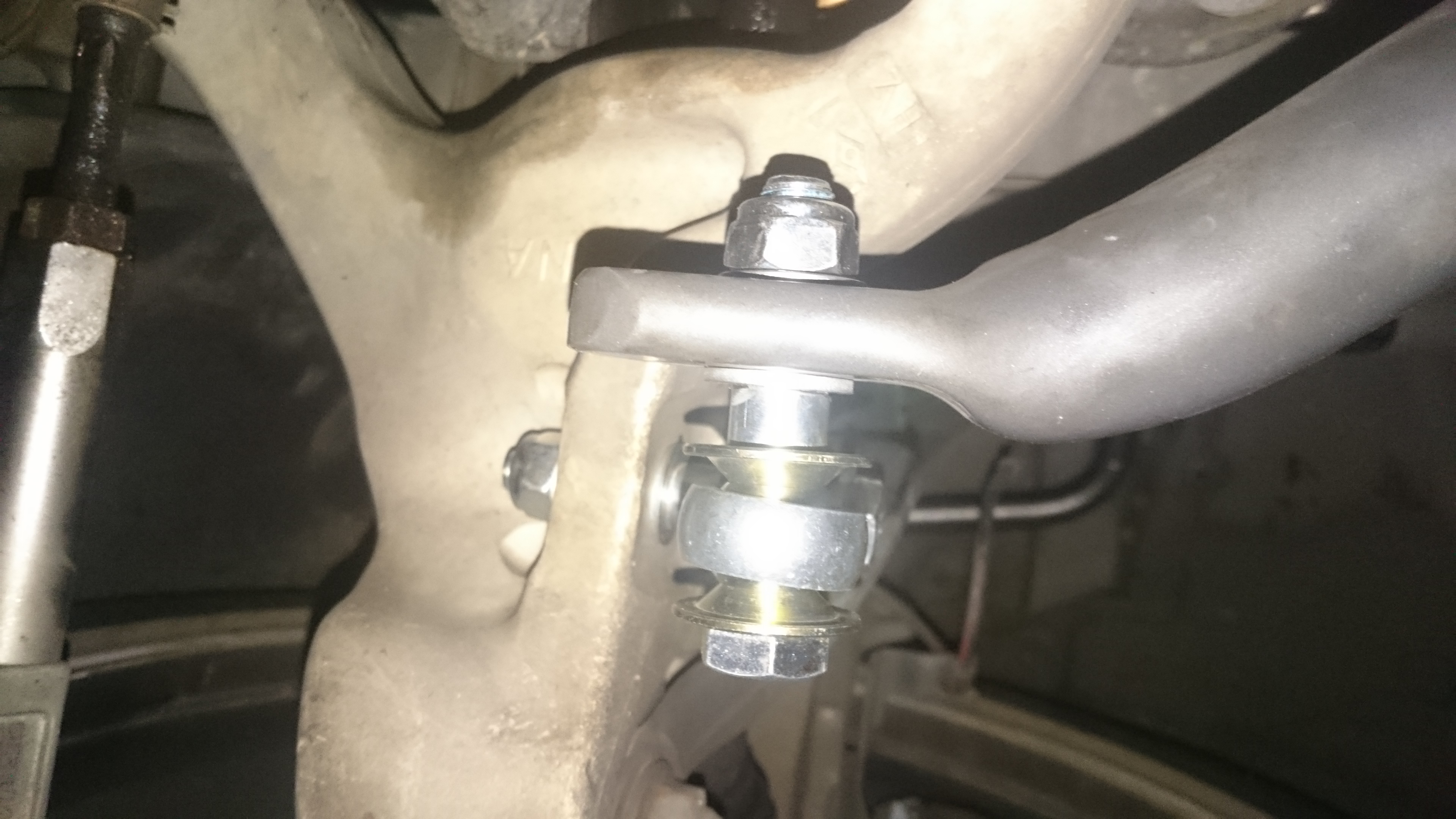

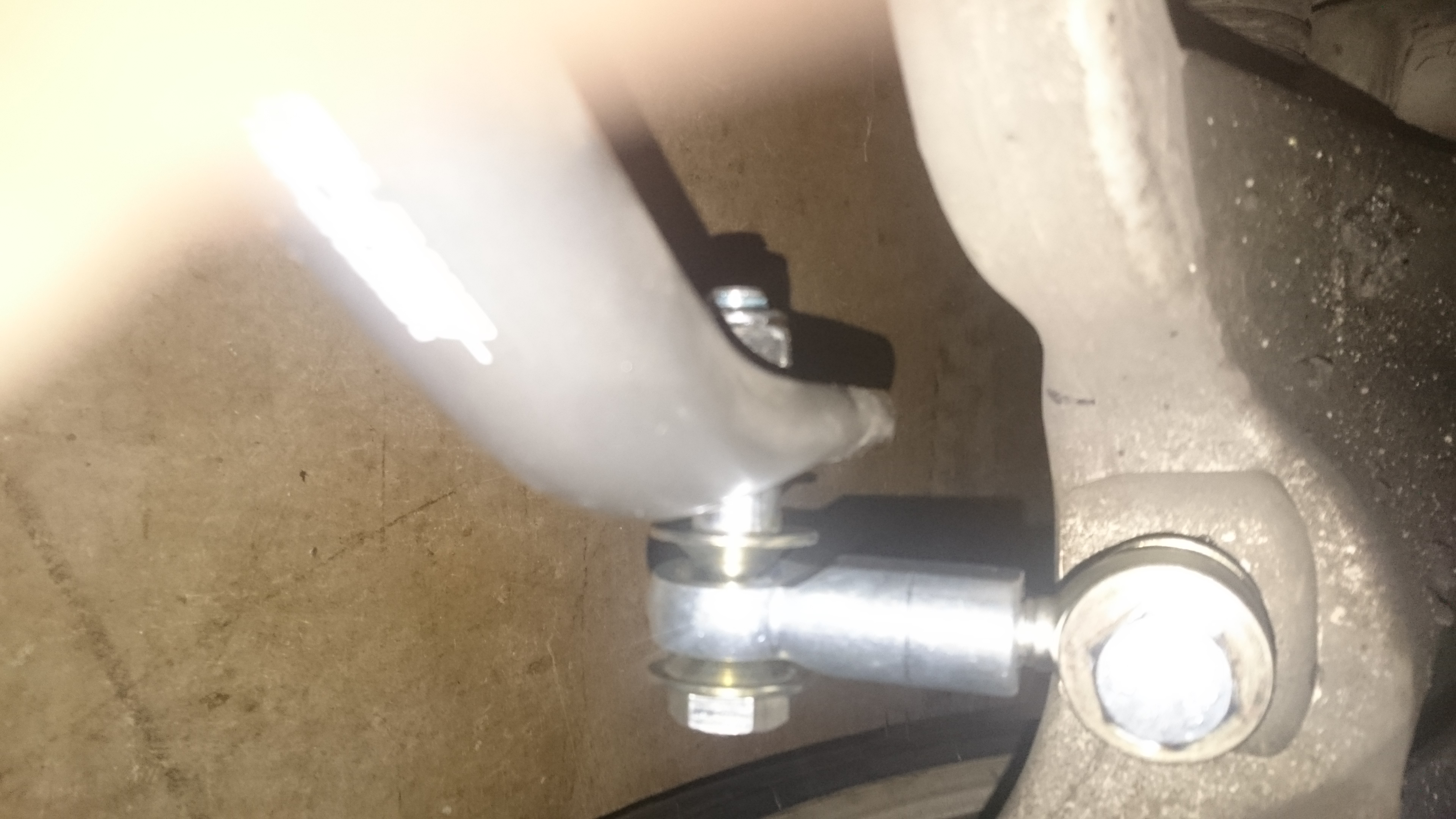

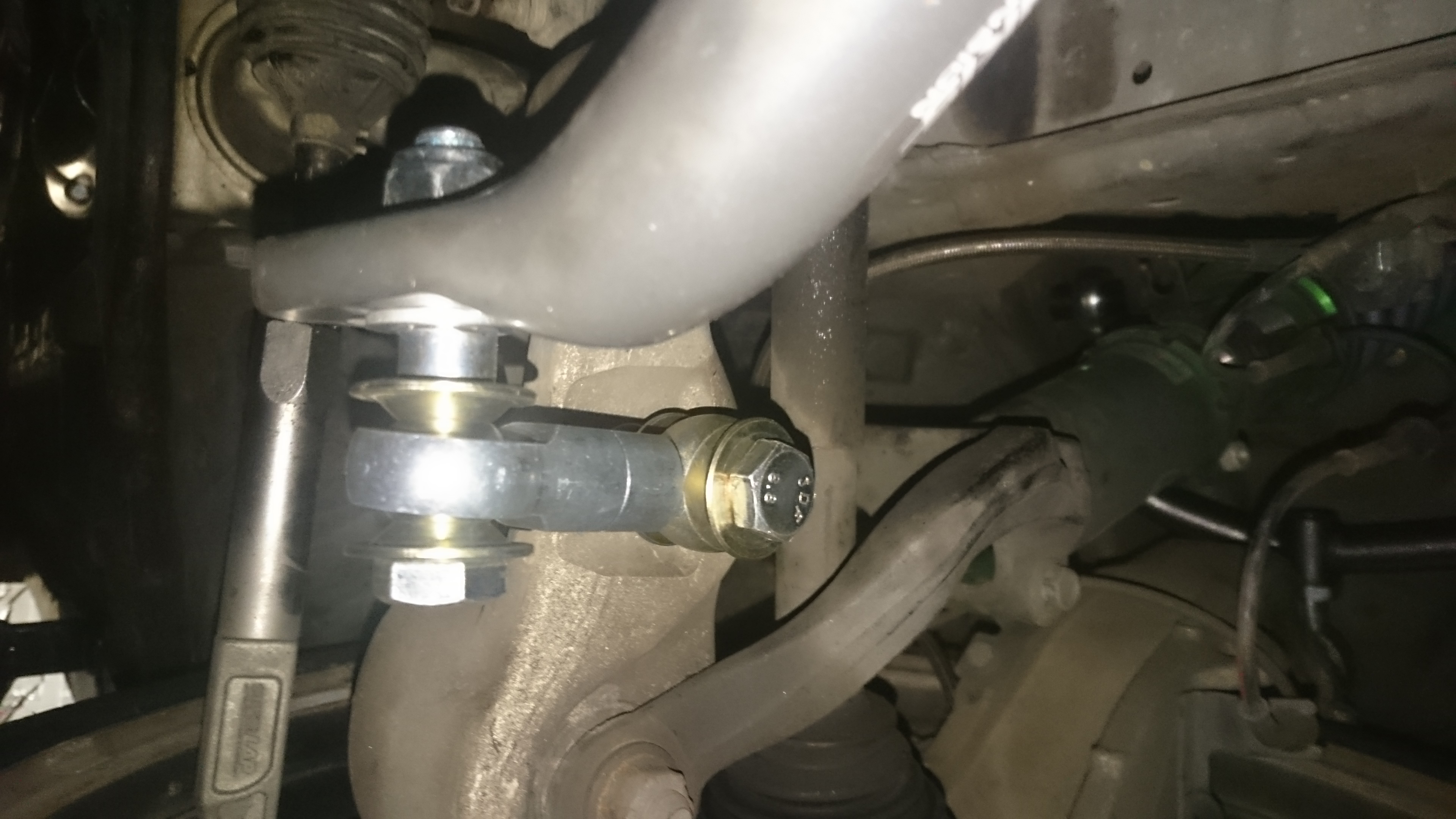

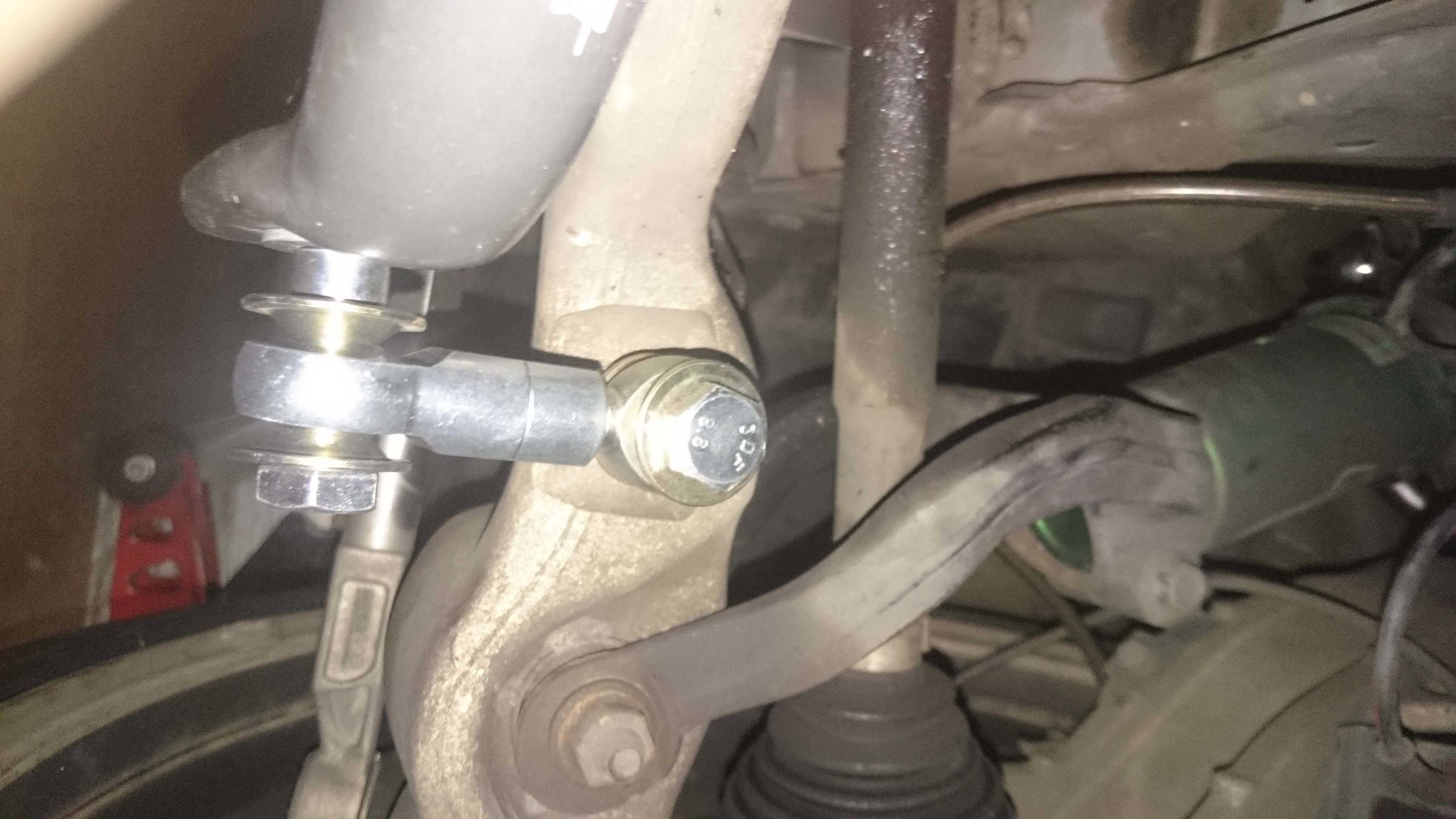

Back on subject: I sourced out some pretty stout end links and components to make my own front end links and here are the results:
.JPG)
.JPG)
.JPG)
.JPG)
.JPG)
The shopping list for this project is as follows per link:
- Metric rod end retaining washers, 12mm x4 (#3068-M12) from Pegasus racing
- QA1-MXMR12 rod end x1
- QA1-MXFR12 rod end x1
- M12-1.25 x 70 Hex cap bolt, grade 8.8 or better x1
- M12-1.25 x 80 Hex cap bolt, grade 8.8 or better x1
- 12mm flat washers x4
- M12-1.25 nylon lock nut x2
- 12mm jam nut x1 (optional)
- At least 30mm of 12mm ID SS spacer tubing (will need a 15mm section and a 12mm section)
I bought these parts from a few different places, trying to keep price down and purchased enough for two end links. In the end I spent about $90 on the parts for the links.
For the spacers you need to cut a 15mm spacer for the up top (mount to the control arm) bolt and a 12mm spacer for the sway bar mounting bolt. Are the rod end failure washers required, no, but it gives me piece of mind.
I ended up just using one link and keeping the stock on the passenger side because I only needed to trim about 6mm off the male rod end threads to get the perfect length. Any more and I would have needed to shorten the female rod end, and honestly at that point I would have just opted to replace both sides to have full adjustability.
If you are a good DIY type of person, have the tools and time and own a X that you want to remove the preload off the front sway then I recommend this for you.
