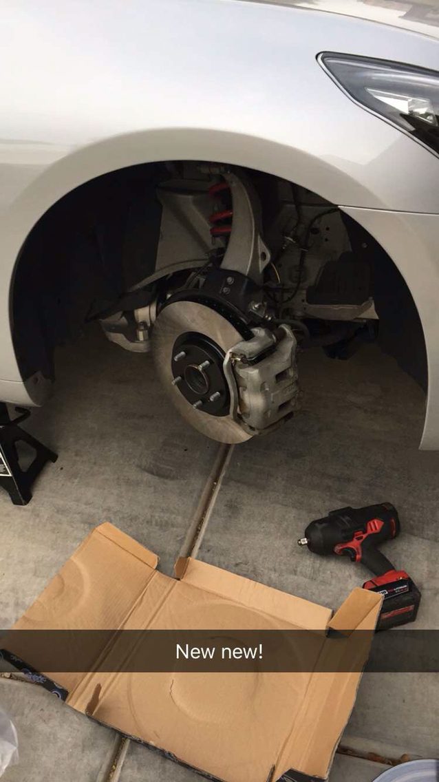

Had my mechanic install the centric premium rotors today! Haven't driven it yet but they seem to look more functional than the oem ones? Do they req break in? If so what the beak in process
No break in w/ rotors but your pads may need to be bedded in again depending on what compound you're running.

From: Tempe,AZ
Thank you my break pads didn't need replacing I had 9mm still left and they are oem. So far the breaks feel good

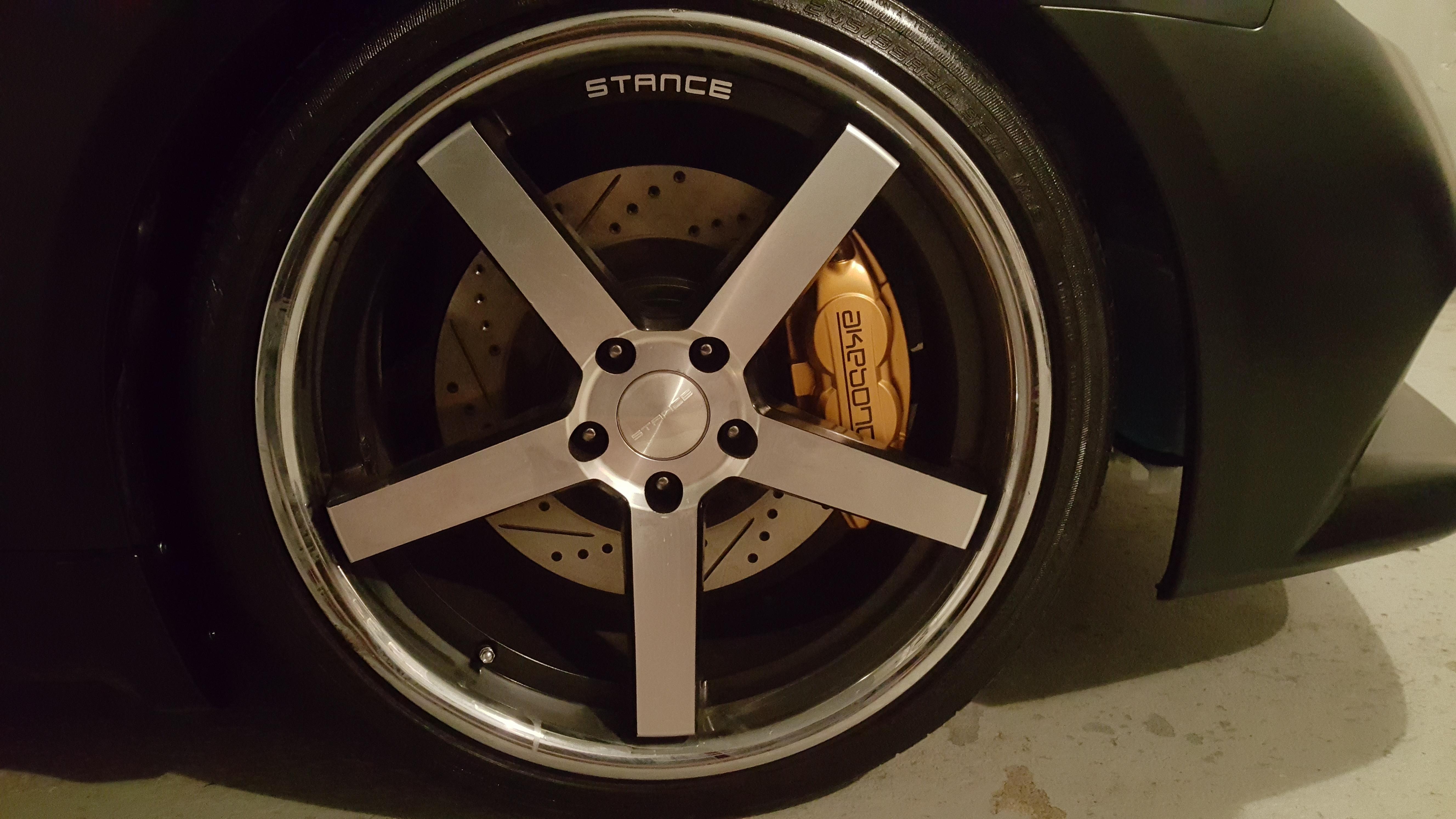

I have been riding on the stoptech slotted drilled rotors with Duralast ceramic brake pads for about a week now and I must say I can definitely feel the difference. I am extremely happy with my purchase!
Nice that's good to hear!
