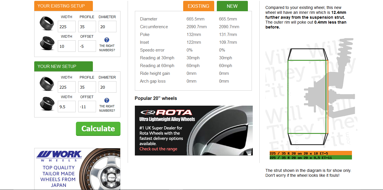

aggressive coupe front fitment on air suspension
So I am trying to fit the following specs on air in the front without doing any fender pulling or having to install camber arms.
specs: 20" 9.5 -11 with 225/35 hankook evo2 tires
It has been done before on a previous G coupe with the equivalent wheel specs but slightly more stretched tire. The specs for that G was: 20" 10 -5 with 225/35 hankook evo2 tires.
I have spoken to this G owner and he said he was running natural camber and did not have any camber arms, but that he doesn't think he would have been able to run any wider of a tire due to clearance issues.
My question is this: I will be running a SLIGHTLY more stretched tire and was wondering how much this picture shows the tire width difference, and if I have to worry about this being too much wider to clear. This picture shows the same size tire on a half inch smaller wheel, so that's about a 6mm less stretch on each side of the wheel (outer half and inner half). So I am trying to figure out if 6mm is enough to make me get camber arms.
weird question I know but I figured maybe someone had some insight.
