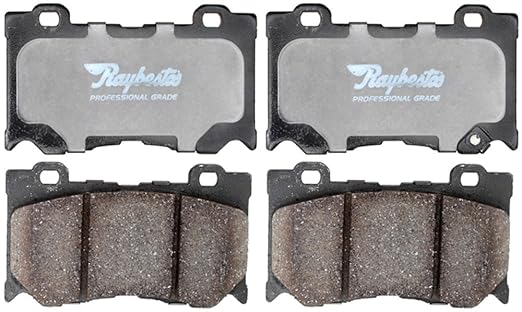

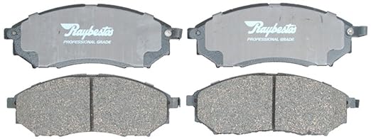

HTHs & welcome to the site!
1)330mm Without Sport Brake package
2)Brembo Brakes
3) What I believe to be for mine:
I'm assuming number 1 is for the ATE Calipers?
Still not sure about the ATE calipers but the top pic is RWD & AWD coupe pads (330/330mm F&R rotors), Prio to 2010 the AWD Coupe had 320/307 combo.
The 2nd pic is the big Akebono Sport Calipers (350/355mm rotors)
3rd pic is RWD & AWD Sedan rotors (320/307mm rotors).
Your pads are the same as the base & journey (non-sport) RWD sedan, and you are correct it's a 320/307mm setup. The Centric PosiQuiet Ceramics are a good OEM type pad w/ low dusting & longer life. Centric Premium rotors exceed OEM performance and have a nice black e-coating w/ better venting than OEM.
